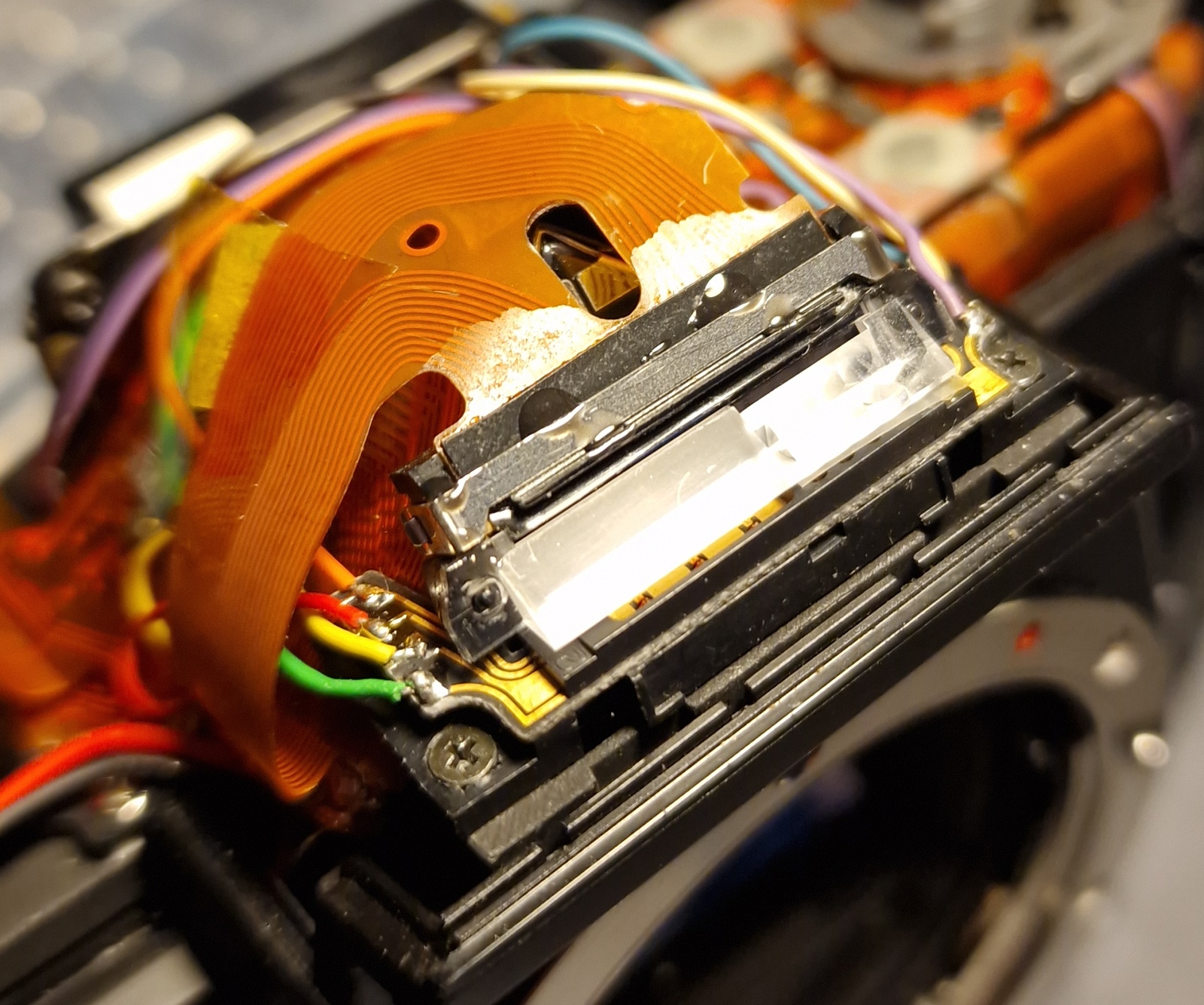

Thanks again for the offer but i've got a spare LCD in the other camera. I was tempted to try swap it out since i kinda half-dissolved the polarizing film with acetone on this first one, but from inside the viewfinder I can't see anything wrong with it since it's on the back side.
Anyways I got it back together and working for now. That was alot of fiddling!
The problem was that the top cover was pressing on that flat flex cable to the LCD, and even small amounts of flexing were breaking the connection with that funny anisotropic conductive tape. I tried alot from adding more thin bits of rubber under that retaining bar, rubber in special places, sliding the rubber up and down on the double sided adhesive, moving the whole LCD unit back and forth, even snipping a corner of that flex cable off so there was less to collide with. I was also considering slitting it up to that hole in the middle to make it less... monolithic... so it could hopefully flex a bit more without tugging, but that felt it was getting a bit too destructive.
In the end what worked was removing the rubber entirely, go figure, but also sticking the cable down to the top of that IC with double sided and then some kapton tape to try anchor it a bit better. Thinking about it now, maybe a blob of epoxy on the bar to really fix things in place so the cable can't move where it's connected would help... which actually come to think of it is what the service manual recommends, I think. Seems extreme and tricky to reverse if it doesn't work, however.
Also, to get the tape off the backing without it stretching so much, peeling it off at a sharp angle like this helped.
Anyways we'll see how long this lasts or if something isn't working that I haven't tested yet. I feel dumb old cameras like this will never be truly solved forever - they're kinda badly designed, cobbled together, and rushed to market to begin with. But hopefully it'll stay working for at least a few months.

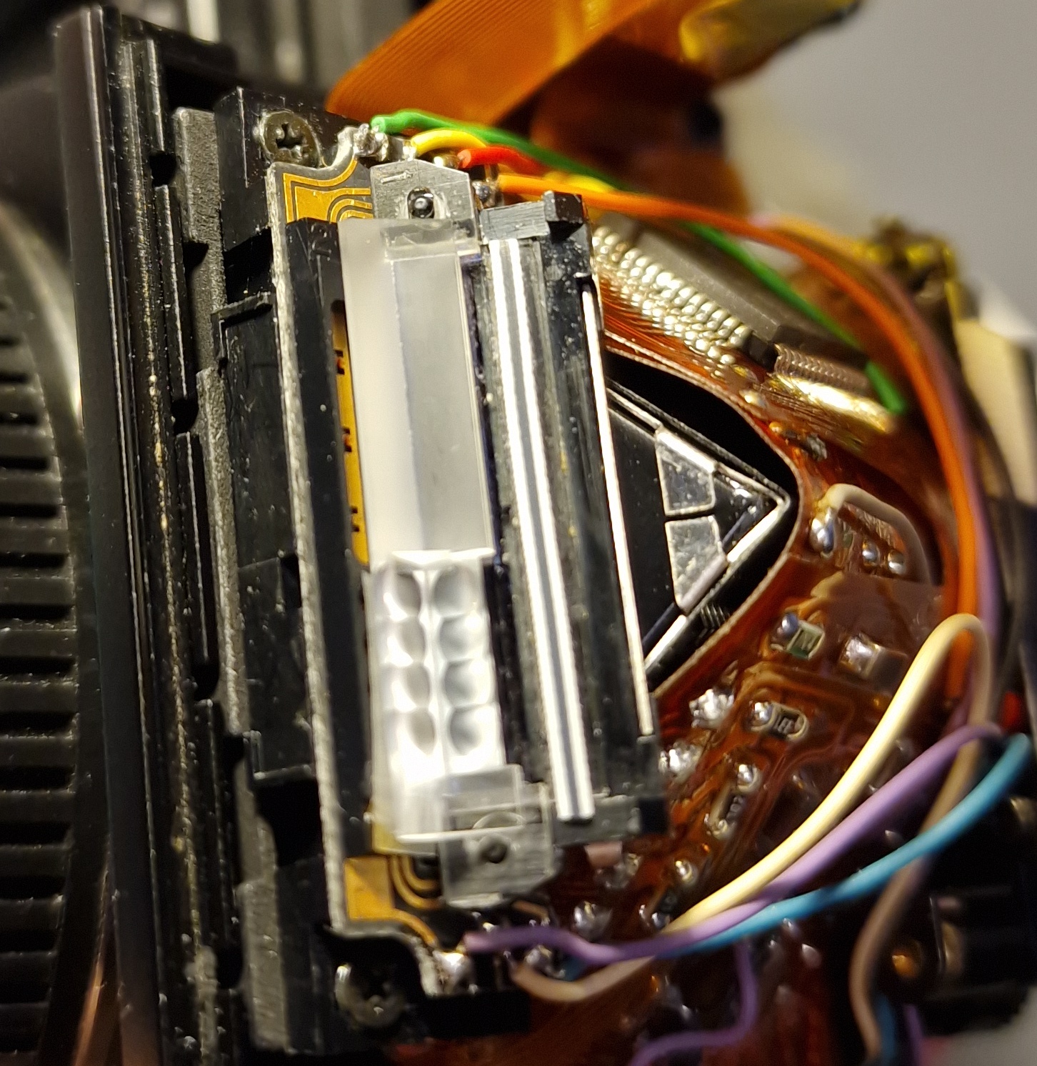

Well that thing worked for a bit but it's just abruptly lost half its segments over the last couple hours while just sitting there. Temperature change or maybe the tape holding down the LCD cable sprung loose? That anisotropic tape is a little disappointing...
So I the options I can think of are:
  • Try re-seat/ compress it till it works then dollop epoxy around to make sure nothing important can move. Seems risky and hard to reverse.
  • Remove the tape and see if the right amount of rubber pads under the pressure bar can get it to sit reliably in contact. It worked the first time around till I disturbed things with the recent repair.
  • Same as above but with epoxy dollops once in place.
  • Cut the whole-ass LCD assembly off, scratch back the kapton over the FFC's traces, do the same with the working LCD module from a donor camera, and solder them together. Quite extreme and I suspect nudging around the donor LCD while doing this would probably break it's old brittle heat seal connection.

Is it possible that the contacts on which the conductive rubber rests are contaminated or corroded?
I had observed the latter with the Nikon F3, but the digits disappeared gradually and not suddenly, like with your 9000.

I doubt it. I think it's just the way that anisotropic conductive tape works where whatever connections are forming are quite fragile, the datasheet recommends mechanical support of the bond, and unfortunately the way this camera is designed both puts changing strains on the connecting cable and doesn't retain it super securely. Which is possibly the cause of the original failure and why the service manual suggests putting epoxy on stuff as part of the repair.

In the case of this LCD the repair steps involve adding a new part, that 'elastic conductor,' to replace the old heat-set conductive adhesive.

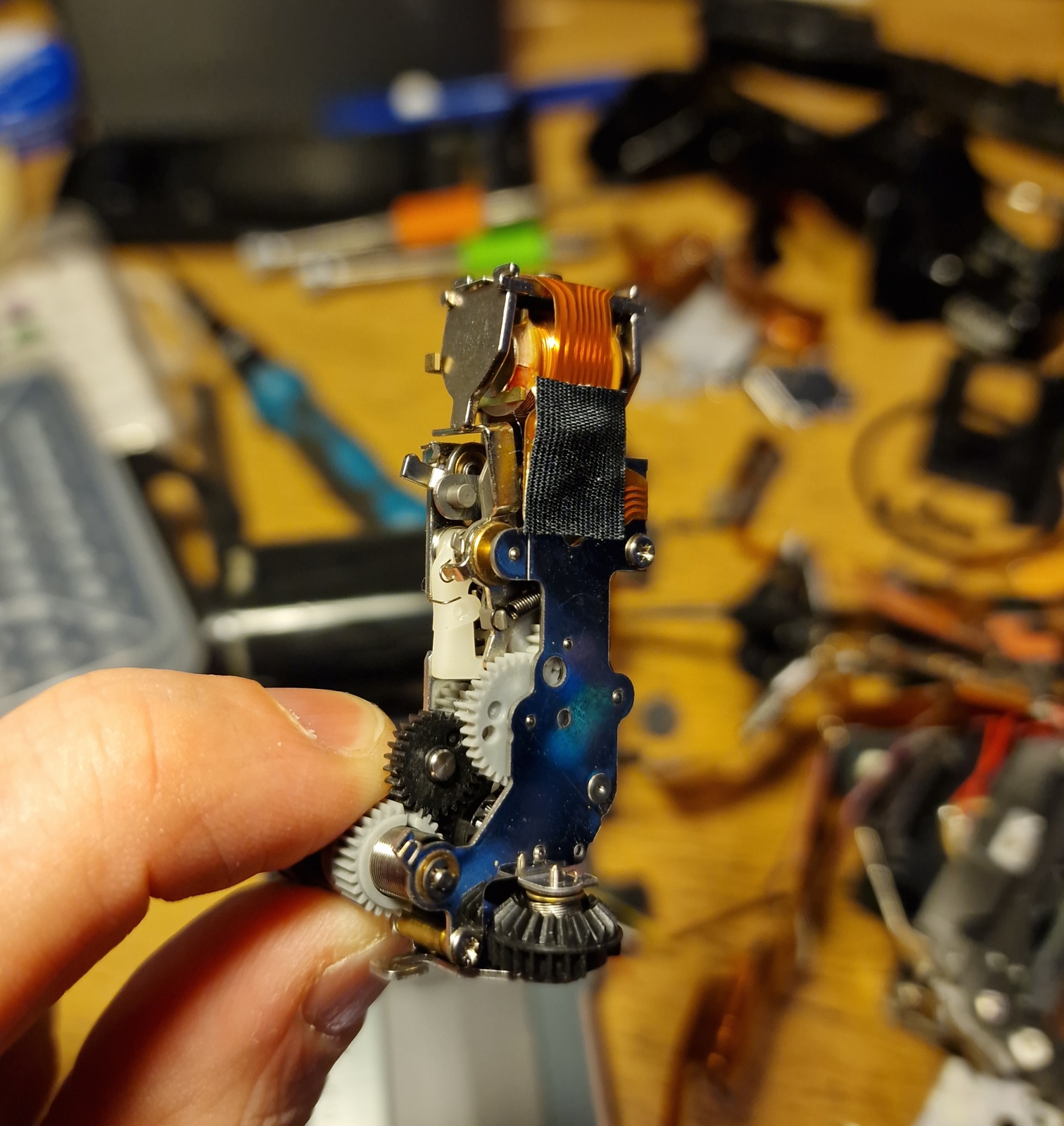

I've managed to get the LCD working again. I'm jumping the gun a bit with this post since I've not put the top back on yet, but i'm passing time as that epoxy cures.
First step was trying to find a zebra strip. I though I had some LCD modules somewhere but I couldn't find them... then I remembered i've got a bunch of junk cameras that have LCD panels in them.
The Minolta 7000i is a pretty lame camera and not currently particularly valuable. Plus i'm curious about how different it is to the 7000. There's always the risk a movie prop or some youtuber might make these worth a fortune to cosplayers some day though.

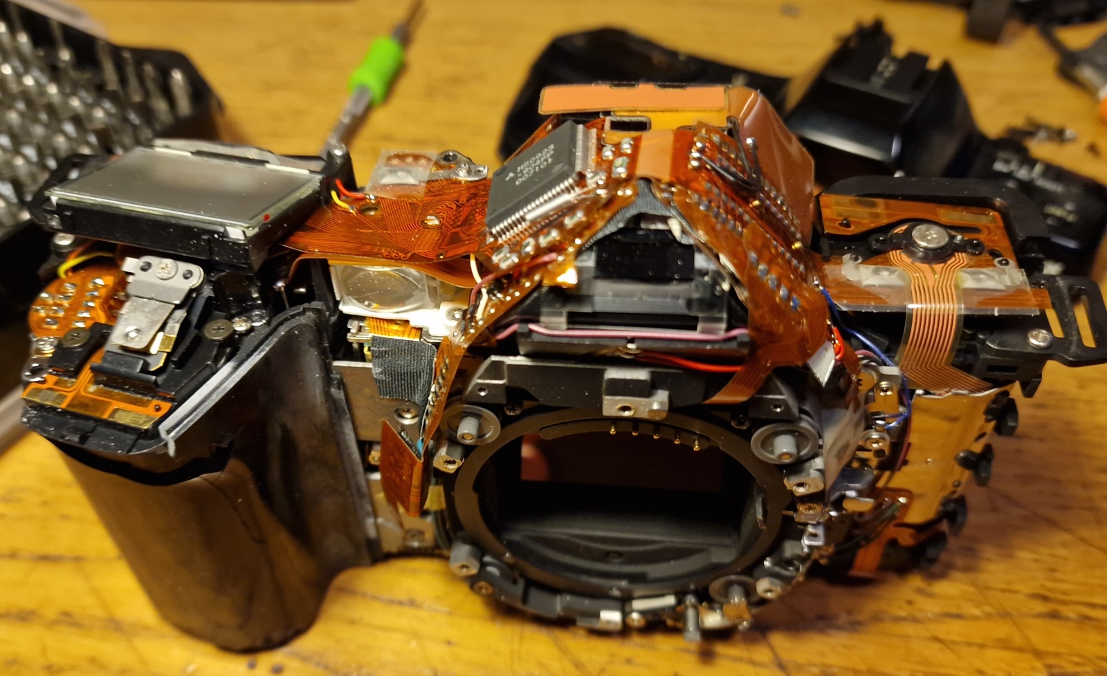

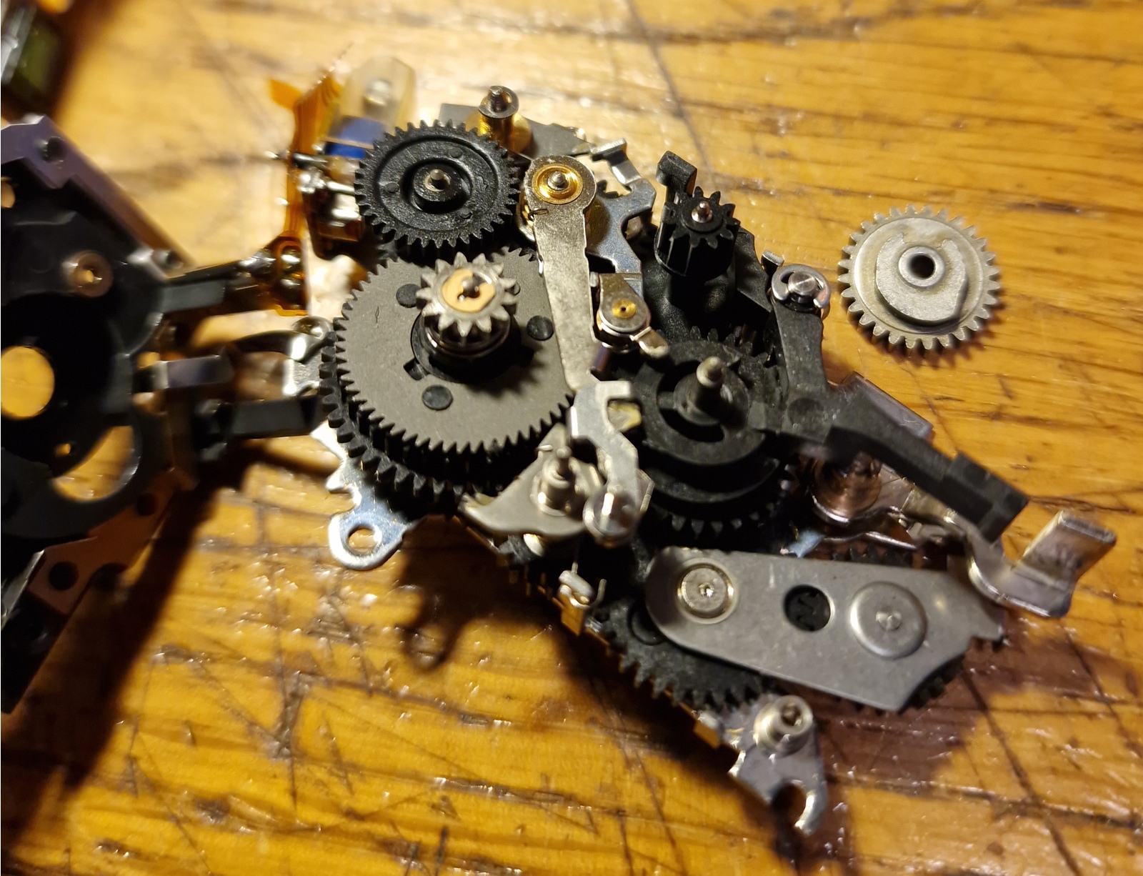

Getting inside of it was tricky since there's plastic tabs holding alot of the case on. I was convinced the grip part was separate and had to come off for most of it, but it turns out it's integral to the whole body. There's a secret secret hole the red arrow is pointing to that holds the top on, but I don't have a long and narrow enough screwdriver to reach it so the top just got ripped off. To remove the mirror box you need to pull the rubber grip off too, which is of course very brittle now.
The whole thing is quite baffling and awful, fully wrapped in soldered together PCBs that cover and obscure various screws. I'd say without a service manual there wouldn't be much hope of getting much done with this thing.
There's the aperture mechanism. It's nice that it's an easily removed module but not nice that you still have to take the mirror box out. But i'm not sure if these have the same failure issues.
An interesting feature is the film gate being moulded into the plastic body, doing a good job to hide any seam lines on the user visible side.

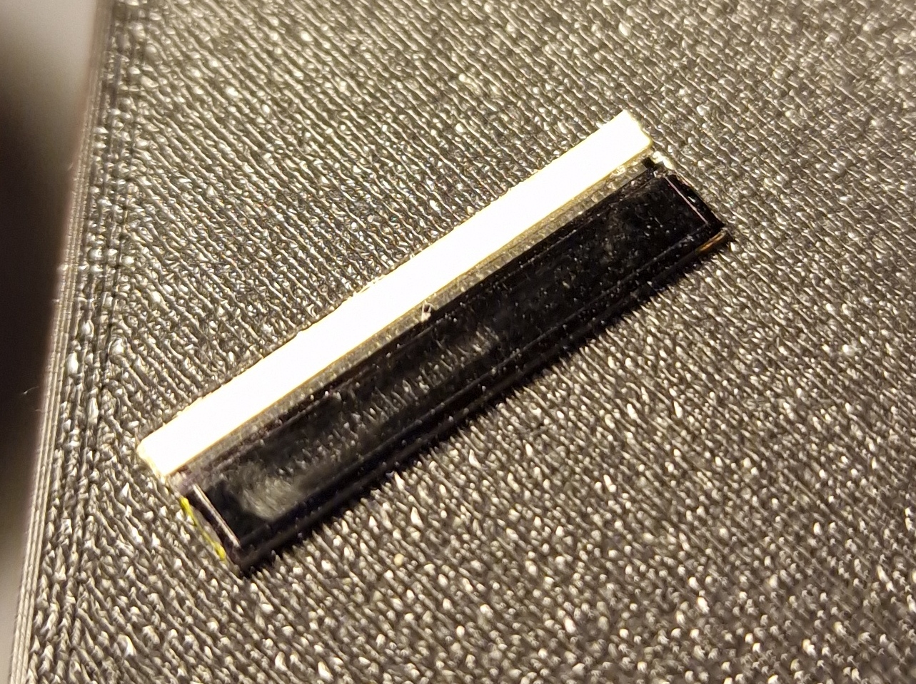

Anyways here's the thing I was after. I did look at the viewfinder LCD in the 7000i to see if that had an already sized zebra strip in it, but that was just more heat seal stuff.
I'd been pacing around thinking about clever and elaborate ways to cut a zebra strip but it turns out just a sharp scalpel goes right through it without issue. The donor LCD's glass edge was used as the cutting ruler. I used other parts from the camera to hold it in place and shim things up so the 'ruler' was gripping the rubber but not distorting it too much. The plastic diffuser there was just to keep the edge straight when lining things up, and moved out the way during the cut. I just estimated the cut thickness by eye at around 0.5mm. Also I made a second cut since the original edge was possibly a little deformed from years in contact with the LCD's traces.
And yeah that went back together and the segments are working fine. I'm fairly confident the zebra strip will maintain a good connection so I dolloped some epoxy around... and it aughta be cured enough for reassembly by now.
Edit: So much for 15 minute epoxy. It's JB Weld branded stuff. Hopefully it hasn't gone bad already. But it might just be because the dollops are so small. I'm happy to wait though, it's feeling like a real rigamarole by now and I don't really want to do it again.

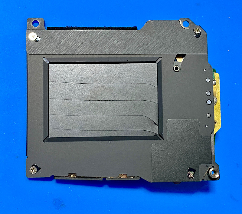

Sooner or later, all of my 9000s will be affected by the sticky damper in the shutter, or already are. That's why I don't use any for photography yet, as incorrect exposures are likely.
So my next project will be to remove the mirror box and try to fit the shutter with a new damper. I'm using foam for mirror shock absorbers, which is self-adhesive.
I'll also clean the aperture magnet. Then document the assembly.
Together with the adjustment of the mirror (due to wear and tear on a damper in the mirror box), three out of four problems would then be solved.
The occasional blocking of the mechanism of the shutter and mirror box is still an open question.

For the shutter dampers you might want something a bit more robust than foam since the sharp edge of the shutter blades are slamming into it. I could see that causing the foam to turn to powder after a while. Maybe some variety of silicone mat could be an available source of rubber? There's a whole world of silicone kitchen utensils, i'm sure something would have to feature ~1mm thick rubber. Years ago I was getting bits of rubber from this silicone clad spatula i'd bought that had a metal core.

To remove the rotten damper, should it be enough to remove the shutter unit and take off the rear frame? The fine springs on the right side can stay?
