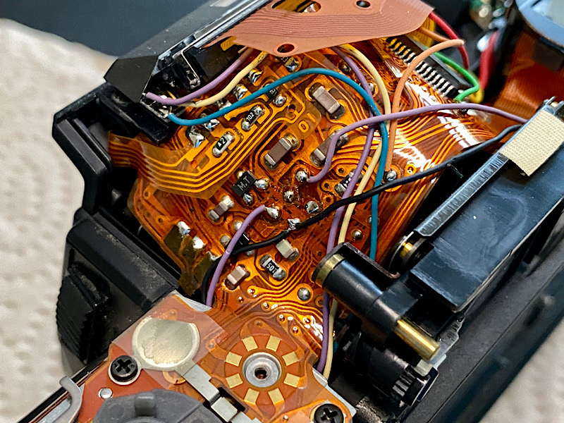

The flexible circuit board.
View from the back.

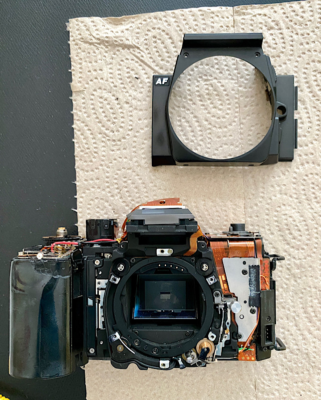

All removed parts from left to right.

Main units separated
Upper flexible circuit board, prism, eyepiece, front panel with mirror box and back panel with shutter.

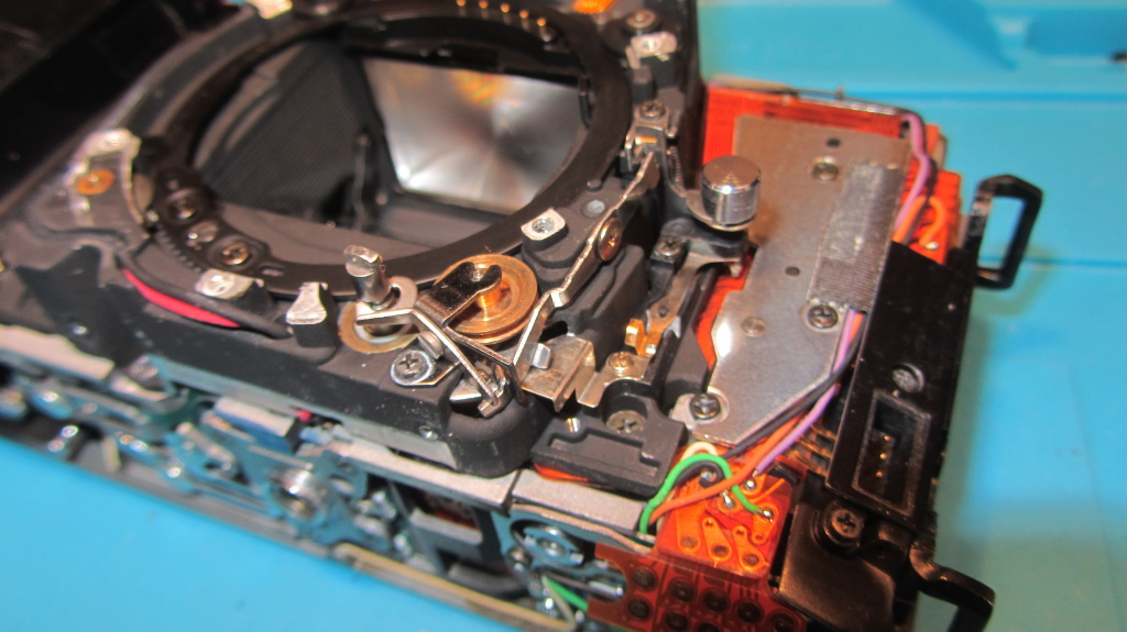

The shutter mechanism and aperture control to the right of the mirror box.

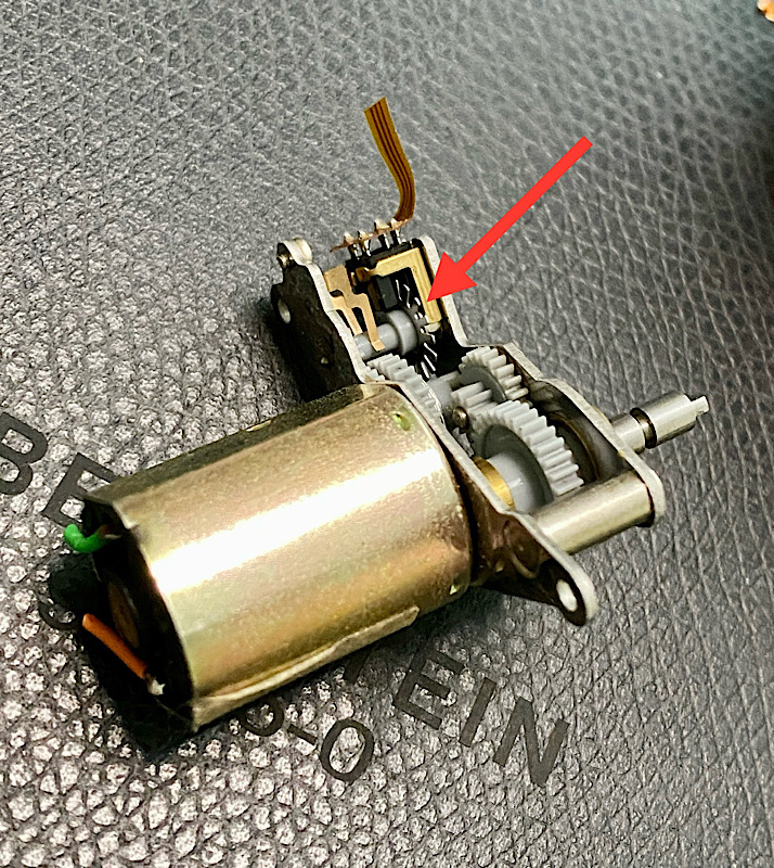

The photointerruptor (encoder) as part of the AF and aperture control.
I didn't notice anything wrong with the photointerrupter, it can be turned, but not as easily as on the Nikon F4. The question is whether it has to be turned as easily on the 9000.
I couldn't figure out how AF and aperture control work, so I wouldn't know where to look for a fault.

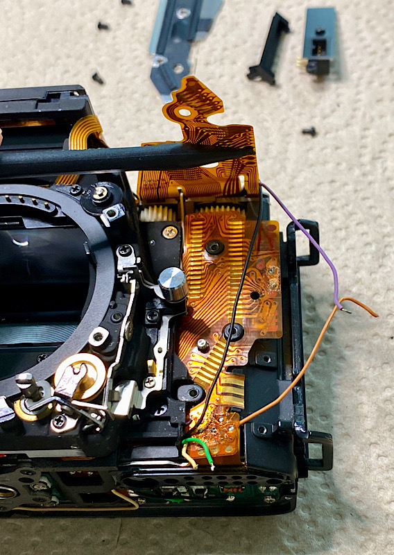

Unfortunately I lost track and patience with the flexible circuit board on the top, as the structure is very complex.
You have to fight your way through here to get to the screw connection of the front panel so that you can remove it to get access to shutter and mirrorbox with AF motor and aperture control.

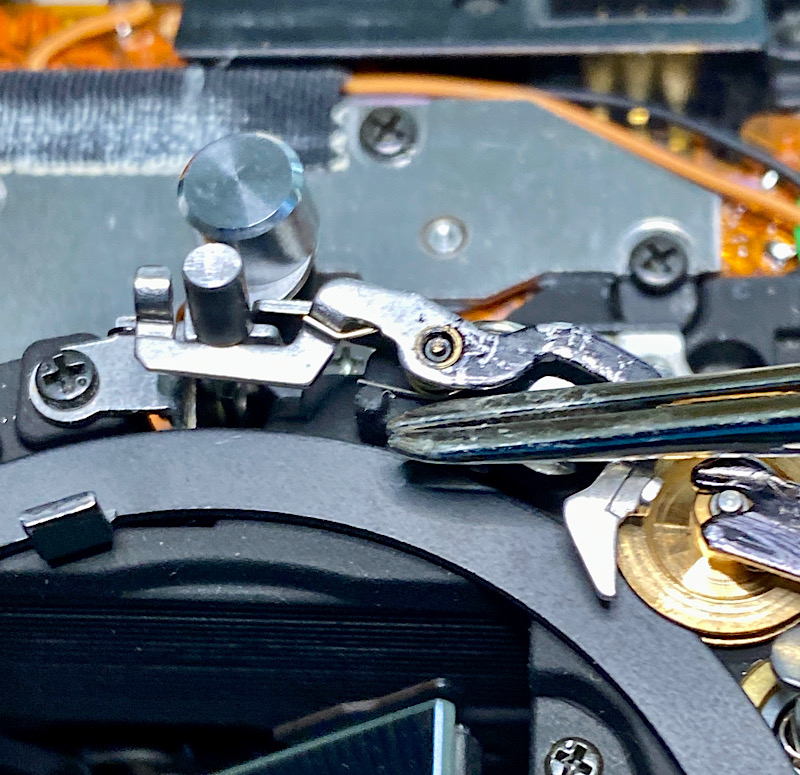

Removing the bayonet ring.

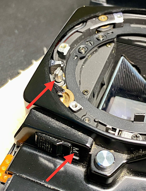

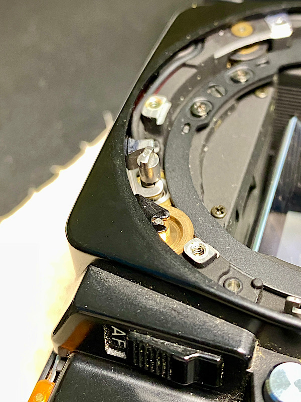

Positions of the AF/MF clutch.
Be careful, there is a spring-driven lever that engages a pin. The assembly is loose.
Positions of spring and pin.
Reinstallation
To remove the bayonet cover, set the AF/MF coupling to „AF“.

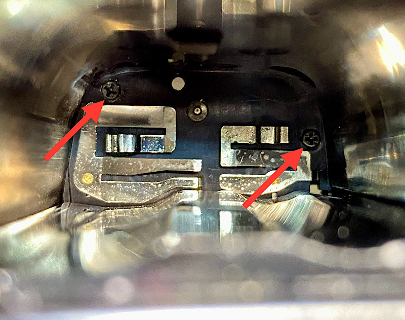

Looking into the battery compartment, these two screws fix the circuit board to the grip.
The left screw is secured by a nut (arranged for demonstration), and this switch is located in between.
Releasing a clamp that holds two flexible circuit board parts together.
After desoldering the battery cables (thick, red and black), the grip with the battery compartment is free.

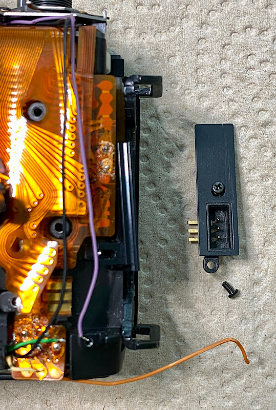

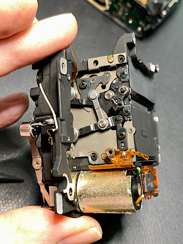

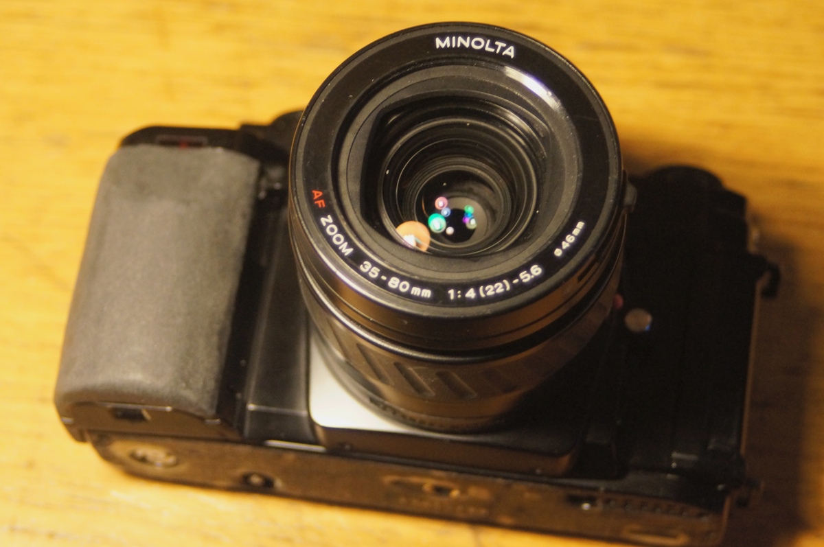

minolta 9000AF with the mirror box and other parts removed. i was using that lens as a handle to hold it, which put pressure on the aperture lever enough that things did sound like they sprung out of place on removal. but that wasnt so much the case

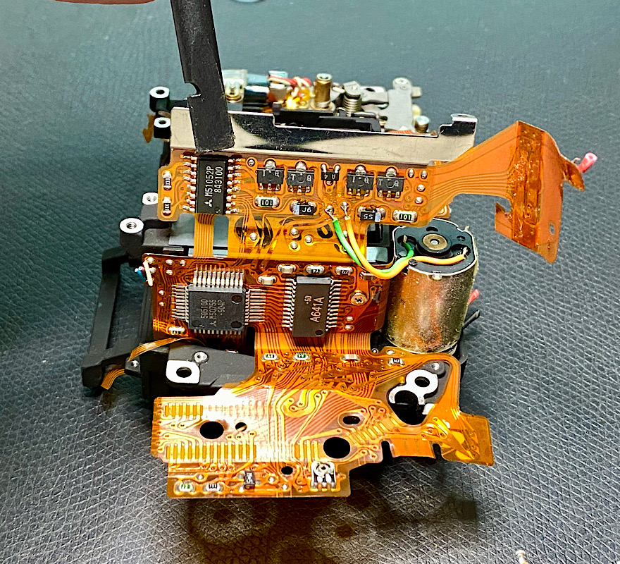

I managed to repair the aperture on one of these and holy moly that was hard work. To try get to the point quickly – i'm not sure how I specifically fixed it.
aperture control mechanism removed from the mirror box. the way it appears to work is that when the mirror flips up, the green electromagnet is energized and holds that white lever in the middle up away from the chopper wheel (optical encoder), then the black electromagnet is energized which sends the mechanism moving. then once it's determined its moved enough, the green electromagnet is released and the white lever catches into a pawl and halts the movement. my best guess on the fault i had with this one is the black electromagnet could never release due to sticky fouling on its surfaces. they can be tested with about 2-3 volts from a power supply. no idea how much they use in actual use

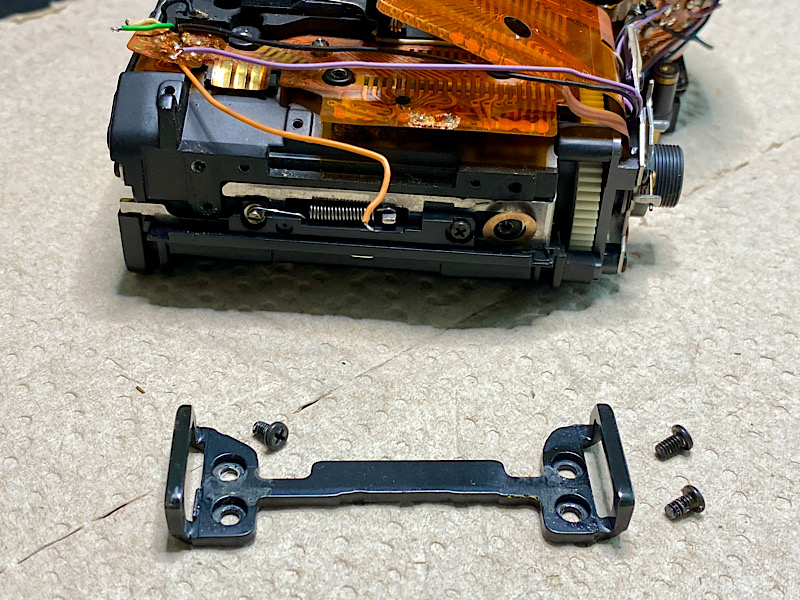

I disassembled it enough to remove the mirror box, shutter, and aperture control assembly from the mirror box. Then I cleaned the 3 electromagnet surfaces with an isopropanol slip of paper, after which I reassembled things mostly following steps in the service manual available on archive.org
Then the rest of the camera was re-assembled, cleaning any contacts along the way with isopropanol. I'm skipping over alot of details... but in terms of what I did that could've fixed the aperture, the only 3 things I can think of are either:
1) the surfaces of the magnets were sticky with oil or something and not releasing (I read a post somewhere a while ago claiming this to be the common cause of fault).
2) some dirty contacts were causing issues.
3) something had jumped out of place or gotten misaligned, and was reset during the reassembly.
photo of the working camera, with the aperture stopped part way. that handgrip was rebuilt with sugru and not completely perfect, but i've learned from past mistakes in that I should really just accept good enough with that stuff.
Either way I guess it is repairable, but we'll see if it lasts or if I caused any new problems I haven't noticed yet.

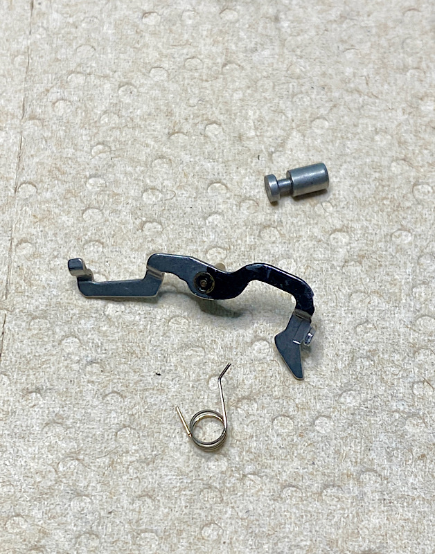

shutter part disassembled. another trick to getting this back together was using a tiny bit of tape to hold that black wafer on the left in place. im wondering at this point if theres a way to reach the electromagnets inside that thing to clean those too...
So the other major fault with these cameras seems to be the rubber buffers in the shutter turning to slime and fouling the curtains. I feel a fairly deep disassembly is maybe a good idea regardless of the state of the aperture.
photo of the old rubber bumpers along with the new ones reinstalled. cleaning the old slime off was done with lighter fluid and isopropanol on cotton swabs and slips of paper between the leaves. these things are harder to damage than i'd assume from how thin they are. i guess its cuz titanium
The shutter was opened while it was cocked and the old bumpers were replaced with ones cut from 1mm rubber sheet. I got some scraps of the stuff from when a neighbor was having their roof repaired.
The tricky part of reassembling this was that one spring jumping out of place, and the best way I found to get that back in was leave the hook part disengaged when reassembling, then firing the shutter after putting the screws back in to move the hole closer to the edge for easier access, but it's still a bit of a fiddle.

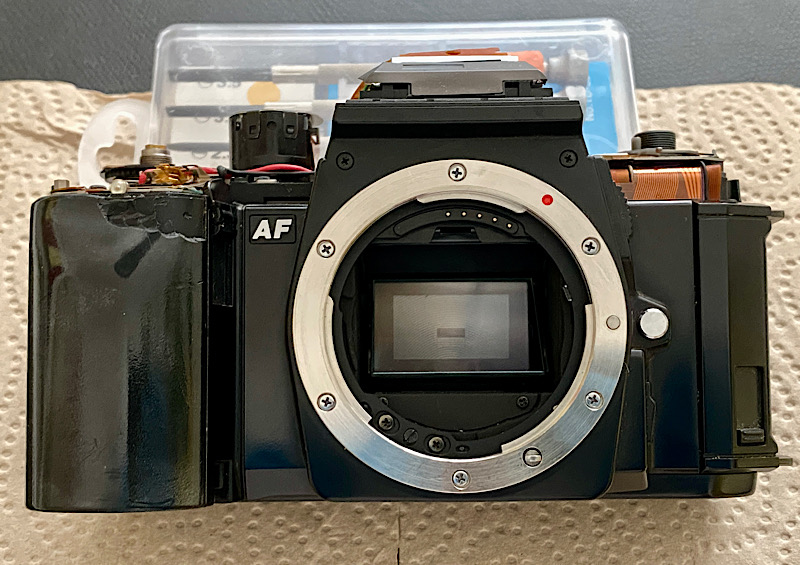

After a year i'd forgotten the camera had deeper electronic faults, probably caused by leaked batteries, and was pretty excited spotting a spring that'd jumped off of its sear. Like it seemed a pretty blatant solution to the problem... and it wasn't till I saw that blinking F-- error again after careful reassembly over a couple days that I remembered. But it might suggest multiple causes of aperture failures besides the sticky magnets.
photo of the camera reassembled. i gotta admit these photos i took weren't super great. i tend to sort of take them in a hurry with the phone camera more to aid reassembly. ive got 100s of out of focus close-up photos of parts from all angles but i tend to forget to take overview photos of progress and such
But yeah, I'm pretty excited to now have a working one of these stupid lumps – they're cool cameras! Or rather, i'm excited to know these common faults are repairable. I was pacing around last year considering spending more money than I had on a confirmed working one, but knowing that it'd be at risk of turning into a pumpkin at any moment I figured i'd never feel like I truly owned it or could rely on it unless it was something I could keep working.

If I could wish for something for Christmas, it would be a tutorial on how to repair the aperture control of the Minolta 9000.
That would be a pioneering achievement for all fans of this wonderful SLR!
Maybe Santa Claus will suggest that you write it. He himself cannot 🙃🎄
