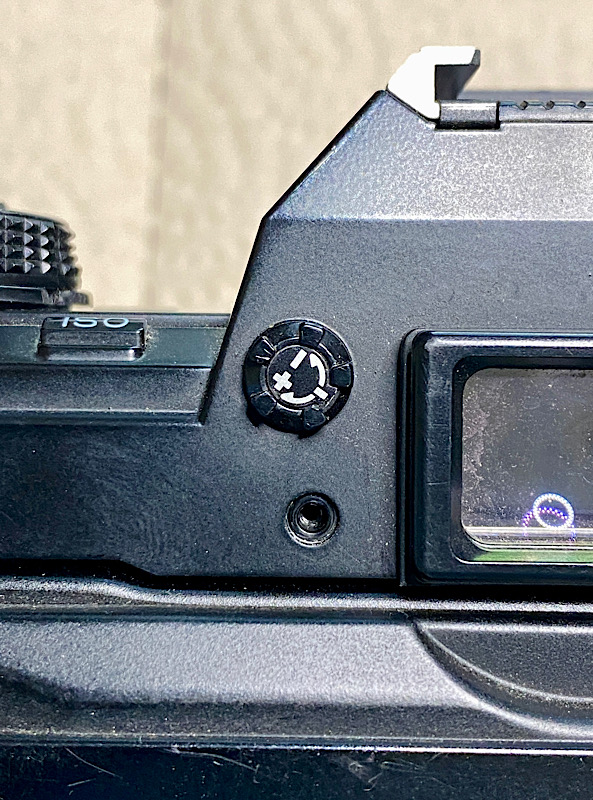

Two screws next to the eyepiece.
A screw on the side above the handle that holds the two AA batteries.
There is a screw under the metal cover plate on the knob for adjusting the diopter correction.
A screw holds the plastic cover over the metal winding lever.
The main switch can be removed after unscrewing the retaining ring.
There is also a screw under the labeled and glued plastic plate.
