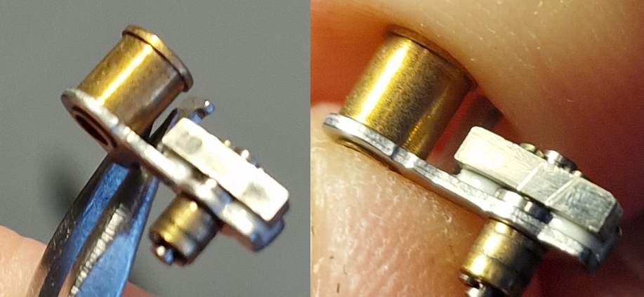

Checking the position of the upper spring
@ogtronix recommends checking the correct position of the upper spring by looking from the side.
One end of the spring is held by the upper frame, if you remove the frame when opening the shutter, it jumps out of position.
The other position is clear, a hook that grips into an opening.
On the left is the shutter I assembled, on the right is an unopened original. One end of the upper spring must be in this position.

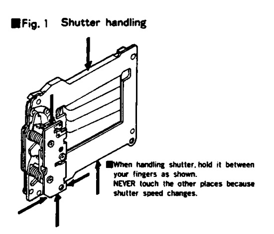

I'm currently looking at the service manual for the Copal Square shutter, which was built in various variations.
Lubrication is mentioned there.
I'll check to see if I can find any traces of it before cleaning the next shutter. The axes for the curtains are probably running dry.
From the service manual for the Minolta 7000 AF, which also has a Copal S shutter.
I think you should take such instructions seriously.
This also applies to opening the shutter unit when using a screwdriver, so as not to put any strain on the construction.

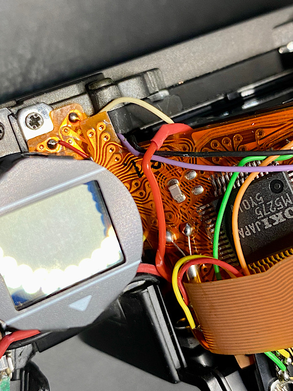

Hello Andreas!
I desolder the connecting cables of the magnets in order to trigger them individually with my laboratory power supply, but this does not work.
You have to add power of ~ 3 V to generate a magnetic field with opposite polarity to the magnetic field of the permanent magnet.
This time it worked
The 9000 AF is whole again, the cleaned shutter works, it was another exciting race 🤠
One shutter curtain did not fire. I had forgotten to solder the red cable from the shutter to the circuit board. I was able to find it in the camera and pull it out without having to disassemble the 9000 again. Since it was too short at this point, I extended it.
When I tested it after assembly, the AEL measurement memory, which is activated via a button above the thumb rest on the back, did not work.
A follow-up inspection revealed that the relevant switch on the counter base plate under the dial was defective. A replacement part was available.
To repair it, I had to take off the top cover, the dial and to replace the counter base plate. Since this is part of every disassembly and I have done it many times, it was done quickly.

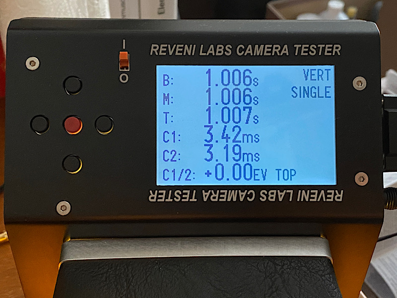

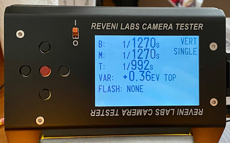

Results on the shutter tester. The 1/4000 second remains untamed
The shutter works well up to 1/2000 of a second, but at 1/4000 of a second there is a deviation of 2.8 EV. Several consecutive releases worsen this value, but then it improves again.
The shutter curtains move with a delay of approximately 0.20 milliseconds. Measured here at a shutter speed of 1 second.
At a shutter speed of 1/4000 seconds, you can see that the shutter exposes the sensors at different speeds. This results in a considerable EV deviation.
At 1/2000 second the EV value improves significantly.
At 1/1000 second this is already a good value, which continuously improves towards slower shutter speeds.
1/500 s
1/250 s
1/125 s
1/60 s
1/30 s
1/15 s
1/8 s
1/4 s
1/2 s
1/1 s
I cannot say why the shutter deviates so much at 1/4000 second. It is obvious that different curtain speeds are more noticeable as exposure deviations at shorter times.
It can't be the sticky shutter, that's been fixed. Perhaps a small irregularity in the shutter housing is affecting the process.
Unfortunately I see no way to adjust the curtain speeds in conjunction with a measurement, see further up in the thread. But you can live with deviations, provided you know about them.
The next few days will show how this affects film exposure and hybrid processing in practice.

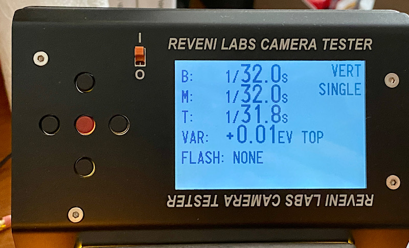

Unfortunately, I had some bad luck today
I removed the shutter, which I had previously cleaned and fitted with replacement dampers, to adjust it.
In doing so, I mistakenly turned the wrong ratchet gear, which is obviously responsible for creating the curtains slit. I couldn't reconstruct the original position, and the gear no longer locked; it only maintained its tension via one end of its spiral spring.
After reassembling the 9000 AF, I discovered that the shutter now only shoots at 1/20 of a second.
