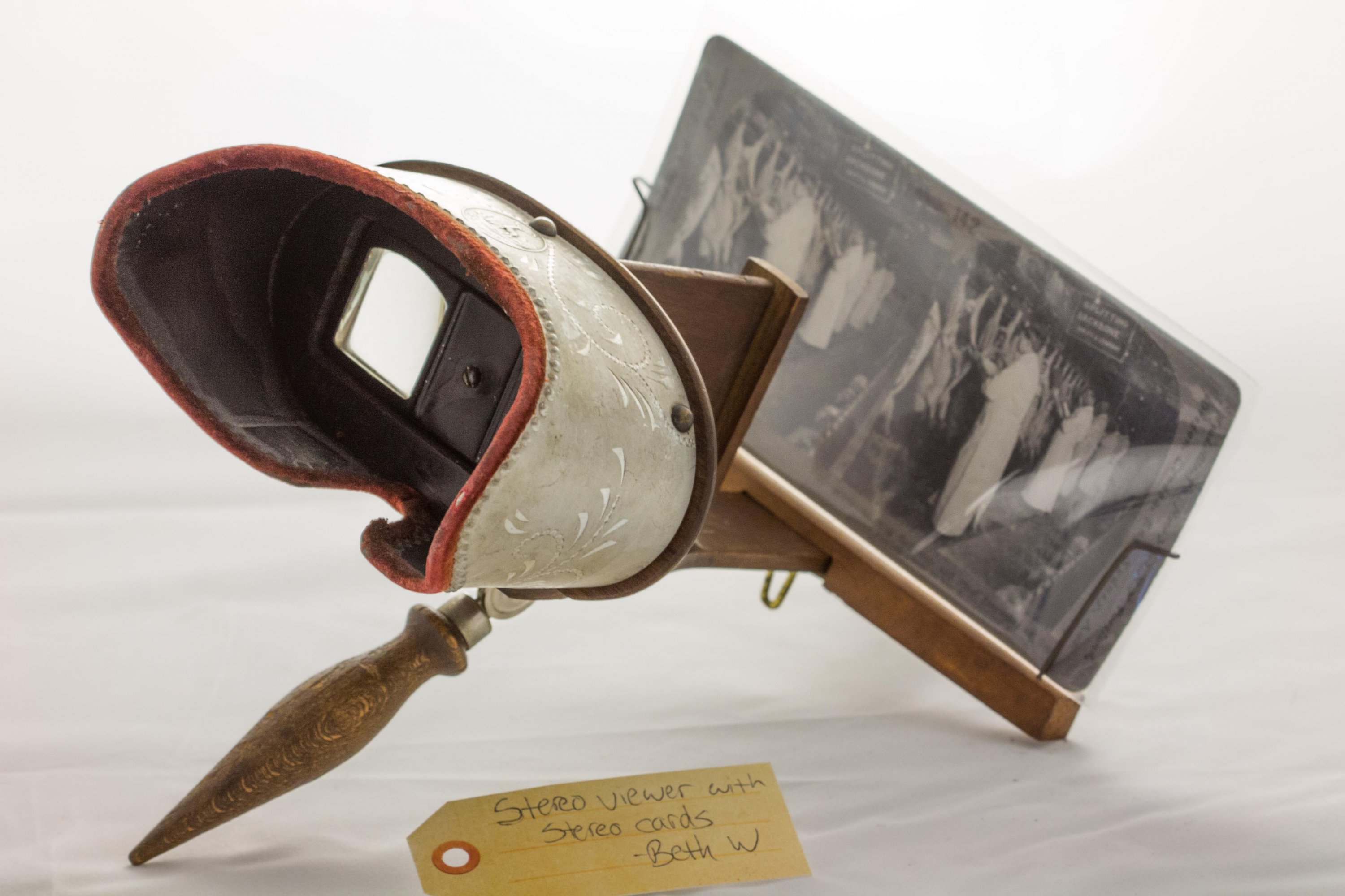

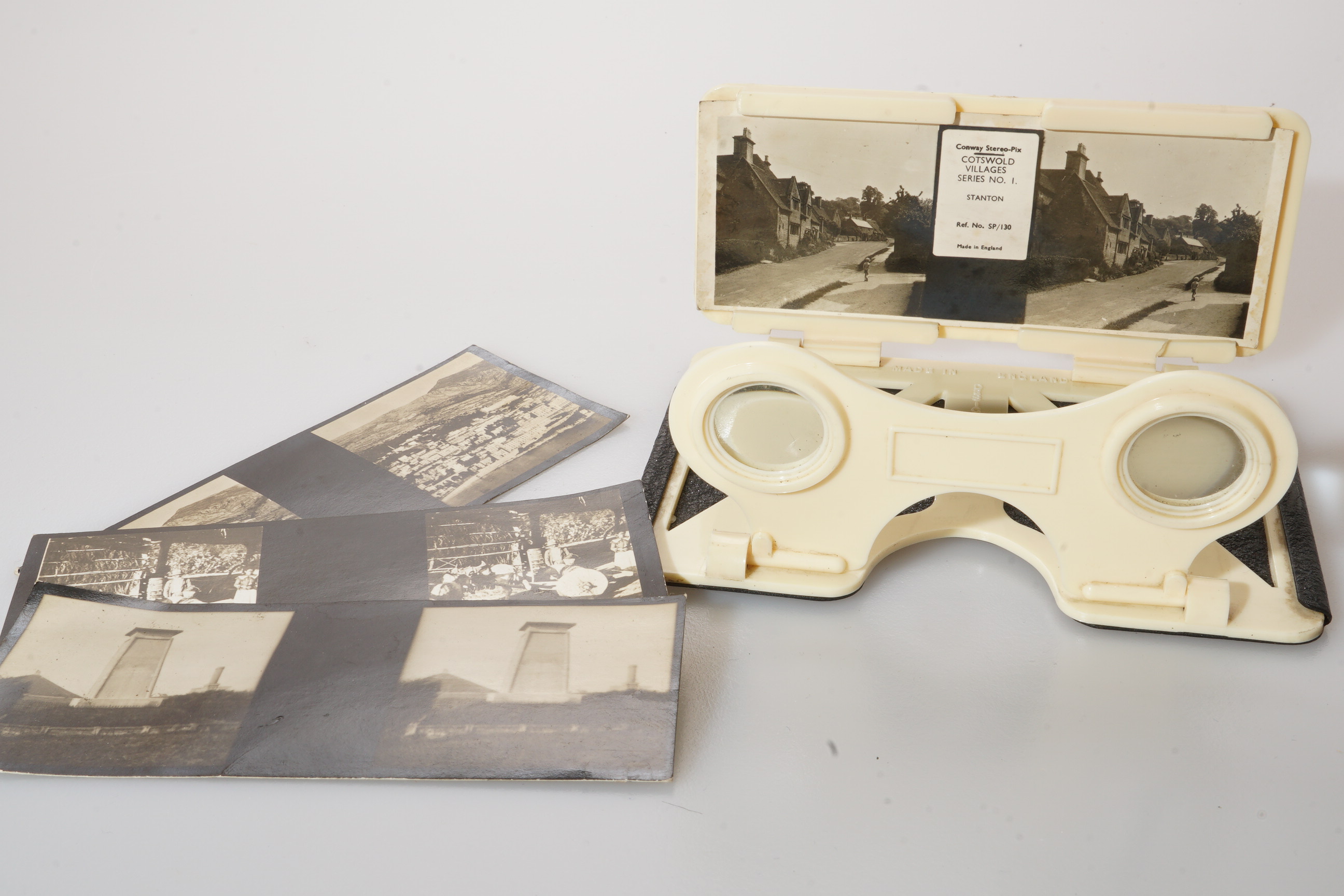

Well, but how hard is to find those "eyeglases" that you put in front of your eyes to see stereo images. I've seen on the internet stuff like that, but is there any for 6 x 9 format or larger?
You do not understand stereo projection.
For this the format is irrelevant on the viewing glasses.
I'm takling about stuff like these
I think you are asking whether there are any viewers for looking at 6x9 cm transparencies? I don't think so. AFAIK, the slide viewers stop at 6x6 size. Of course you can make stereo images with cameras that shoot 6x9, but you would have to make prints of the images for viewing with one of the viewers such as those in the photo you posted, or view the images on a screen with such a viewer (I use the OWL viewer from London Stereoscopic Company, which has a removable back plate and can be used to look at online images on a phone or tablet, as well as small prints.)

So basically I have to use a hand held viewer. Got it. Thank you.
