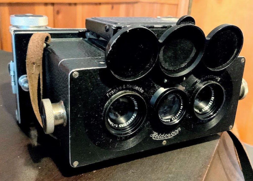

Heidoscop with 120 roll film back.
image of camera in action
