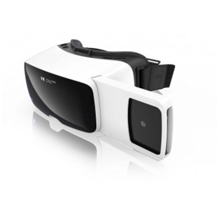

I have a Zeiss VR One goggle set that I think can be turned into a stereo set viewer rather easily.
it has a sliding tray that with a bit of plastic work could be turned into a slide holder with a thin backlight.
Anyone have any ideas or know of anyone who has done this (I have searched! :smile:?
