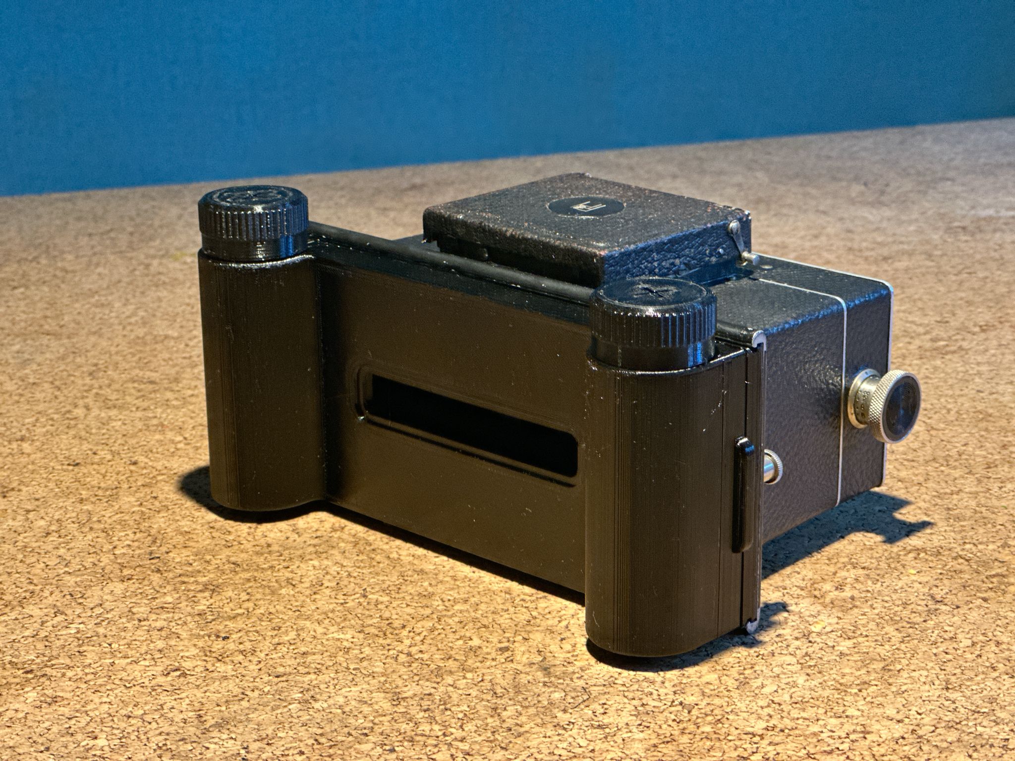

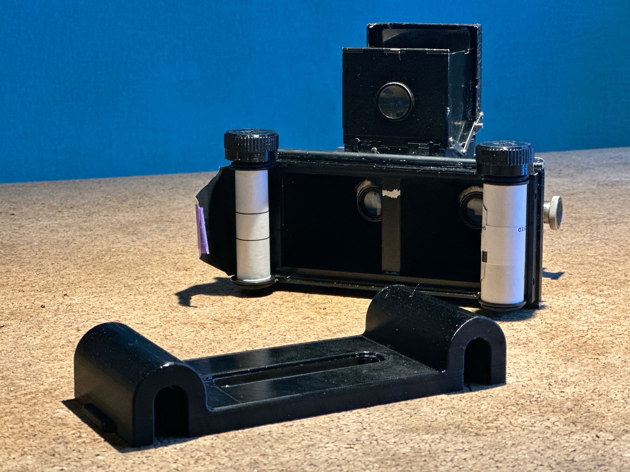

hey guys, I just managed to 3d print a roll film back for the Heidoscop. It works like a charm! Is perfectly light tight even with the back continuously open.
I spend more than 72hrs on the design improving it in 24 design iterations. The design can be bought here if you'd like to make your own version of it:
cheers!
cheers!
This looks cool! Where can we see some sample photographs or your design in action?
