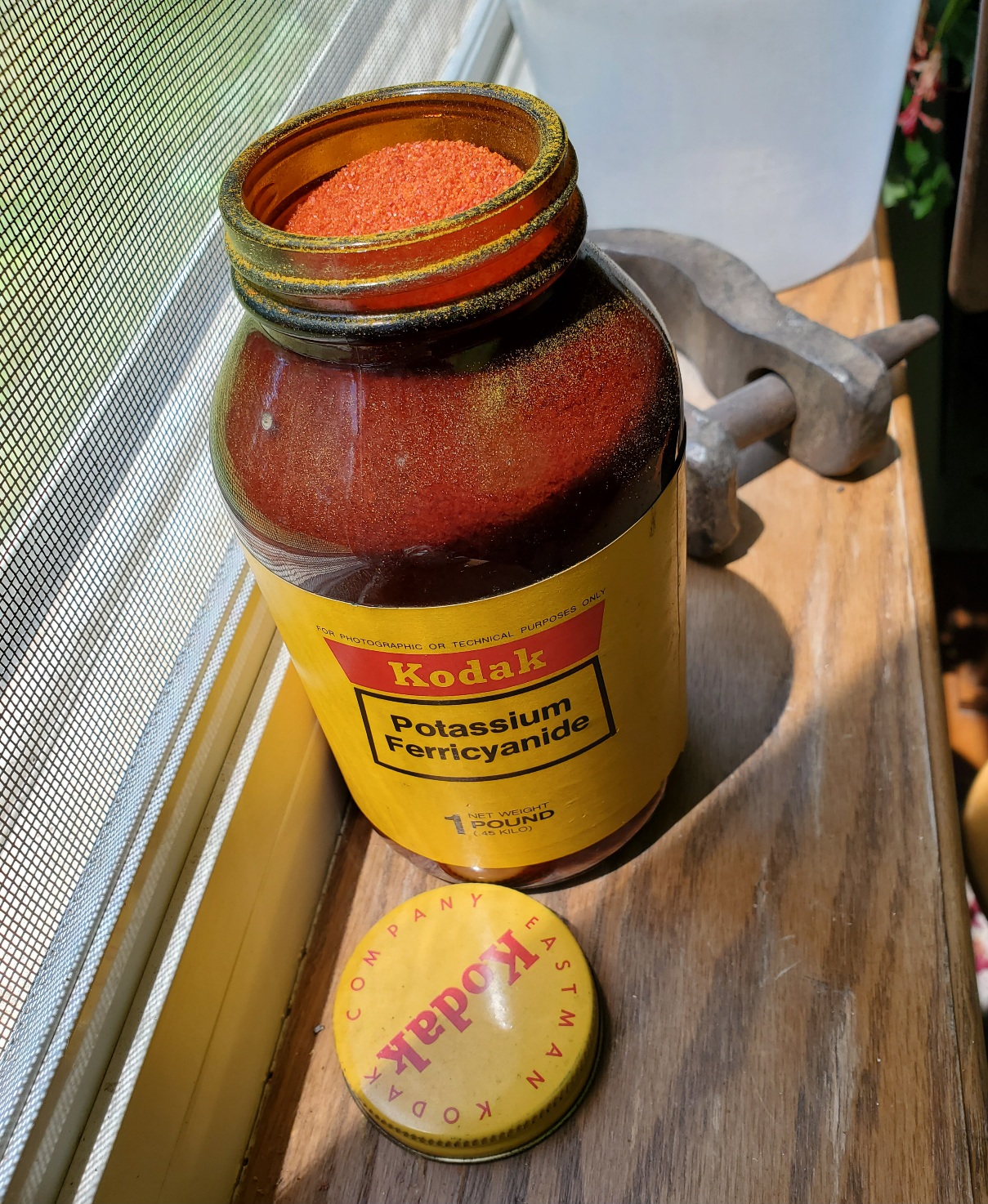

I've got a screwtop jar of potassium ferricyanide I've had for years. Still works like a charm.

I have had Ferricyanide solutions that are years old, but I've also had some degenerated, and Ferricyanide crystals breakdown to Ferrocyanide.

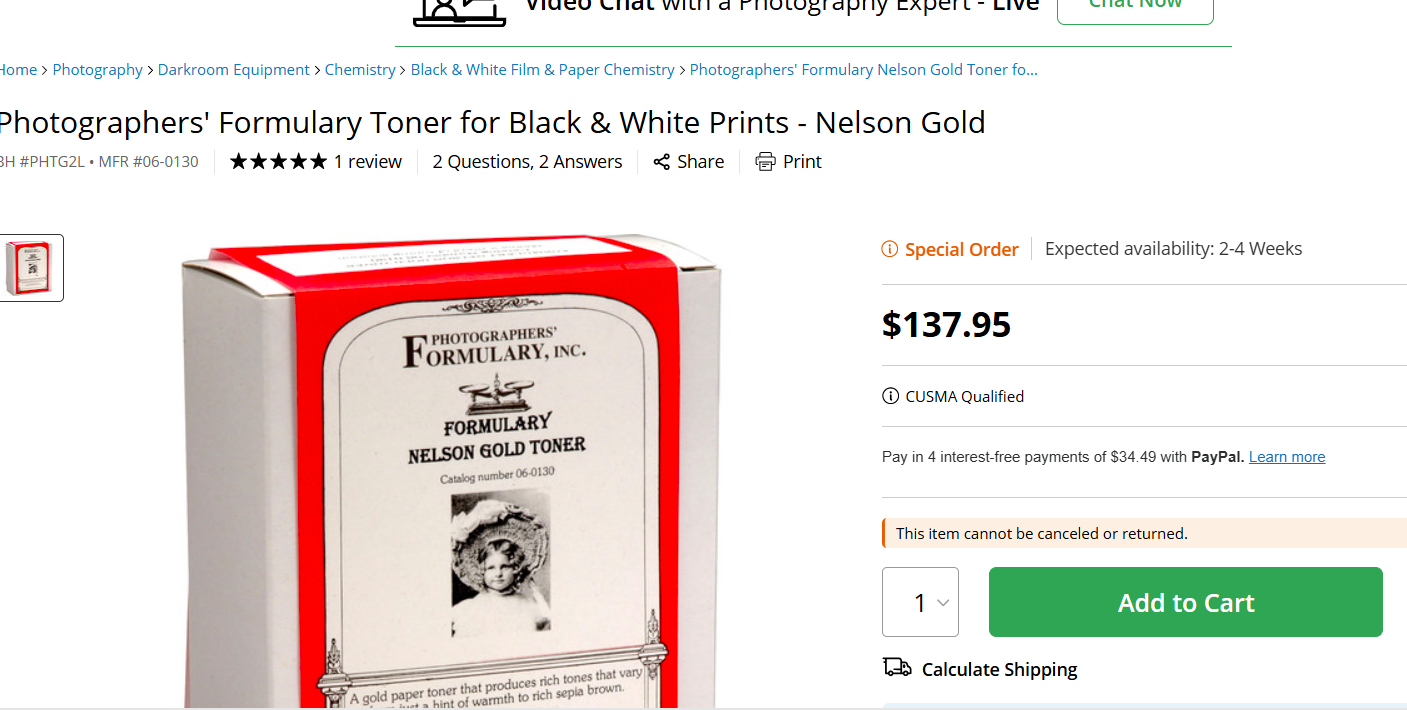

Get ya some of this, and prepare for maximum toning! 🏆
I don't understand.
Tim Rudman is a true artist, and the go to source for toning information. In order to achieve maximize the fine control and wonderful tone variability that toning offers, you have to accept that the best materials are expensive!
For example, gold toner is really nice:

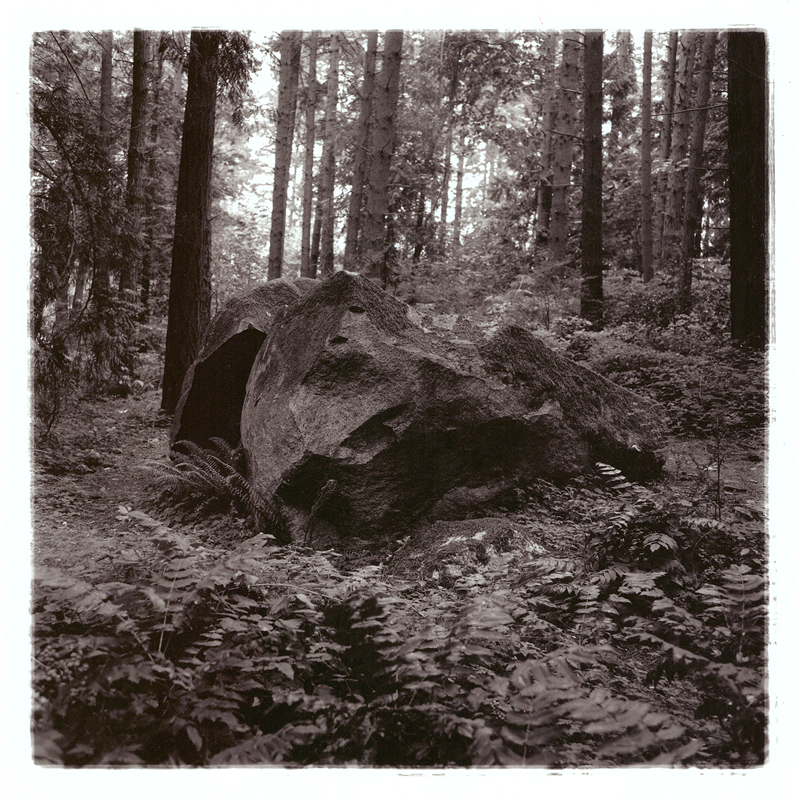

MGIV RC in selenium:
MGIV RC Cooltone in Selenium:
Polymax RC in Sepia II:
Oriental (I think) in Berg brown toner:
MGIV RC in selenium (IIRC):
MGIV RC in Berg brown toner (IIRC):
Subject of course to the usual caveats about how it is difficult to achieve consistency and accuracy when trying to faithfully reproduce on the internet how the toning actually looks in real life.
