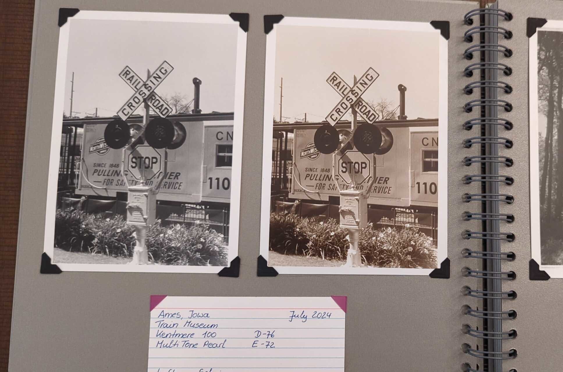

I'm sorry. I thought I had talked about that a couple of times before. My bad. Here's what I'm doing with my first few prints:
I'm pretty happy with this. As you can see, this is a glorified scrapbook. This is what I consider archival storage. I have a nice scrapbook with acid-free paper and I got photo corners so that there is no adhesive on the print and the paper isn't as likely to press against the print. This is a significant upgrade from how I store the prints that I print digitally. Those go into an album with sticky adhesive sheets.
Once I have a larger stack of prints, I will pick some favourites to mount on the wall. I have bookmarked some mat board on Amazon and I will mount the prints on the mat board with hinging tape.
