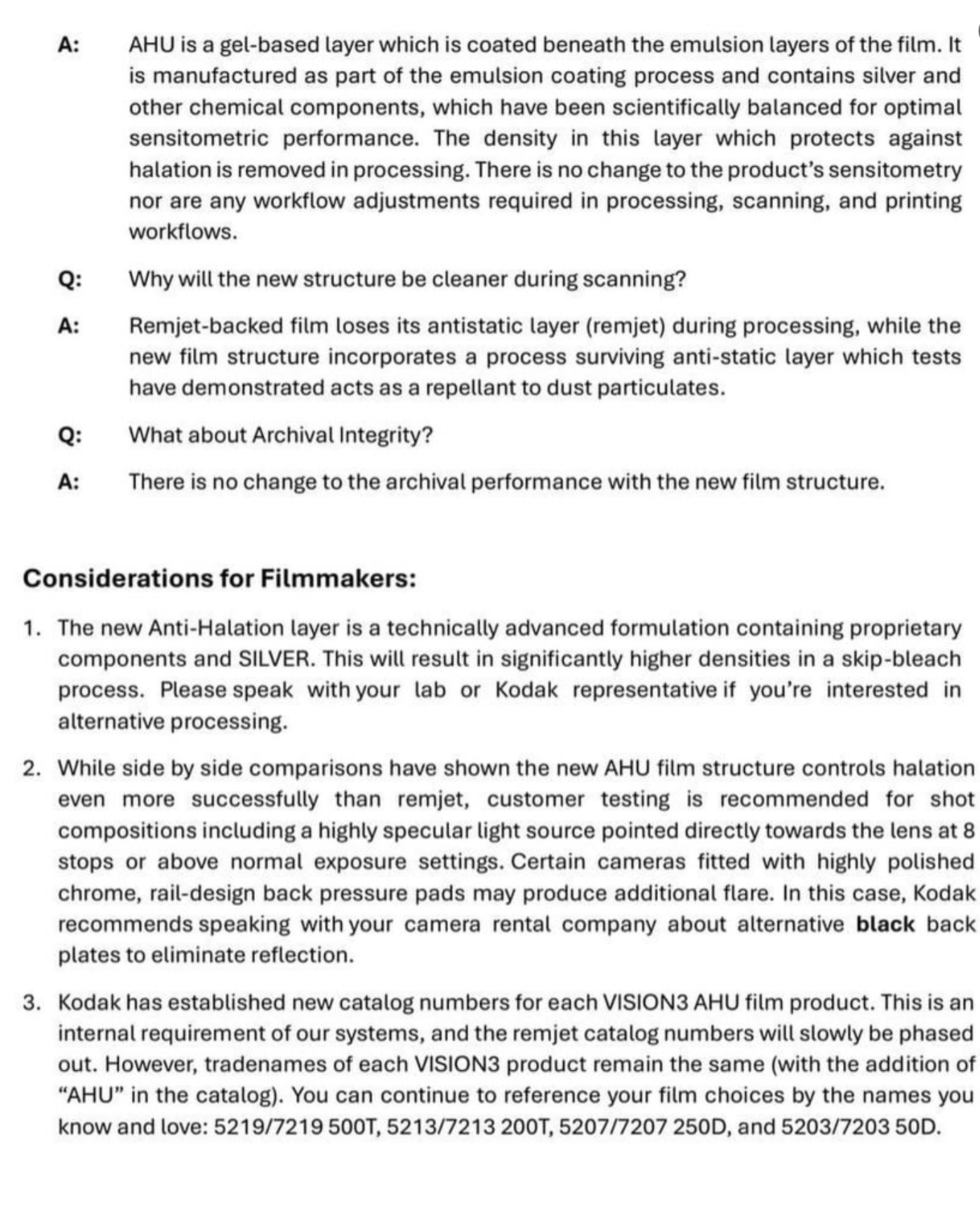

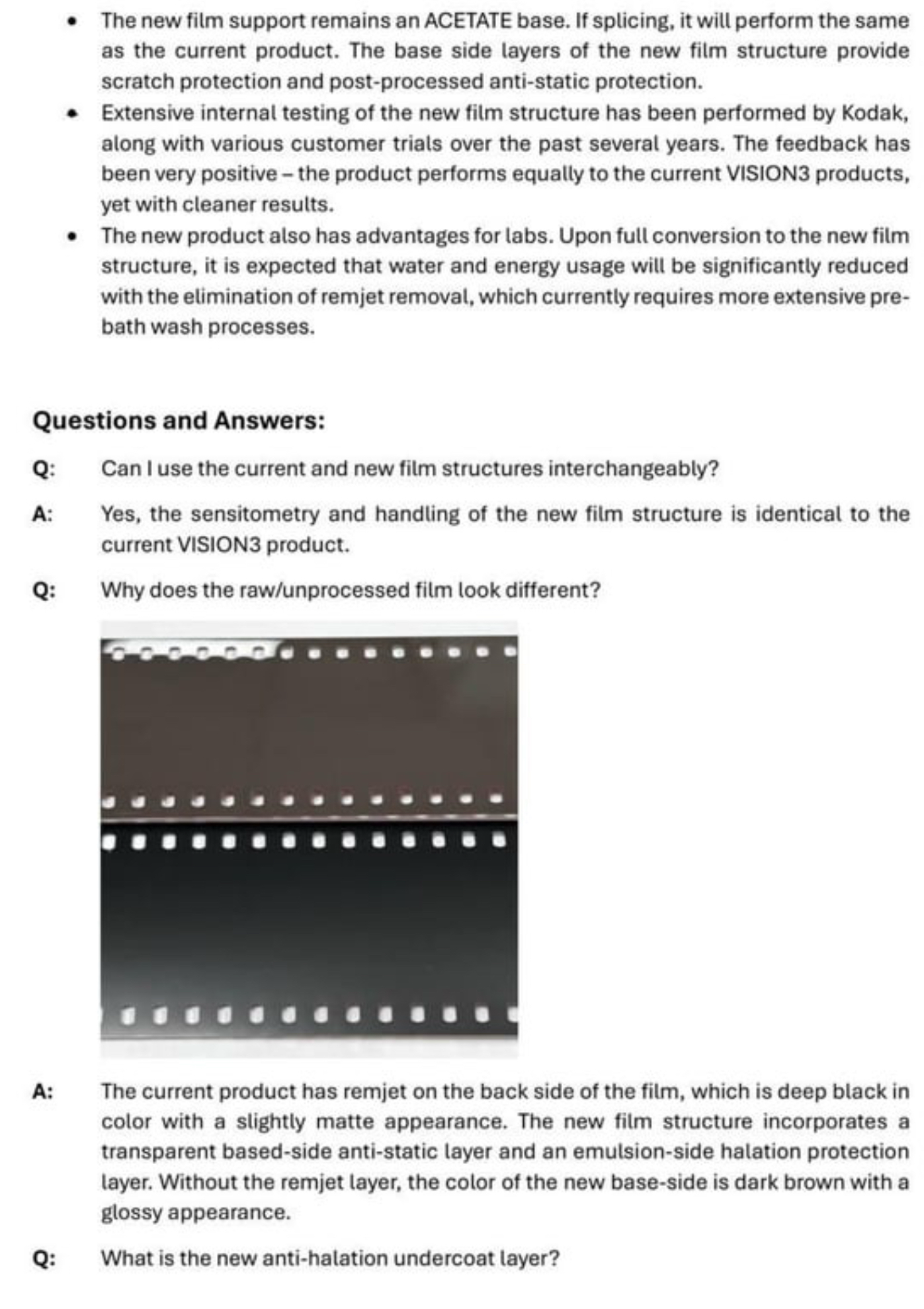

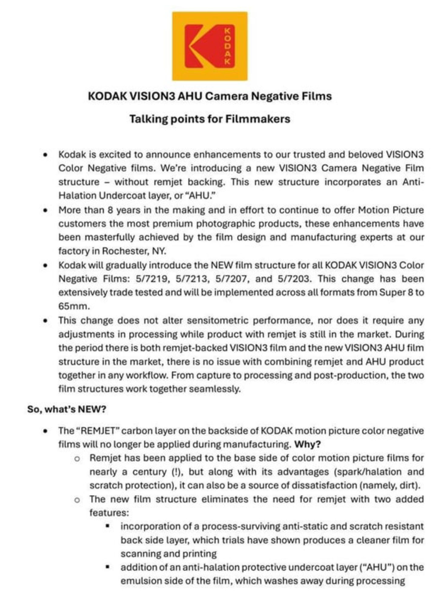

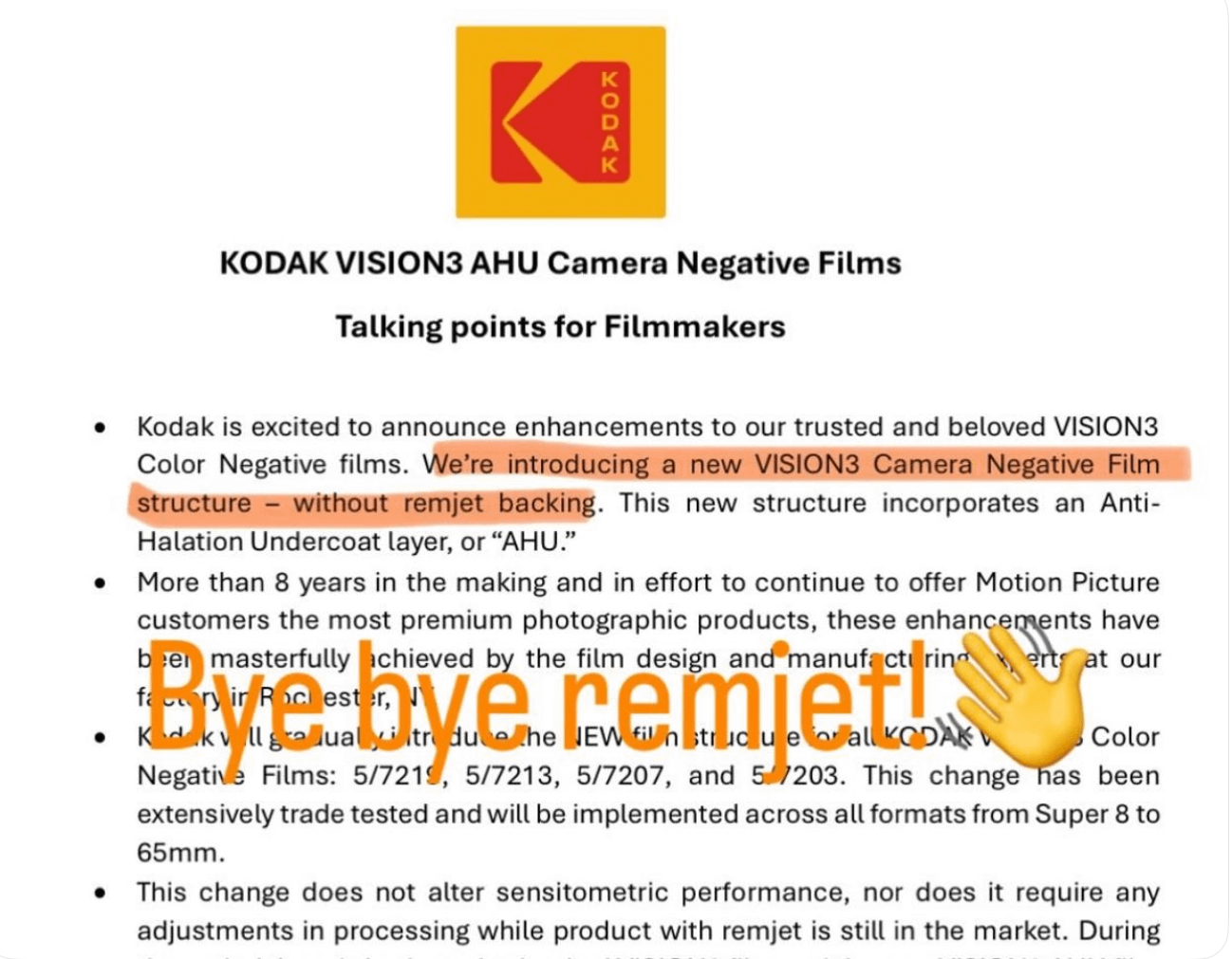

someone has now obtained the full kodak document that kicked off this thread;
Thanks for updating; this all sounds very nice indeed!
Noteworthy is that the new AHU Vision3 will replace the present product, not be an addition to the line up as I understood before. The process-surviving antistatic layer is a real benefit; I can attest to present Vision3 being a veritable dust magnet. Not a major issue, but if that aspect improves, this would certainly be helpful.
The energy savings mentioned by Kodak are probably a major factor in this, as is the removal of a processing step and the impact on wastewater flows this will have. There's presently a real push towards more sustainable products and production, and this change fits very well in this picture.
And it finally eliminates borates from all of Kodak's colour processes - in terms of volumes B&W neg probably isn't an issue, but colour is.

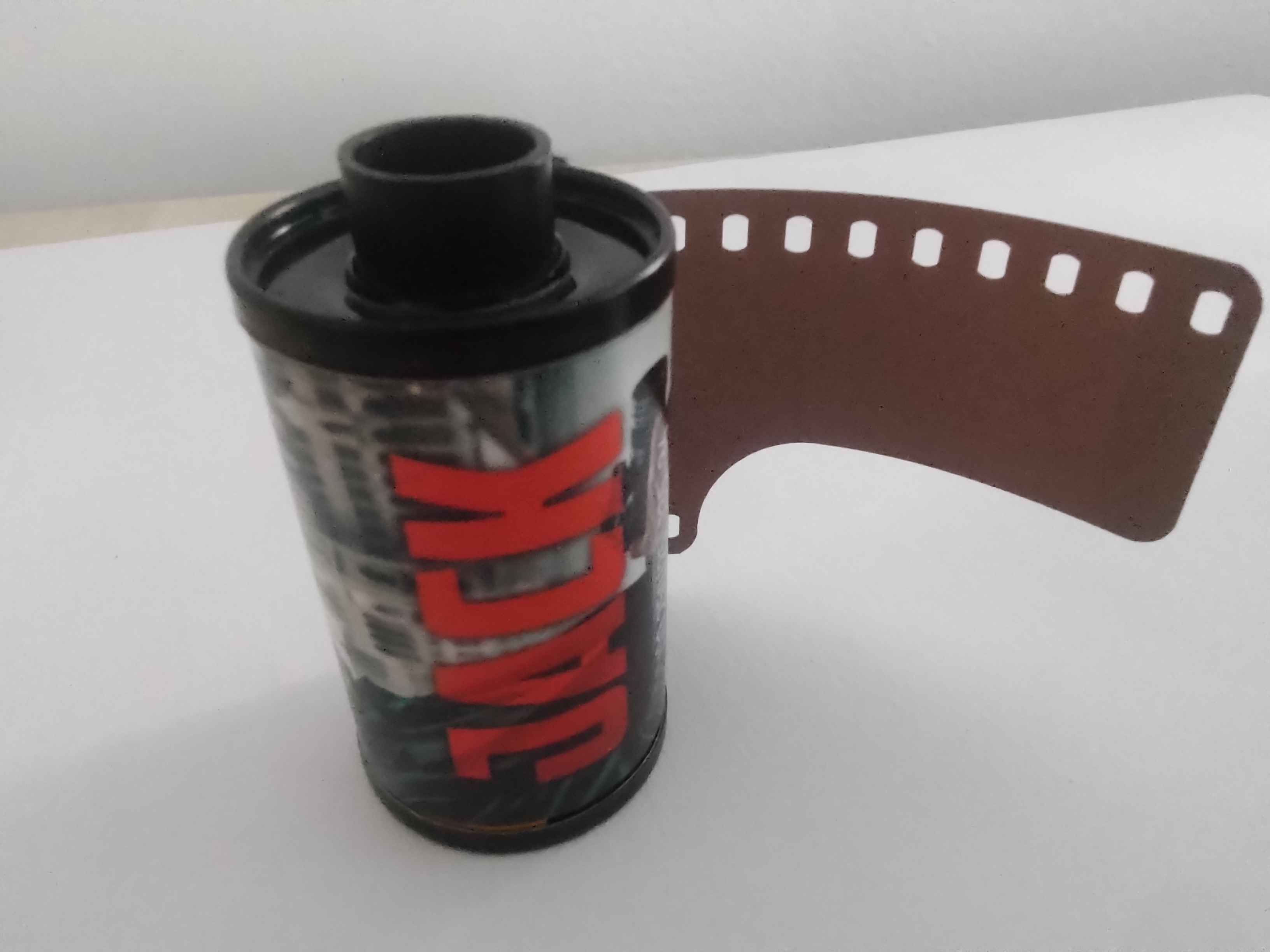

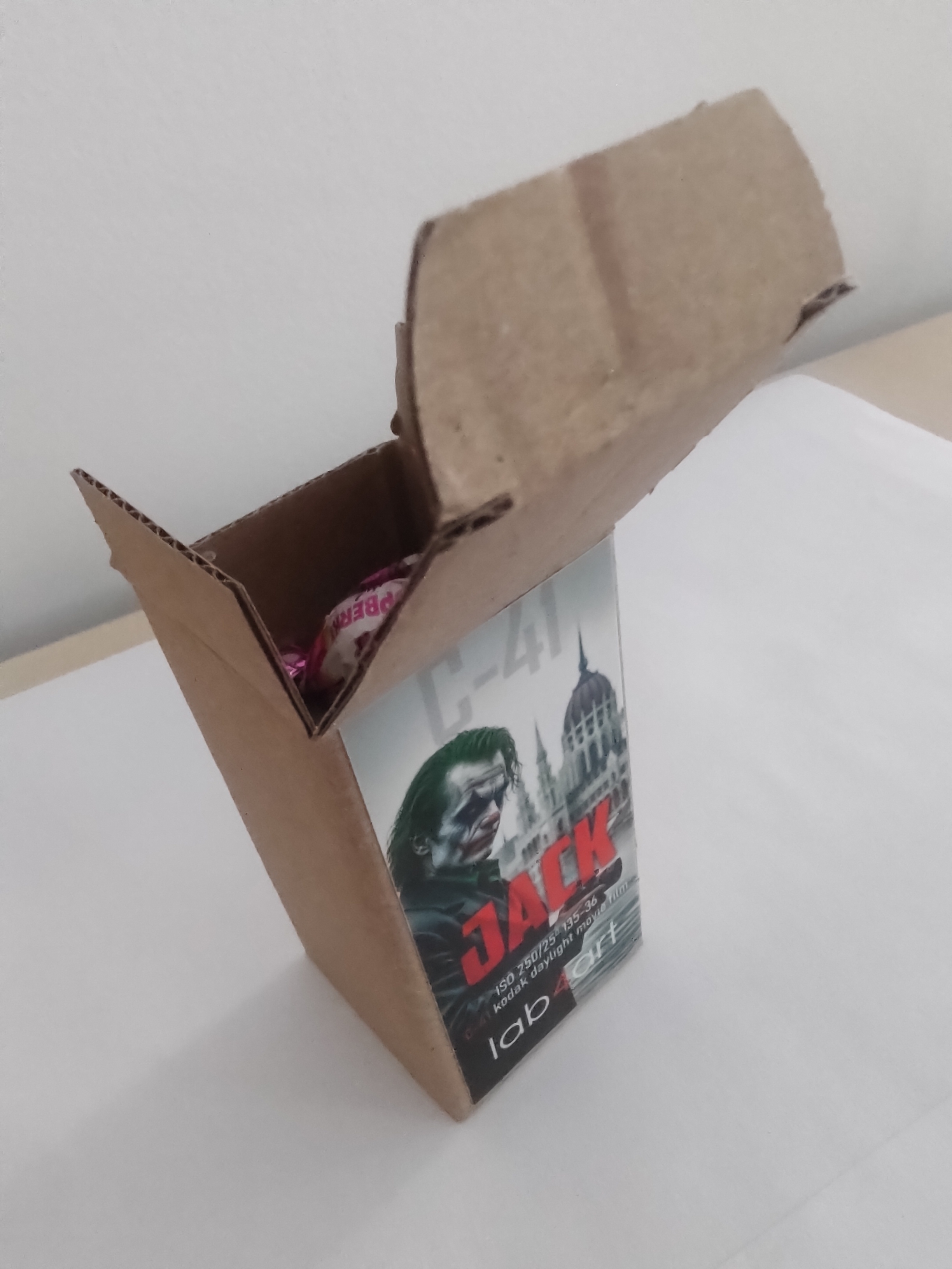

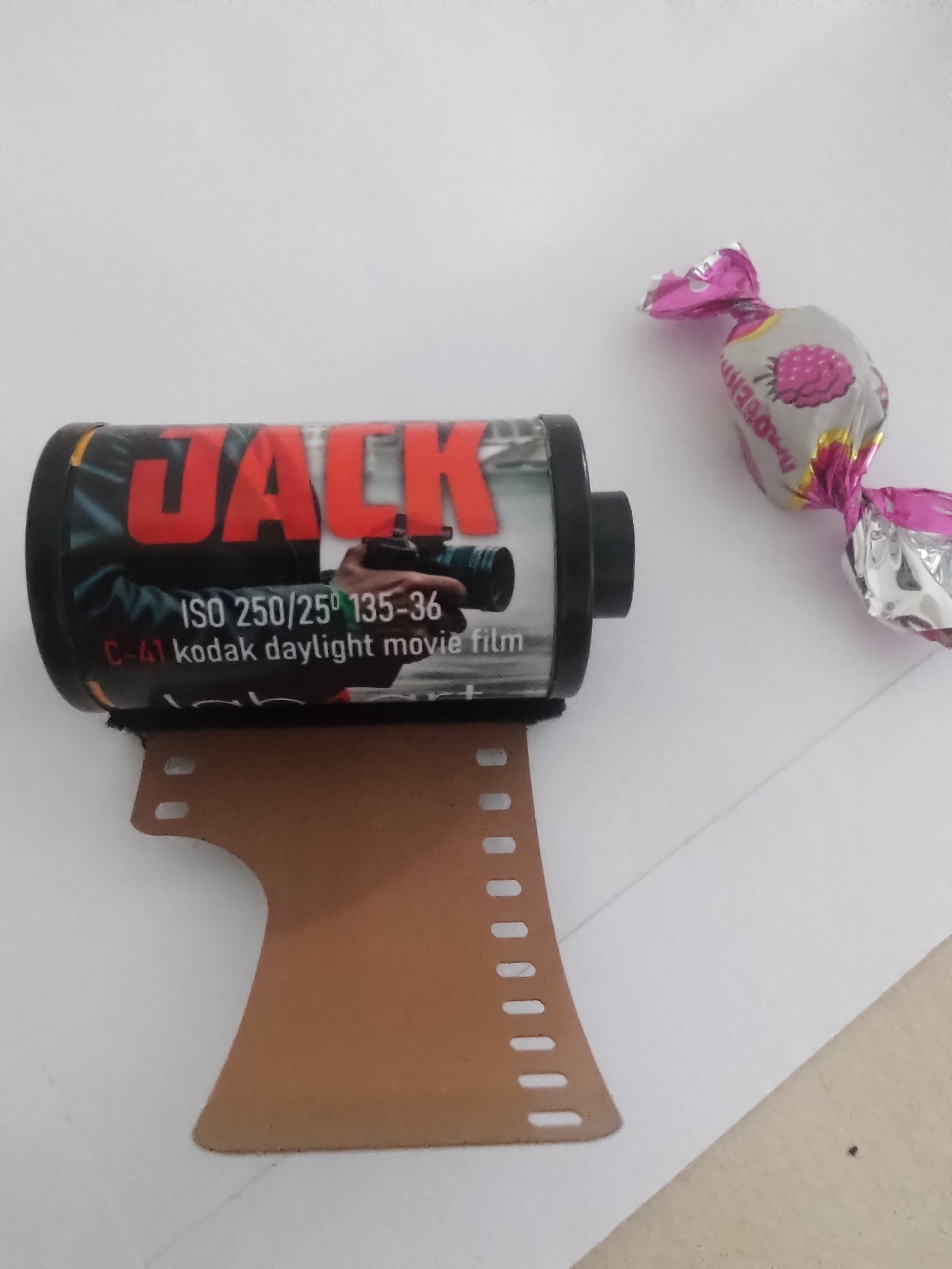

Hi,
Just want to let you know that this new version is already on sale in Budapest. Lab4Art gets it directly from Kodak and it is available as 250D and 500T. I haven't shot my first roll yet, but it is the most affordable color film you can get here.
The price is really good. 3,300 HUF per roll, which is about 8.30 euros. I'm curious if they'd be willing to send me 15-20 rolls to Poland and how much shipping would cost. I'll have to email them. @Fortepun Thank you for the info!

Kodak are understood to be testing with trade users new vision 3 films for motion picture without a remjet layer , replaced by a standard ahu which would also makes it easier to process for still photography. This is distinct from vision 3 without remjet made for cinestill with halation effects. The below is understood to be a briefing note for the new films but is not ‘publicly’ available yet, posted by memorylabfilm in australia.
