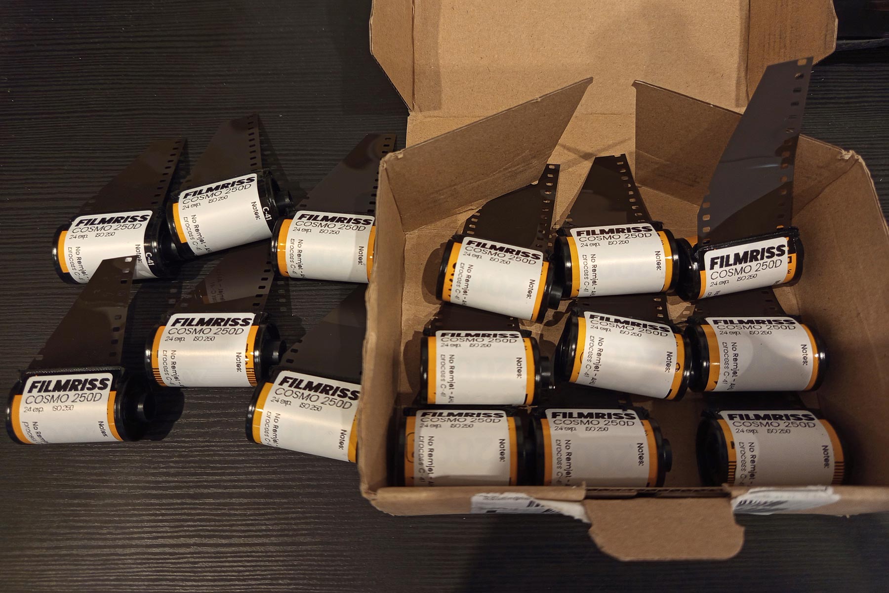

I confirm that I received my parcel from FILMRISS today.
So these guys are legit. ๐Ÿ˜€๐Ÿ‘
