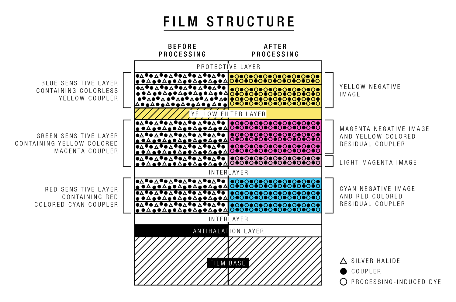

Without a doubt, putting AHU in the layers has a number of advantages, but it will also probably make the process more expensive.
No idea about the price, but AHU is most likely going to make cross-processing in B&W developers futile if a silver-based AHU layer is present as mentioned here:
Vision3 films and 250D in particular give excellent results when cross-processed in B&W developers and are cheaper than most B&W films in the local market. AHU is likely to change all of this. :smile:

The only downside I can see is that some people like halation, which is evident in V3 stocks with the remjet removed. This option will presumably no longer be available if all V3 production changes to the new version. When I've used still films such as Candido 800 (V3 500T with the remjet removed) I don't mind the halation but it's not something I specifically am trying to achieve. I just hope to be able to obtain the film in the future.
Might make me more likely to learn to process it at home, and the lab I use for cine film processing is a small one so perhaps it will help them too. Mind you, having just obtained the 2x50 foot Lomo tank, I am in a position to process a lot more cine film than when I only had the 30 foot tank....
My understanding is that in the early days, Cinestill was buying Vision3 with remjet, removing the remjet themselves, and then drying and packaging the film for retail.
I suppose it's possible that the new antihalation layer could be washed off of unexposed film, then the film dried, and loaded back into a cassette to shoot. Guess it depends how far you're willing to go for those fluorescent gas station sign photos :wink:
On 35mm film the antihalation package is typically not a 'layer' as such. It can be as simple as a colored base with the dyes incorporated into the base acting as anti-halation measure; this is the case in many B&W 35mm products. These dyes cannot physically be washed out of the base - they're in there forever. There may or may not be additional dyes in the gelatin emulsion that may wash out; whether this would be the case on this new Vision3 product I couldn't say, nor could I say to what extent attempts at washing out such dyes before exposure would have an impact on halation performance.
As a point of clarification most consumer color films have the AHU on the same side of and nearest to the base below the emulsion layers. (Cine film has a remjet layer on the reverse side.) In that case, washing out a conventional AHU layer is not likely. Of course it's possible that the AHU could be coated where the remjet currently is, but that sounds like a lot of R&D effort to get the same results as remjet and doesn't help with production simplification.
