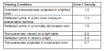

You might recall the preferred tone reproduction curves in the Holm example. A projected transparency needs to be more contrasty than one on a light table. I believe this is surround. The determination of Munsell's 18% and CIE's 19.77% were determined under very strict conditions. Ones that normally won't be encountered in real life. Viewing conditions is an important, yet frequently overlooked, aspect of photography.
This is from Holm.
Back to meter calibration and image placement. This is from Holm which I've posted before, but it's a key piece of information.
"That the luminance range of a statistically average scene is 160:1 (log range 2.2), and the resulting exposure range on the image capture medium is 80:1 (log range 1.9), corresponding to a camera flare factor of 2.

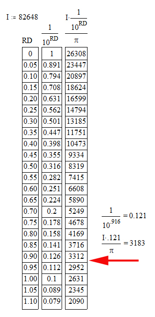

Maybe this will help. It uses the exposure meter calibration Illuminance value and reflectance values down to 8%. Where does the exposure meter calibration Luminance value fall?
This is from Holm.
I don't understand the first and third column, and the general meaning of this table. My fault, I know.
But I understand that the middle column is the reflectivity of a target.
So the calibration is on the line with 0.178 I would say.
First column is reflection density and the 3rd column is Luminance. The calibration Luminance for the exposure meter standard is where the red arrow is.
But, again, I'm not an engineer designing light meters. What matters to me is that Mr Minolta tells me that his light meters give me an exposure = LogH -1.0 (he means with ISO 100) and he tells me that in the e-mail to RobC.
For ISO 100 Hg is -1.0.
That's the exposure for 100 speed reversal color film - 10 / 100 = 0.10 lxs
I suppose you mean:
Exposure meter standards want the device to be calibrated with a Luminance of 3.183 (cd/m2?).
That, in that table, corresponds to a reflectivity of 12.1%.
Ergo: Light meters calibrated according to this standard are calibrated for an average reflectivity of 12.1%.

Besides, there is something I don't understand.
How can a calibration Luminance be directly correlated to a certain reflectivity, as the table does.
There certainly are a lot of other variables that must be populated before you arrive, in a calibration process, from a certain Luminance used in calibration, to a certain density. A relation must be defined somewhere!
