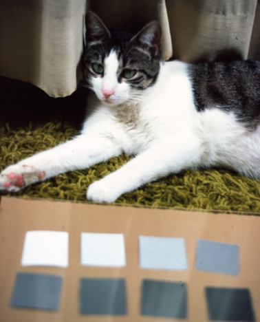

We introduce now a new measure of light (luminance and illuminance) and we call it Minnie.
The incident light meter measures a certain scene over an 72% white cat and it is 100 Minnies.
You set your camera according to the relative exposure of the incident reading, and the cat comes out correctly 72% white (because it will reflect, toward your camera, 72 Minnies).
You measure the cat with the reflected light meter.
Result is: 72 Minnies.
The lightmeter doesn't know the cat is white. The lightmeter thinks all the world to be of grey with reflective coefficient k.
Le'ts say k is 0.18, 4 times less reflective than the white cat.
The lightmeter sees: 72 = 0.18 X -> X = 400 Minnies.
The lightmeter will give you the exposure as if the 72 Minnies were four times more light reflected by a four times less reflective cat, than real. He will close 2 EV more than appropriate. You will have a cat which is 4 times less reflective on slide than real. That is, you will get an 18% grey cat. But the cat is white.
If the cat is actually 0.18, and he receives 100 Minnies, he will reflect 18 Minnies.
The lightmeter sees: 18 = 0.18X -> X = 100 Minnies.
The lightmeter will give you the right exposure (because actually 100 Minnies are falling on the cat) and you will get the right shade of grey.
By this time, you ask the manufacturer why your white cat, and your black cat, always come out all grey cats. He must tell you the value of k. He cannot tell you that light meter does not measure reflectance. They assume a certain reflectance.

And the demonstration of this is that if you use your TTL meter to meter a white cat in the snow you obtain, with slides, a grey cat on grey snow with absolute certainty. Find some snow, a white cat, and do the test! (so that you are content :whistling:).
The cat will be grey, and the snow will be grey, no matter how much light you throw through the slide!
Once you tested this, ask yourself why you obtain a grey cat and a grey snow.
Do the same test with a black cat on a bunch of very black coal. You will obtain on your slide a grey cat on some grey stuff. Absolutely and invariably. Try that!
Now try that with different shades of cat and material. I know, it's a bit boring, but you must test it.
You must arrive to a certain shade of cat and material which is correctly rendered! More or less halfway between the two extremes there is ONE cat exactly rendered. Only ONE.
You then put the cat on the densitometer, turn the light on, and the reflectivity of the cat will tell you k sperimentally!
