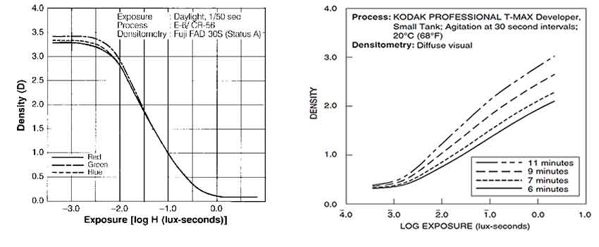

all a meter can do is make an adjust based on the assumption that either its starting from zero or the speedpoint or the reading it gets in cd/m2, it can't magically know how long the curve is for any particular film is unless you meter the darkest point and the lightest point and average them.
But the middle film density will still be dependant on the steepness of its slope which varies with each film type. So that doesn't get you where you want to be unless you calibrate for it. Sure you can get it in the middle of the curve by averaging which will give a decent expsoure but not an exact colour match unless you force it in reproduction.
No it doesn't move the curve left or right, it shifts the point up or down the curve dependant on the curve slope which are very different for slide and neg films. a 3 stop adjustment on a steep curve will place the film density at a different value than a 3 stop adjustment on a shallower curve.
ISO prescribes that the film be correctly developed so that the slope curve to be obtained is fixed. Given an A point of 0.1 density, the density point corresponding to a higher exposure of 1.3 LogH must be 0.80 more than density at point A, with a small tolerance of 0.05 on both sides. That means ISO defines pretty exactly the slope of the characteristic curve (for negatives, at least, but I do believe also for slides).
If that was not the case, we would have films that increase (or decrease) tonal relations thus giving us a very unnatural, and unexpected rendering of the scene.
No, the light meter never starts from zero the way you think it. The ISO speed determination starts from point M but don't be mislead by that. The lightmeter gives you Hm which is the exposure creating middle grey on your ISO film. What "magically" tells the light meter where middle grey is, is the ISO speed that you plug in it (plus the K constant which is an "adjusting factor" that the maker plugs in it).
The fact that ISO is determined, for negative films, on the shadows leads you and somebody else :whistling: to view the exposure data as something that is calculated by the lightmeter from the shadows, from the "speed point".
The speed point is used for the ISO speed determination, and there its function ends;
The ISO speed determination is used to determine Hg which creates the normal exposure for the average 18% cat with a reflected light meter, as Mr. Minolta says. And that both for slides and for negatives.

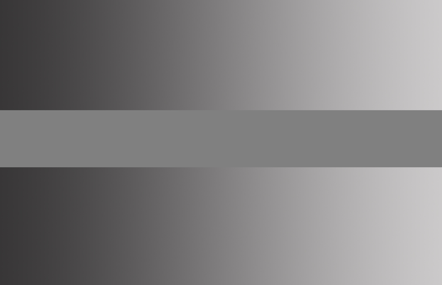

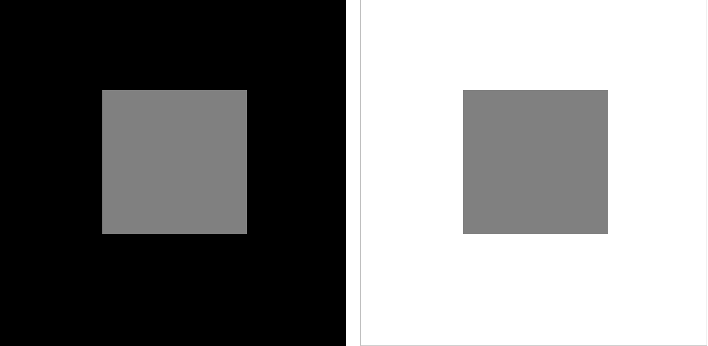

The eye adapts to changes in illumination, but there are other factors involved like surround, local adaptation, and simultaneous contrast. The Theory of the Photographic Process 3rd edition has a very nice section on perception and subjective tone reproduction. It's a good but difficult read.
Here's an example of simultaneous contrast. The gray bar is a single tone against a gradient background.
And another example
For a quick experiment, take a transparency (larger format the better). Place it in the middle of a light box. Note how it looks, then quickly place a mask around the transparency. It will look different.
And another example
Yes, but that belongs to the quirks of human vision and brain reconstruction of reality.
This link shows other things like False colour (the eye sees colours that don't exist in the image) and Mach Bands (your eyes sees shades of grey that don't exist in reality)

Normally though we don't see images of grey squares in white squares. In normal average images (of cats :whistling:) we see a "complex" scene, with a black point, a white point, and a grey point in the middle. That's true for 99% of images, I reckon.
the slope of slides and negatives is different as far as I'm concerned. Here is direct comparison of provia against tri-x. the kodak trix chart has been scaled to match the spacing of the provia. ie the spacing of density and exposure show the same size grid and values. Clearly the tri-x gives a much shallowr curve than the provia. You can take the range of exposure across the straight line portion of both curves and divide it into the density range that the exposure range covers and get the films Contrast index.
The provia gives approx 1.6 and the TRI-X gives approx 0.55. Clearly the slope is very different and therefore exposure needs to be calibrated to find the middle film density depending on its slope. We know B&W film requires a film density range 1.3log. provia goes all the way upto well over 2.0log The middle of those curves is obviosuly going to be a different density. Does the exposure required to hit the middle of the two curves differ? Well simply looking at the charts I think we can say yes. If the slide film accepts 6 stops of SBR the middle of curve will be approx 3 stop adjustment from either end. If neg film accepts 7 1/3 stops then middle of curve will be approx 3 2/3 adjustment from either end. They are different but the meter doesn't know that so how can it know how much to offset for all types of film? It doesn't. Its only calibrated to one curve which doesn't fit all. You must calibrate exposure if you want accuracy.
This link shows other things like False colour (the eye sees colours that don't exist in the image) and Mach Bands (your eyes sees edges that don't exist in reality)
We don't see just the image, we see the frame, matting, wall, ...

For negative film, the exposure latitude is way bigger on the right side (highlight side, higher density) than on the lower side (shadows) of the curve. So for negatives the Hg is "further away" from the middle of the curve.
That's why it is important to understand where Hg sits on the characteristic curve.
The exposure your lightmeter gives you is always a certain POINT in the characteristic curve (Hg) where g means, I suppose, grey. When you modify the exposure you place the metered spot at a certain offset, along the LogH axis, from that point.
