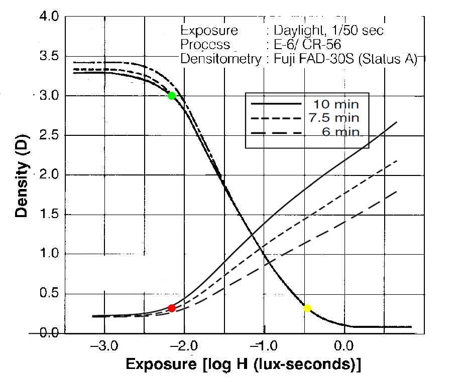

Copy this chart and mark on it where you think the speed point is and where you think the exposure will be placed (regardless of what is being metered) and post your guesstimate.
Anyone can try as well and we can see how thick the mud is or if there is a concensus.
You have all the formulas being banded around so them so lets see if you can actaully use them to show what you think they will show.

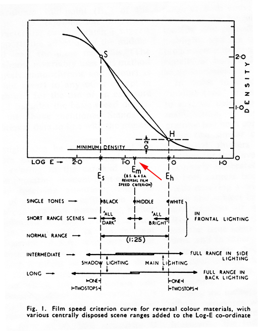

You find the equations for slide film in Conrad, abovementioned, page 12.
In short, Hg = 0.91 Hm (If I get it right, Conrad calls Hm the speed point).
So as you see the speed point is at 0.14 EV less exposure than speed point.
But you don't care where speed point is with slides, you only care where Hg is, which is the mid-tone exposure the light meter will create on your slide if you follow it "blindly". And you care what "grey point" that corresponds to, which is a tone that will be recognised as a 18% reflectance grey or, if you prefer, center of zone V. (that assume standard development, and normal conditions of vision).
You want to place that white china mug in zone VII? You meter it, you obtain a value (which is always LogHg = -1.0 for ISO 100) and you open 2 EV more (LogHchina mug = -0.4 for 100 ISO).
Remember that with B&W you place your SBR starting from the shadows, at a point which is more or less near speed point, and you "unroll it" toward mid tones and high tones.
With slides if the SBR is high you peg a highlight that must be preserved and well rendered, you place it (2 EV, 2.5 EV, depends on the curve, on the detail, on the image, on the shadows that you need to salvage etc.) and then the SBR will "unroll itself" toward mid-tones and shadows.
This point where you peg your highlight has nothing to do with speed point of a slide film. The highlight is pegged in the highlights, while the speedpoint is the midtones, and very near target grey.
The characteristic curve is quite different and the speed point is calculated in a very different way with slides than with B&W.
here's a little graph for you to help you think about it. I have correctly scaled and overlaid the curve for Kodak T-Max 100 onto the fuji provia 100 curve and marked 3 points 1 of which must be the speed point for provia 100 I think. The red point is the approx speed point for T-Max 100 I think. So do you think the green or the yellow points are the speed point for provia or do you think its somewhere else?
Note: The kodak dev was D76 and the dev time kodak recommend as normal is 6 1/2 minutes so youcan guesstimate where the curves cross. The dev times box is from T-Max 100.
And note that assumming the red and green are the speed points for the two films, then the adjust from speed point would be 4EV and not 3 as I calculated. Please explain that.
And given that a kodak grey card is 2 1/2 stops less than than 100% please explain why -1.0logH is 3 1/3 stops from 100% transmittance. Have you considered that a colour in a slide does not equate via some formula to a density so that 18% grey has no relationship to slide density at all? You can only measure the slide density when you know its an 18% subject reflectance and find out what it is. You can't calculate it.
So once again you must calibrate your exposure if you want it on any specific density or colour. Density only relates to light and dark and not colour unless you are measuring using a colour desitometer which you ain't (so far). And your meter is clueless about colour. It only knows about relative luminance and not colour.
The red point is probably right. That's a possible speed point for a B&W negative film I imagine.
As you see, for normal development you end up, for light meter recommendation, which is LogH -1.0, with a density of 1, which is where you also find slide density. That might not be a coincidence, but I cannot say I know why. Maybe LogD = 1 is something people at ISO tend to see as middle grey after all. In any case, the target grey is determined by exposure, not by density. Density is the "byproduct" of it. Obviously there is a relation between the two.
Green point is at the beginning of the shoulder and is the point where you might want to place some deep shadows, something like zone I, being around -1.3 LogH darker than target grey point. Last usable shadow (with serious texture) is probably around LogH -2.0 but one should experiment.
Yellow point is around 2 EV above grey point. That's white region. You could place there some china pottery, some porcelain etc.

The way b&w and reversal color both work with the same exposure meter is by using the speed constant and knowing the relationship between the speed point and Hg. Like I've written multiple times.
Fabrizio said he wasn't that familiar with B&W. The ratio between Hm and Hg is 1.0 or 10 times or 3 1/3 stops. The average shadow falls approximate one stop below that or 4 1/3 stops (1.30) from Hg. I posted a graph that illustrates how the average scene falls, as well as shown the math, as well as made papers available that explain it.
Now I see. I thought the speed point for B&§W film was the darkest useable part of the film. I see from the graph at page 9, #205, that one can place a shadow point to the left of the speed point.
So the speed point is always 3.3 EV lower exposure that middle grey point for negative film.
Considering that LogHg always is -1.0, LogHm should always be -2.0, or 3 and 1/3 EV below it.

I am used to see a LogH lux-seconds scale with -1.0 corresponding to "statistical average scene and equivalent grey calibration surface for photoelectric reflected-light meters", correspondig because Minolta places that grey at LogH = -1.0.
In the graphic by Dunn I can't interpret the X axis, going from 0 to 2.2 and market as Relative Log exposure.
10/Hm = Reversal Speed
10/100 = 0.10 lxs
Relative log helps when determining the scene luminance range. 2.20 is 7 1/3 stops.
if it makes it any easier and less agricultural for you,
0.10 lxs = EV -4.6438
