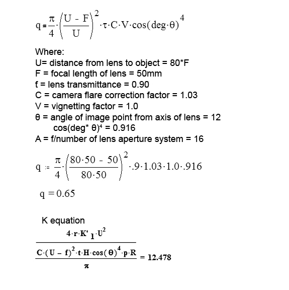

For negative colour film, the speed equation is:
ISO = square root of 2 / Hm. We derive Hm = square root of 2 / ISO.
For an ISO 100 film, Hm = 0.014142.
Now we have the speed point and we must calculate the grey point, Hg.
Hg can be derived from Hm by applying a derivation factor which is [(b * K) / square root of 2].
Conrad uses b = 0.728 and K = 12.5. I will also use K = 14 for comparison.
With K = 12.5 the derivation factor is 6.505382. So Hg is 0.091999 and LogHg is -1.03622.
With K = 14 the derivation factor is 7.206832. So Hg is 0.101919 and LogHg is -0.99174.
The two values are certainly very close apart (we already know they are 1/6 EV) and, as far as the K = 14 is concerned, the value of Hg coincides very nicely with the Hg already derived for slide film, which was -0.99174, absolutely identical!
So the Minolta lightmeter, using K = 14, gives us a result that, for the corresponding shade of grey (18%, actually 17.6%), is the proper one and exactly the same whether we use slide film or negatives.
I wait a confirmation from Stephan that, finally, at last, I applied the speed equations and the derivation of Hg well. (Connolly was confusing, Conrad is better).
The last point remains, in my opinion, to be discussed, and that is how a reflected light meter is bound to be calibrated to a certain shade of grey, chosen by the manufacturer, through the arbitrary factor K.
(To those who say there is no reflected light in the exposure equation, I would shortly answer: there is, and is K, which is chosen after some empirical tests, in order to determine which K matches in a visually satisfactorily way... that certain shade of grey i.e. that certain reflectivity).
Fabrizio,
For me, the best way to understand how the process is supposed to work is to use the statistical average values. I like to call this the standard model. There are variations which are just as valid, but they should be left until later. It’s also important to understand the theory behind the numbers otherwise there’s nothing to keep you from using unrealistic or misleading values.
Conrad’s value for b (which is q in most equations) is 0.728. The value most associated with q is 0.65. The difference is that Conrad a subject on the lens axis. The standard assumes 12 degrees off axis. The center of the lens is the brightest point and the light falls off as you move toward the outer part of the lens. The use of 12 degrees is for an average value for the lens.
The same standard model principle should be applied to the meter. The calibration values is what is determined as the goal. Too many people mix and match values of K and C until they match a predetermined outcome. My Pentax digital spot meter isn’t going to suddenly change what it reads just because a Sekonic incident meter is in the vicinity.
I’ve explained this point a few times, but a different value of K does not mean there is a different level of exposure at the film plane. A K= 14 also doesn’t necessarily mean it will produce an Ev value different than at K = 12.5. There are two primary reasons for a value of K to be different than 12.5: consideration for zoom lenses with a lower transmission value and spectral sensitivity of the exposure meter’s photo-cell. Remember how Allen Stimson explained how the value of K in the 1961 standard changed because the color temperature of the calibration source changed from 2700k to 4700k. A photo-cell that is under or over sensitive to the calibration color temperature will be off-set by a different value of K.
For a K = 14 that is derived from a compensation for a perceived lower lens transmission, the exposure will suggest a setting that will produce more light entering the lens, but not striking the film. The idea of what Hg should be for a given film speed is fixed. The exposure meter's purpose is to determine a camera setting that will produce that value.
I believe you wrote somewhere that K is arbitrary. You might be thinking of K1 in standard’s equation for K. Connelly uses P for the exposure constant, which is the same as K1. P is the arbitrary chosen value, but in this use, arbitrary just means that it isn’t a physical constant. It was determined through psychophysical testing to determine the most acceptable value.
Stephen
Mmmmh, yes. K for me sometimes, and wrongly, was the "overall adjusting factor" that will make, after examination by a sufficiently large number of people, the best conversion from metered light reflected by the subject to an exposure value to be set in the camera. I have no problem in calling it K1 or P.
I gave for granted, so far, that the world at large considered b (q) as something fixed, and that all the adjustement due to the statistical observation by the sufficiently large number of people was meant to derive a K that gave the best result (the best match between light measured and exposure). If b (q) is a calculated factor, the result of an equation, and not something that is the result of statistical analysis, I thought, then the variation due to the result of statistical perception must end up "all in K" and the b*K in Conrad would end up being:
b fixed, result of an equation, something calculated;
K derived through empirical observation of perceived best matching result, something "observed" with statistical analysis.
But one might say that the result of the statistical observation ends up to influence both b and K. So it is their product, b*K, which is the result of observation, the overall matching factor.
No problem with that (although one would ask why so much theory about calculating b. In the end, is the observed b*K that would matter, not b nor K, and one would also ask why light meter producers give a figure for K and not for b!). But we should now ask Mr. Minolta what does he call K (which is = 14) in his answer to RobC's question and in the instruction booklet.
I suspect that Mr. Minolta calls K what Conrad calls K (different from what I called K, but same if we keep b as exogenous, calculated) and in that case I suspect that also for Mr. Minolta what Conrad calls b must be the same value as in Conrad, because Mr. Minolta tells us that his exposure always gives Hg = 0.1.
We should keep in mind that when Mr. Minolta tells us, that is:
1) He uses K = 14
2) His light meters give to LogHg a value of -1.0
3) He calibrates his light meter for a mid-tone of 18%
he tells us a lot of stuff.
The three elements all seem to nicely sum up if b = 0.728 (just like in Conrad), K = 14 (K as in Conrad) and mid-tone is 18% because that gives a LogHg a value of -1.0 both for slide and for negatives.
(If, instead, Mr. Minolta called K what Conrad calls b*K, then he wouldn't be true when he tells us that his instruments create a density of 0.1 on film).
They also sum up if we consider that these values create on the film the exact same exposure that an incident light meter with a flat disk and a C = 250 would give (following the logic given by Conrad, not that I approve of his considerations immediately after that).
Of course the same value of K, or of K*b, or of (K*b)/10, or the same value of whatever the "overal adjusting factor is", would be obtained by a reflected light meter producer also if incident light meters never had come to existance, and also if the C calibration factor never had been conceived by human mind.
The reflected light meter producer would arrive to the same conclusion, the same calibration, by the sole statistical analysis of best perceived match between reflected light and exposure values.
On the other hand, an incident light meter producer would arrive to a calibration of its incident meter by statistical observation of the best match between incident light and exposure value, even if reflected light meters never had been invented.
But, if the sample of people is significative and well chosen, the two sets of observations must converge toward the same result. Human vision is the same when it observes pictures, it doesn't know if the light metering was made with incident or reflected light meters.

Fabrizio,
There's a relationship between the constants, P, q, and K. P/q = K. We can also use it as K*q = P. For K = 14 and q = 0.72, P would have to equal 10 and that wouldn't work with b&w. Also, why adjust the reversal speed constant if the value of P is also going to change?
As for the equation for q, most of the same variables are also in the equation for K. Add L/A2 to the equation and you have the long version of the exposure equation.
