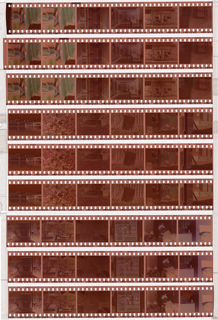

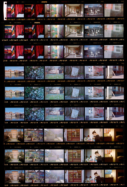

I shot a comparison of Kodak (Alaris) Pro Image, and Kodak (Eastman) Kodacolor 100 today. Grey Card and Macbeth charts, same camera, lens, in daylight. Processed in the same tank, printed together on some of the Endura I do most of my work prints and testing on.
Based on my results, I think they're different.
I wonder how much batch variation are we seeing when comparing Kodacolor/ProImage/Lomo CN 100...?
My test of them, side-by-side (Kodacolor 100 and Lomo CN 100 were shot with the same lens, ProImage 100 was not but I wouldn't say that the lens has a different colour rendering (both lenses are fairly modern).
Top: Lomography Color Negative 100
Middle: Kodak Kodacolor 100
Bottom: Kodak ProImage 100
This time, differences between Lomo CN 100 and ProImage 100 are less than in my previous test and differences between Kodacolor 100 and ProImage 100 show basically the same as @Aidan Sciortino's. It does seem that Kodakcolor 100 is neither ProImage 100 neither what is sold as Lomo CN 100.

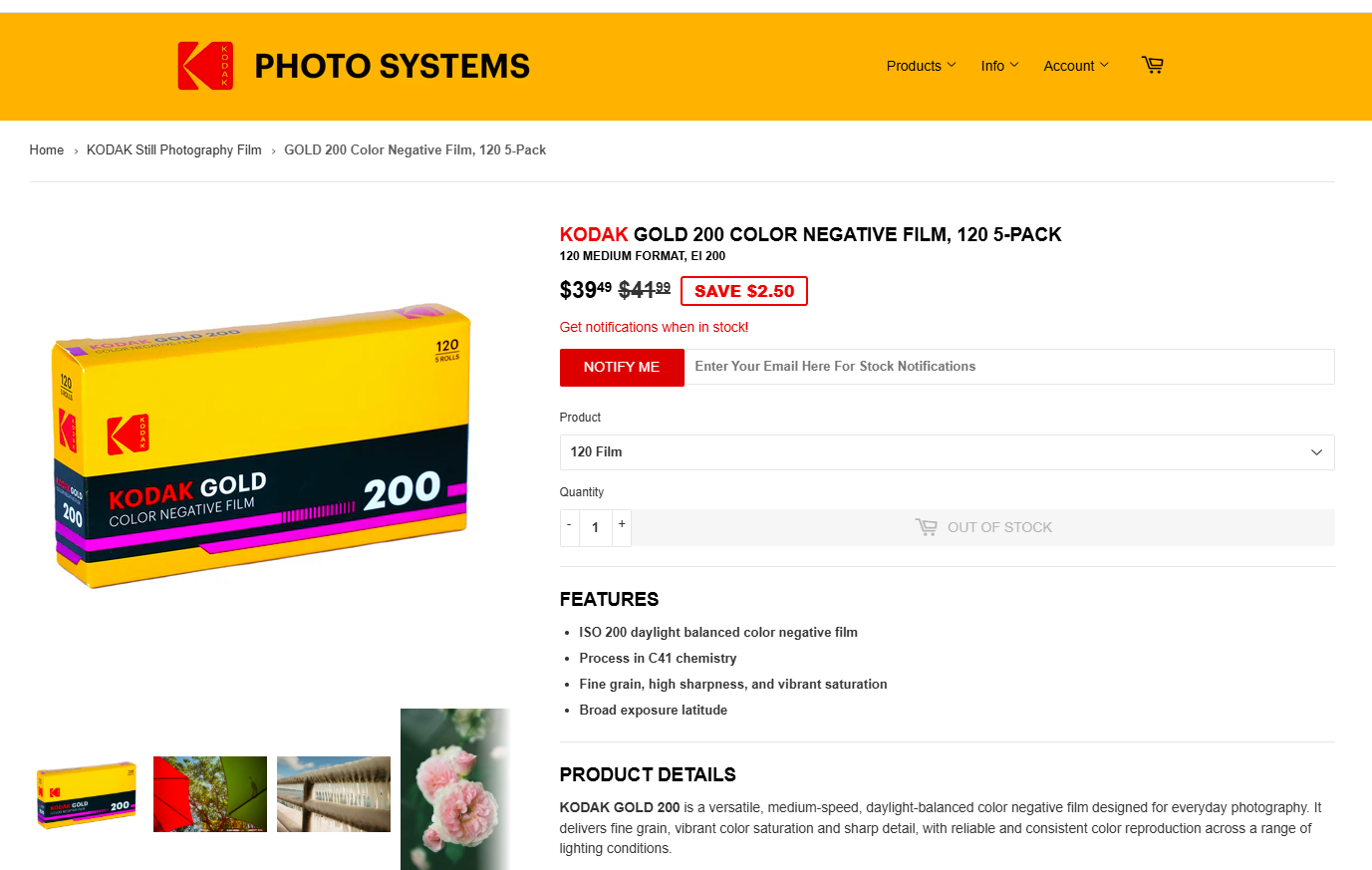

Looks like Gold 200 in 120 is on its way as well - from Photo System's website (operated for them by their distributor, Cinestill):
They also have the 35mm versions of Kodacolor and UltraMax: https://kodak.photosys.com/collections/eastman-kodak-still-film
