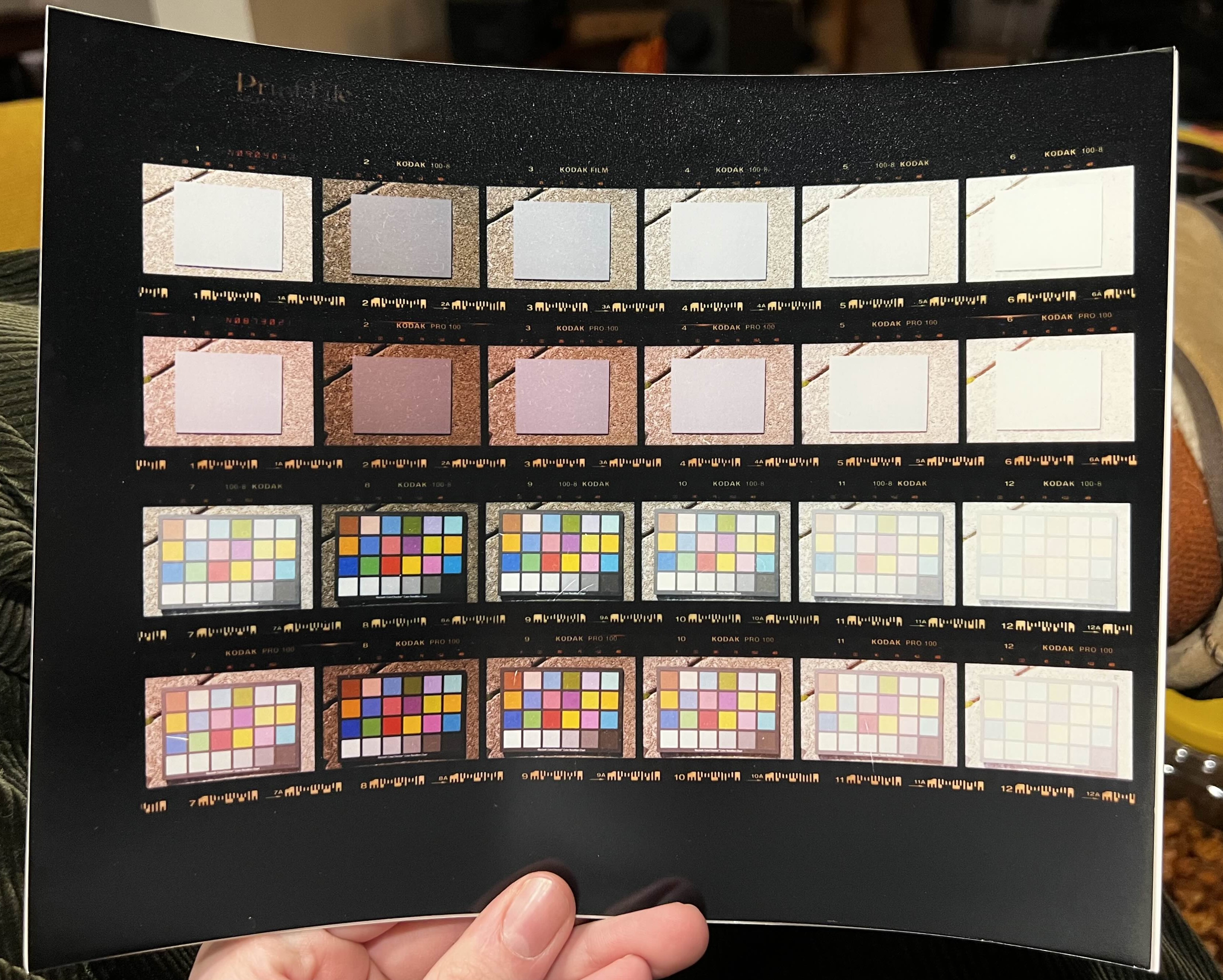

I shot a comparison of Kodak (Alaris) Pro Image, and Kodak (Eastman) Kodacolor 100 today. Grey Card and Macbeth charts, same camera, lens, in daylight. Processed in the same tank, printed together on some of the Endura I do most of my work prints and testing on.
Based on my results, I think they're different.

@Aidan Sciortino, thanks for doing this!
Your comparison shows differences in same direction as my comparison of Lomography CN 100 and ProImage 100 that I posted here on Photrio a while ago (same lens, same development, scanned in one go):
So, the new Kodacolor 100 is closer to Lomography CN 100 than ProImage 100 (if not the same).

Wonderful job testing it! This, along with the fact that Kodacolor should be refrigerated, should end any speculation about it being ProImage. I've never tried Lomo CN100 but it makes sense to me that this is the same (or related) formulation.

Thanks @Aidan Sciortino and @brbo We’re pretty good at reverse engineering here at Photrio 😃

Erm, just realised that my comparison between ProImage 100 and Lomo CN 100 had the ProImage 100 as leaning to cyan and Lomo 100 to magenta (when using the same filtration), but @Aidan Sciortino has Kodakcolor 100 as the cooler one compared to ProImage 100. So, Kodakcolor 100 compared to Lomo 100 should show even bigger difference. Huh!
Well, high time that I make my Kodacolor 100 vs Lomo CN 100 comparison. I have Kodacolor 100 and should have Lomo CN 100 in a day or two...

I also came to that conclusion in the videos I posted a month ago. No one seemed to care much though. Would you say that Kodacolor 100 is Lomo 100 (Kodak VR Plus 100)? This is what I was thinking by the end of my testing, but wasnt 100 percent sure.
I haven’t had a chance to test Lomo. Could you link your video? I would like to watch it.
