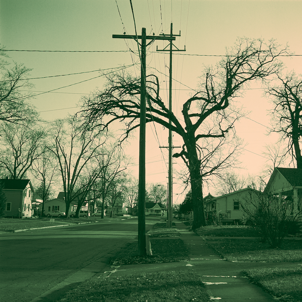

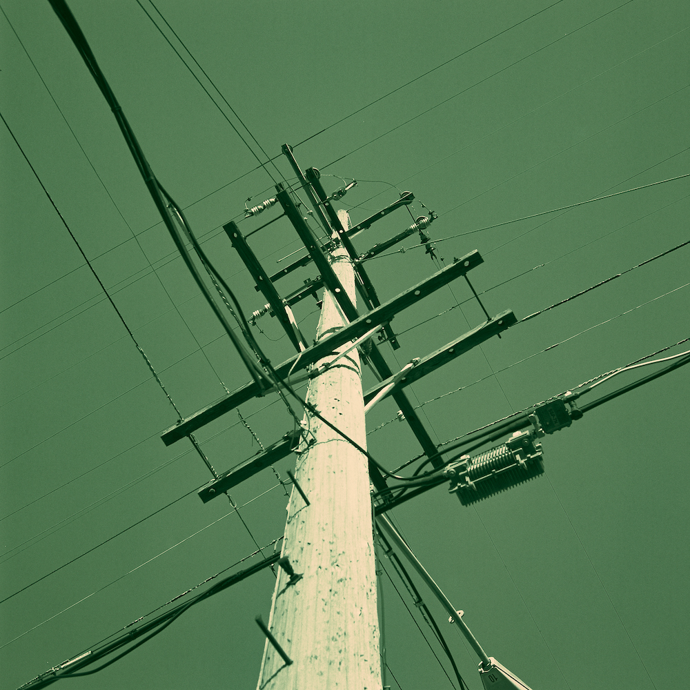

Sometime last year, I formulated a question: what would happen if I cross processed a chromogenic bw film in e6? so sometime last summer I got myself an xp2 super, shot it at iso 100, had it pushed two stops, and here was the result:

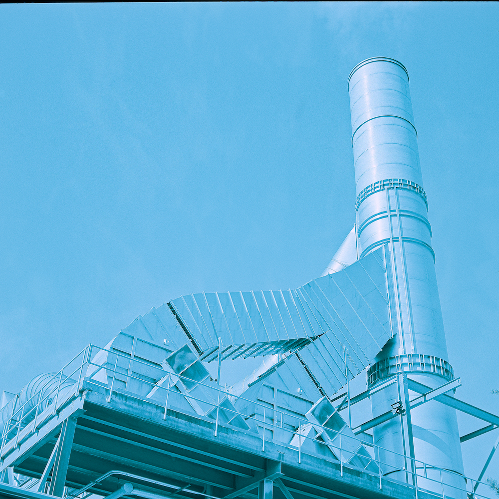

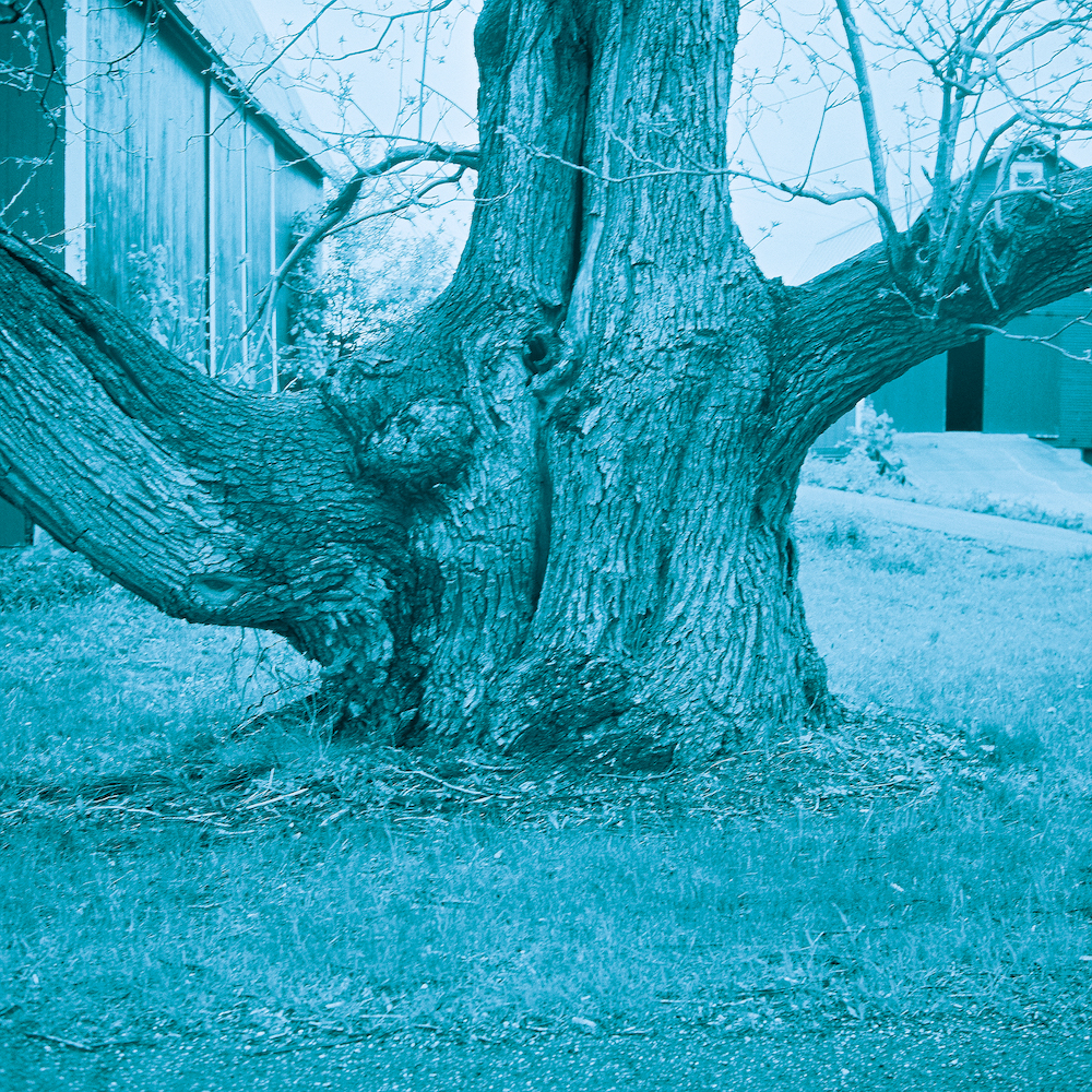

Then, sometime late December/ early January, I tried it again with a 2011 expired Kodak BW400CN. The results were in fact quite different, ISO 80, pushed two stops:

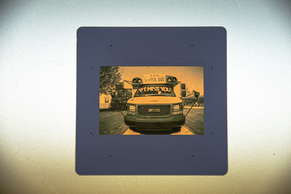

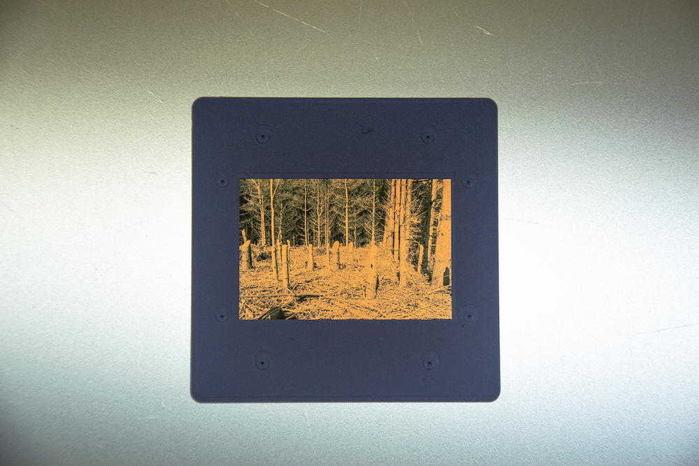

I recently crossed a Kodak BW+ (aka Kodak BWTCN 400), but don't have scans yet. If you're willing to wait until Thursday, I can get some digital shots of the slides. it's definitely my favorite cross process so far.
Interesting result! The colour cast is something one has to live with when XP2 Super is processed in colour chemistry to produce dye-based slides. IIRC @thuggins also observed cyan cast when he cross-processed XP2 Super to produce slides.
FWIW XP2 Super gives better looking slides if it is treated like a B&W film and reversal processed for silver-based B&W slides.
wait until I show you the bw+, it's a mix of greys and the orange base.
XP2 Super and orange base? That's interesting! Can you share some pics?
Might have misread,The orange based cross processed film Kodak Black and White plus. I can't share any images until thursday, as I don't have access to a scanner right now, but I can take some close ups of the slides when I go to the camera store. It should be worth the wait though.
