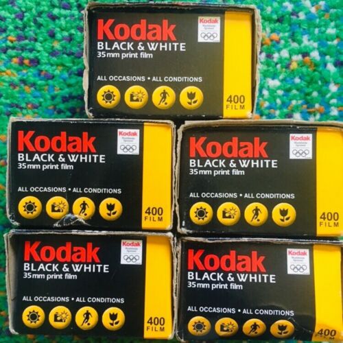

So, I've got some expired kodak black and white, and black and white plus 35mm rolls in my collection- some dated, some not. From what I've looked up the two films were made around the same time, but I'm wondering if there's any difference between the two?
So you have two Kodak b&w films, both of which require the C41 process. The difference is in their names, namely once of them is called Plus.
Your question is, I think : Are there any other differences other than the use of the word "Plus"
I have no answer but hopefully I have clarified the question for others.
If I have done the opposite and muddied the waters further then please respond to avoid the thread straying from its true path

This is basically what I wanted to know- if the slightly differently named films were different or not, but,
There is one other difference...
the plus has a grey label and the normal has a black label.
I can only find the label Kodak Professional BW400CN in a black grey and yellow box. Can you show pictures of both boxes? Thanks

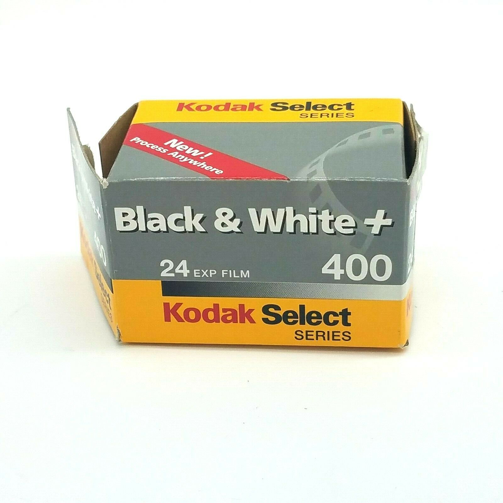

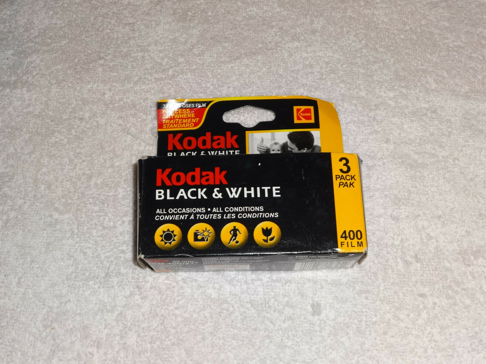

So, I have not found any regular bw boxes but I do have a bwcn and bw+ box, but I don't have them at my place but here's the canisters
Thanks. From what I can see there is nothing on the first two cassettes or the boxes to indicate that these are other than traditional b&w films whereas the BW400CN does mention C41 It just seem strange if these are C41 films that Kodak hasn't indicated this but has done for BW400CN.
I know very little about Kodak's film history but I am tempted to ask if you are sure that the the first two are in fact C41
What I also find surprisingly is why we appear to have no Kodak experts who recall these films and can give definite answers to what seems to be reasonable questions or have chosen not to reply

The canisters all say process c41 only on them. You can see it in the shadows of my normal bw, but I didn't orient the plus to show it. I guess the process anywhere on the one ebay box is the indication.
So there you are; Kodak had a serious attack of the marketing disease that turned people in NY into Madmen whereby you earned a great salary by re-inventing the same film via different names. :D

There have been indeed two versions (technically) of this chromogenic C41 Kodak BW Film: The first version, introduced in 1998 if I remember correctly, were labelled "T 400 CN" in most major markets.
I have used this film first time in 1999 and got excellent results. Have made some of my "all time favourits" on it.
The box you have showed first - the Kodak Select with "New! Process anywhere" on the box - has a similar design like the T 400 CN. So likeley it is this first version.
Later as a successor, the BW 400 CN was introduced. It was more optimised for making BW prints on RA-4 colour negative paper. Target customers were people who wanted BW prints from their minilabs.
Both films were the most fined grained ISO 400/27° BW films ever produced, even slightly surpassing T-Max 400 (TMY-2) in that regard. But TMY-2 is sharper and has higher resolution.
For you it is quite simple: All films have to be processed in the standard C41 process.
