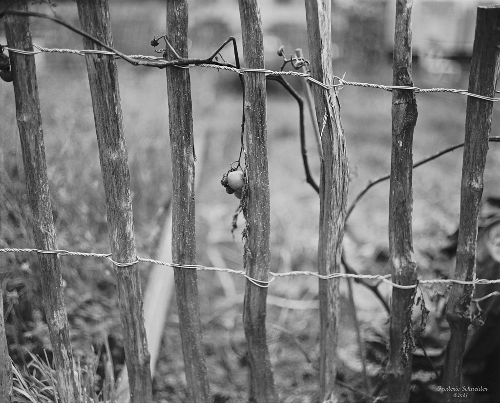

Ilford XP2 Super @100 ISO developed in Caffenol CLCS 75min stand @ 15-20°C
Plaubel Makina 67

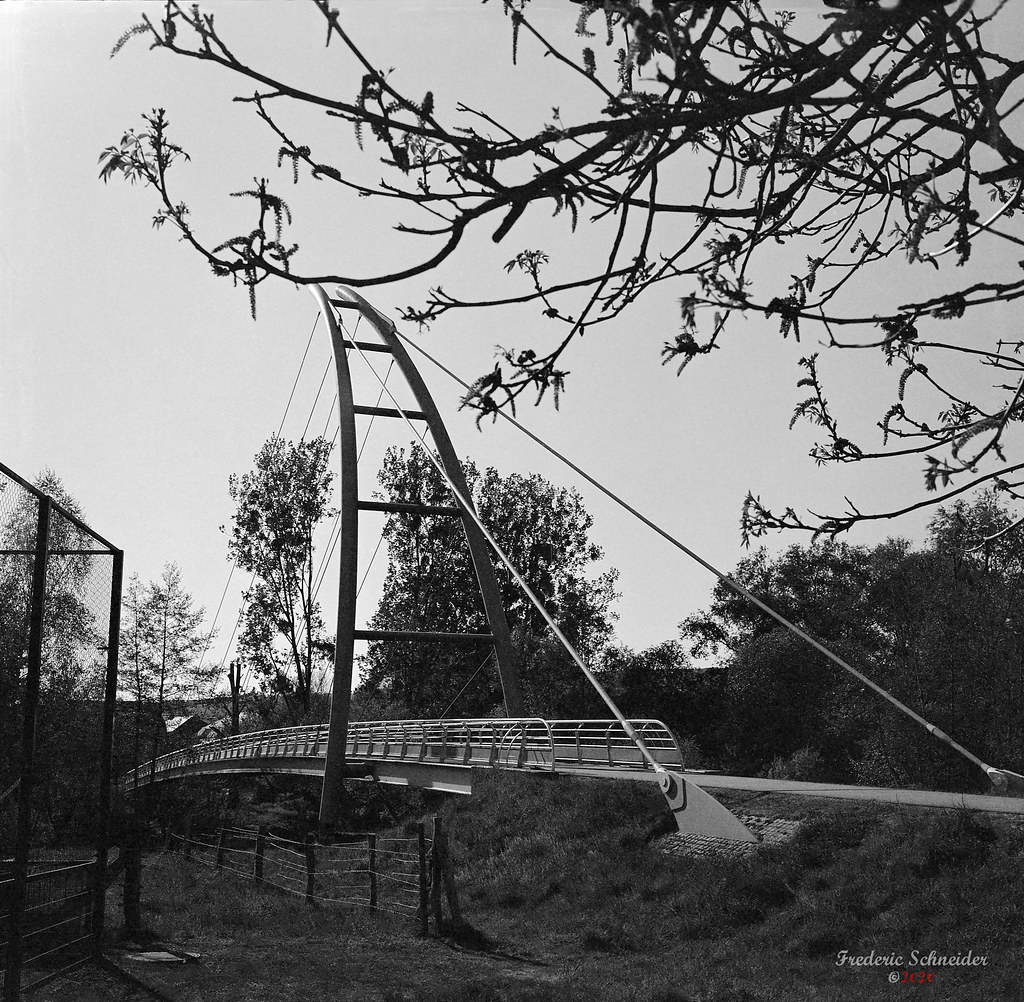

Ilford XP2 Super developed in Caffenol CLCS (Cold Start) stand 90min @ 15-20°C
Plaubel Makina 67 • Nikorr 80mm F2.8

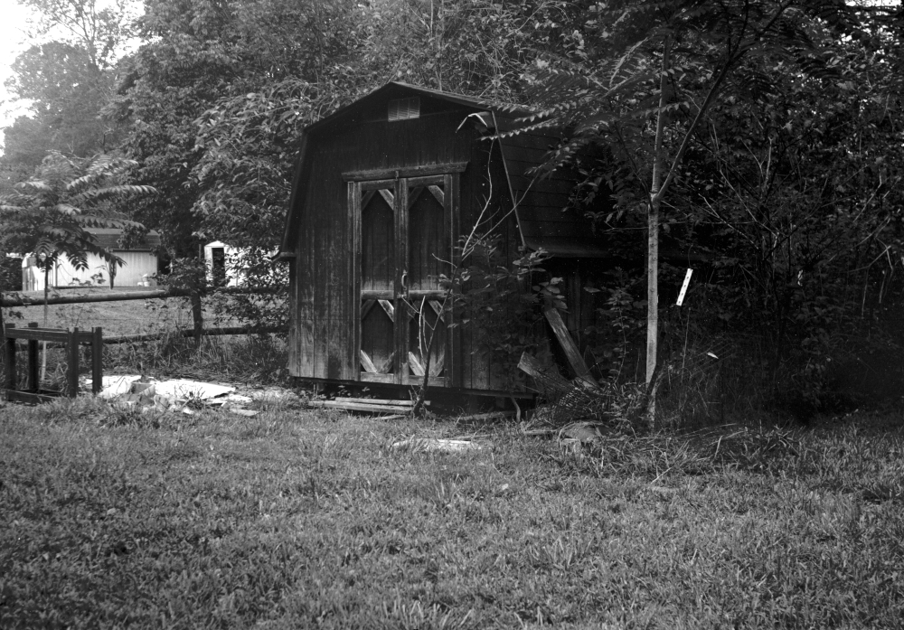

I'll add to that, though my images aren't nearly as good (I've only processed one test roll so far):
Wirgin Auta 4.5, Radionar 105/4.5, XP2 Super, Df96

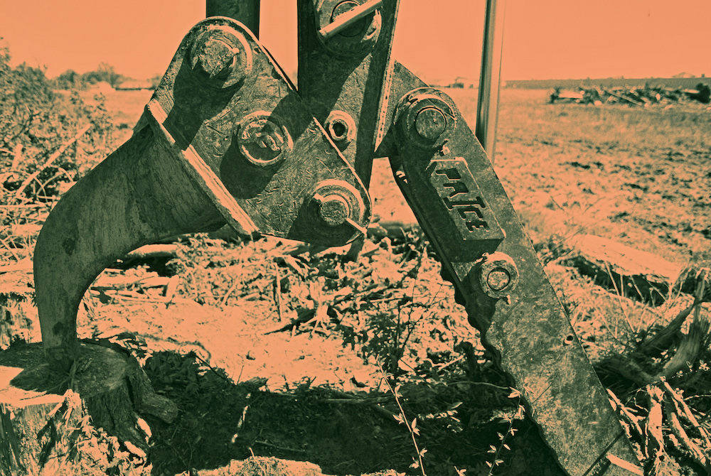

Oh, I found my scans of a couple rolls of T400CN that were process with bleach bypass -- C-41 color developer, then C-41 fixer, but the silver image left intermingled with the dye image. At EI 800, it produced some pretty decent image quality...
Voigtlander Rollfilmkamera, 105mm f/4.5 Anastigmat-Skopar, Kodak T400CN, EI 800, bleach bypassed

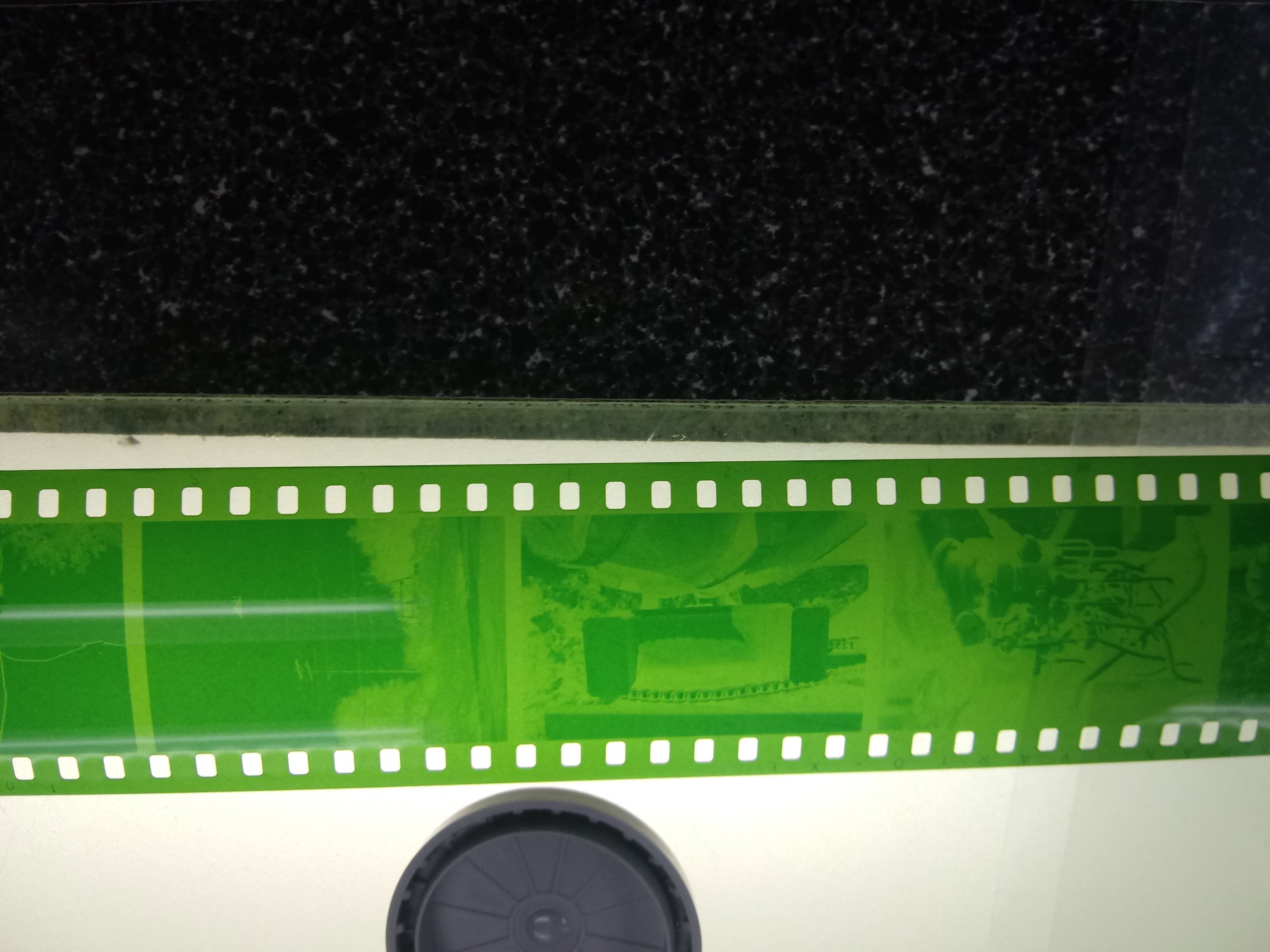

I got my c41 monochrome vx400 test back, and it came back massively faint. it came in a lot of three so I'm going to do another trial before I try crossing it in e6.
note- this film expired in 2006, and was imported to the US from Russia, which took over a month. I shot the roll at iso 250.

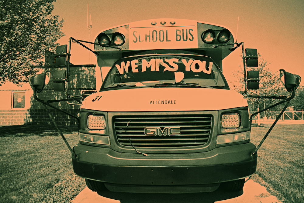

Also, I just sent out my Vario XL e6 cross this morning, so we'll see what those results look like in about a week or so.
And I have shot a fuji bwcn to be developed in c41, but that hasn't been processed yet.
