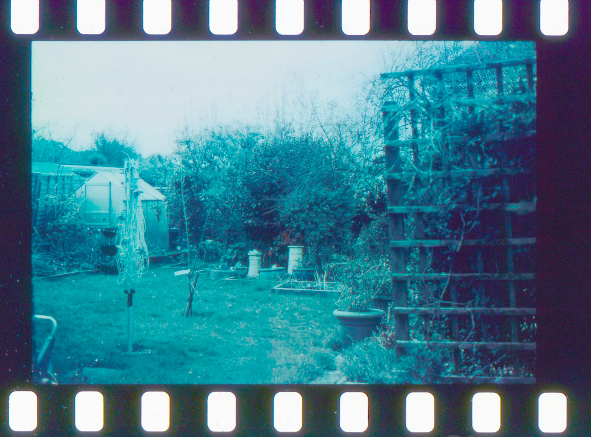

View attachment 155254 I had much more success today.., but by the looks of things I overdid the red re exposure and possibly the blue re exposure, leaving nothing for the magenta developer to actually develop. I can see the first hints of green in the grass, so maybe the yellow developer did work a little. I really have no clue haha. What does anyone think I should do to get more yellow and magenta in my image? Maybe reduce red and blue re exposure times and extend yellow and magenta times?
Like PE said, you need a colour chart.
Hi Alex,
I hope you (and others) don't mind, but I took the opportunity to download your posted image and see what, if any, color content was actually there. I understand this is an analog forum, but I don't think there's anything inherently wrong in using technology to support analysis of your test results. In this case the scanned image is merely data.
For the first step, I used only linear processing techniques in photoshop. By this I mean I did not change the relative color content (did not adjust color balance or hue), but rather increased the color levels to more easily see what colors you had there. Philosophically, I treated your scan as an incredibly desaturated image.
For the next step, I removed the cyan cast by first performing a color balance on the original image. Then I cranked up the saturation to extract the colors.
So you are definitely on to something. There is color information there. Good luck.
Hope this helps,
Jason
