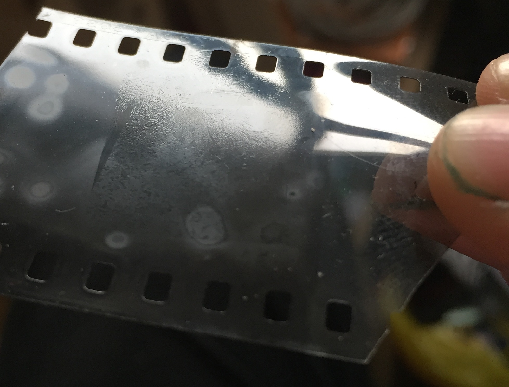

I did my first try at developing with the kit today, the results were... Interesting. The bit of film is very dark, so i think my first development should be changed quite a bit. The positive image looks basicly only magenta coloured so i'll work on times for the cyan and yellow steps. Also when disolving the cyan coupler in the developer, it looked as if small globuls of coupler or something were forming and only partially disolved (?) i dont really know and stupidly didnt take a picture. I will post a photo of the finished bit of film very soon.

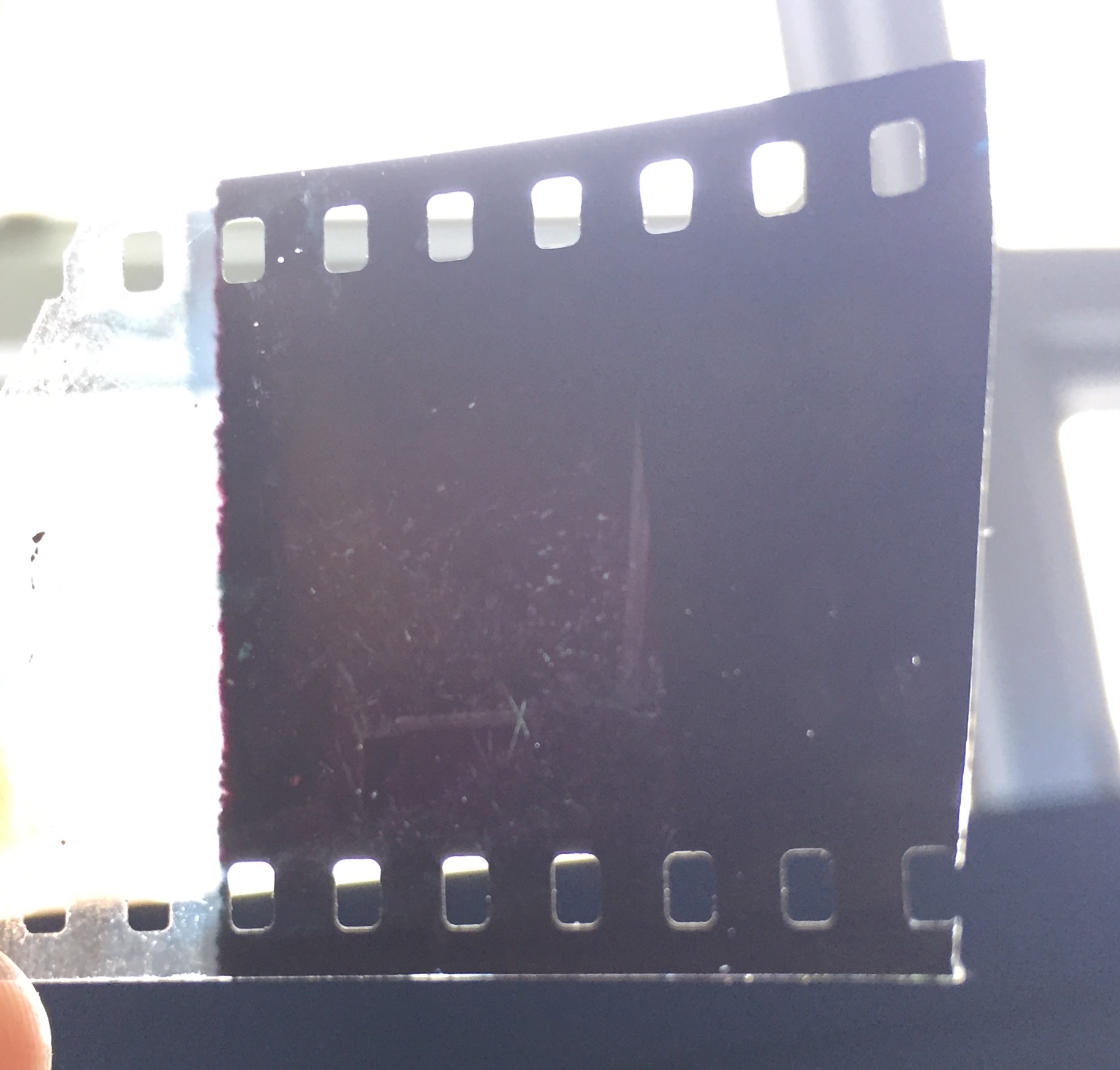

Here are the images, very sorry for the delay. Will be doing more experimentation with the kit very soon. Im doing this A: for abit of fun; I like trying new techniques in photography, and B:Its very relevent to my A level photography unit 3 coursework :smile: so it does have a practical use for me personally

Congratulations to alexd101 for producing the first new Kodachrome images we have seen on APUG for several years. It appears to be a picture of a lounge and a patio table with an outdoor umbrella in the backyard. Am I right?

I don't see the images suggested John, nor do I see much color. Really, Steve and others have gotten full, correct color.
And, the images may or may not be stable. I suspect quite unstable.
PE
The image is suppost to be my cat perched apon the corner of wooden blocks around a plant bed in my back garden hahaha so I guess thats testiment to how bad the experiment went, but then again half the frame was in the clear part of the film anyway so you would never have been able to really see what was there. Theres not alot of discernable colour information as PE has pointed out, however *something* was recorded and developed which is a step in the right direction for my A level project, and i'm happy with that result on day one if i'm honest.
