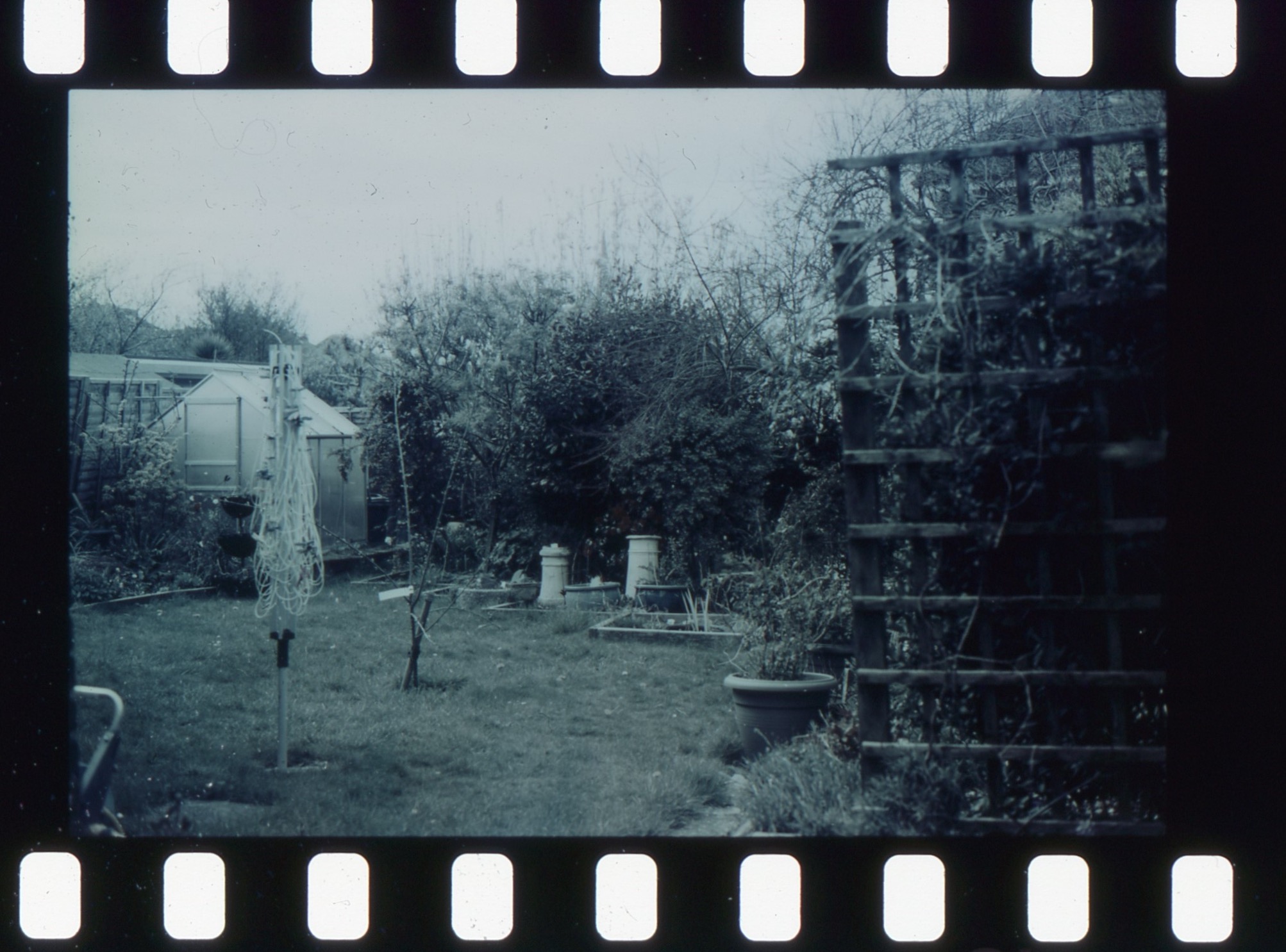

I had much more success today.., but by the looks of things I overdid the red re exposure and possibly the blue re exposure, leaving nothing for the magenta developer to actually develop. I can see the first hints of green in the grass, so maybe the yellow developer did work a little. I really have no clue haha. What does anyone think I should do to get more yellow and magenta in my image? Maybe reduce red and blue re exposure times and extend yellow and magenta times?

Well, we know that the Kodachrome sensitizing dye is designed to stick around, and so a lot of the cyan could be the dye. IDK.
It might just be a blue-cyan cast of mixed off color dyes formed by the chemicals you used. You should use a color chart to differentiate the colors in the image so that you can tell what is going on.
PE
This was one of the problems I encountered also its critical to get the re exposure filtration and times spot on. As Photo Engineer suggests these tests really need a color chart. This is what my image was of when working out the process.
