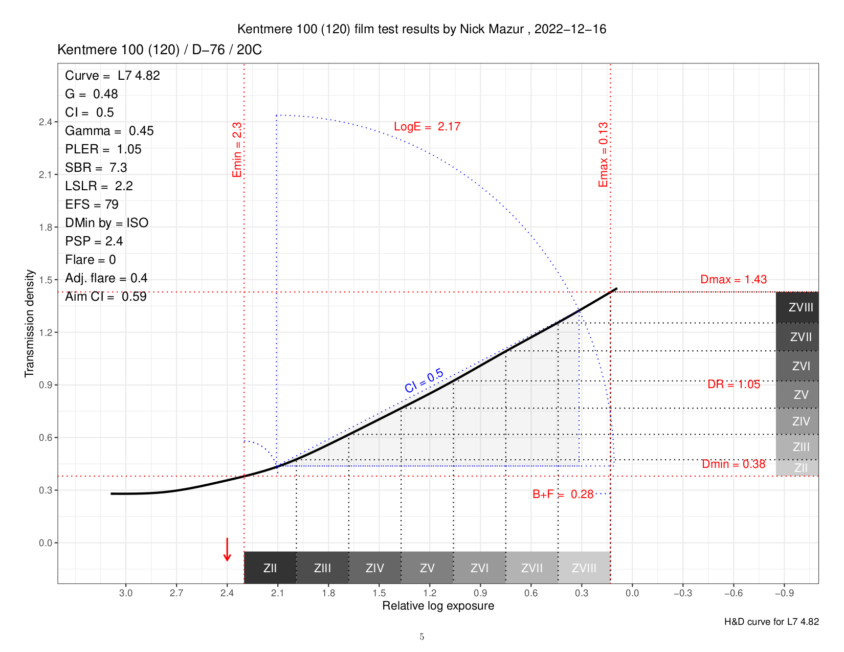

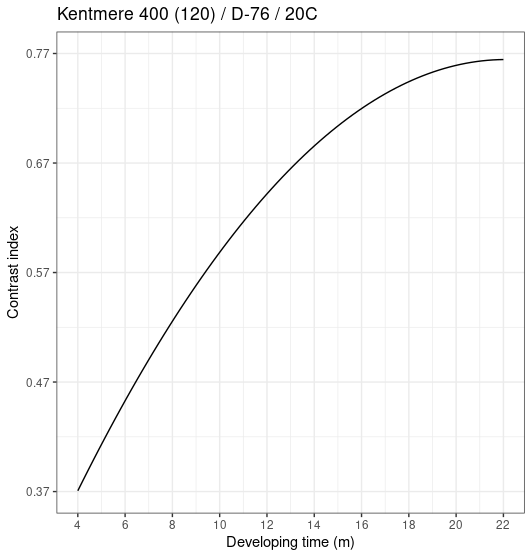

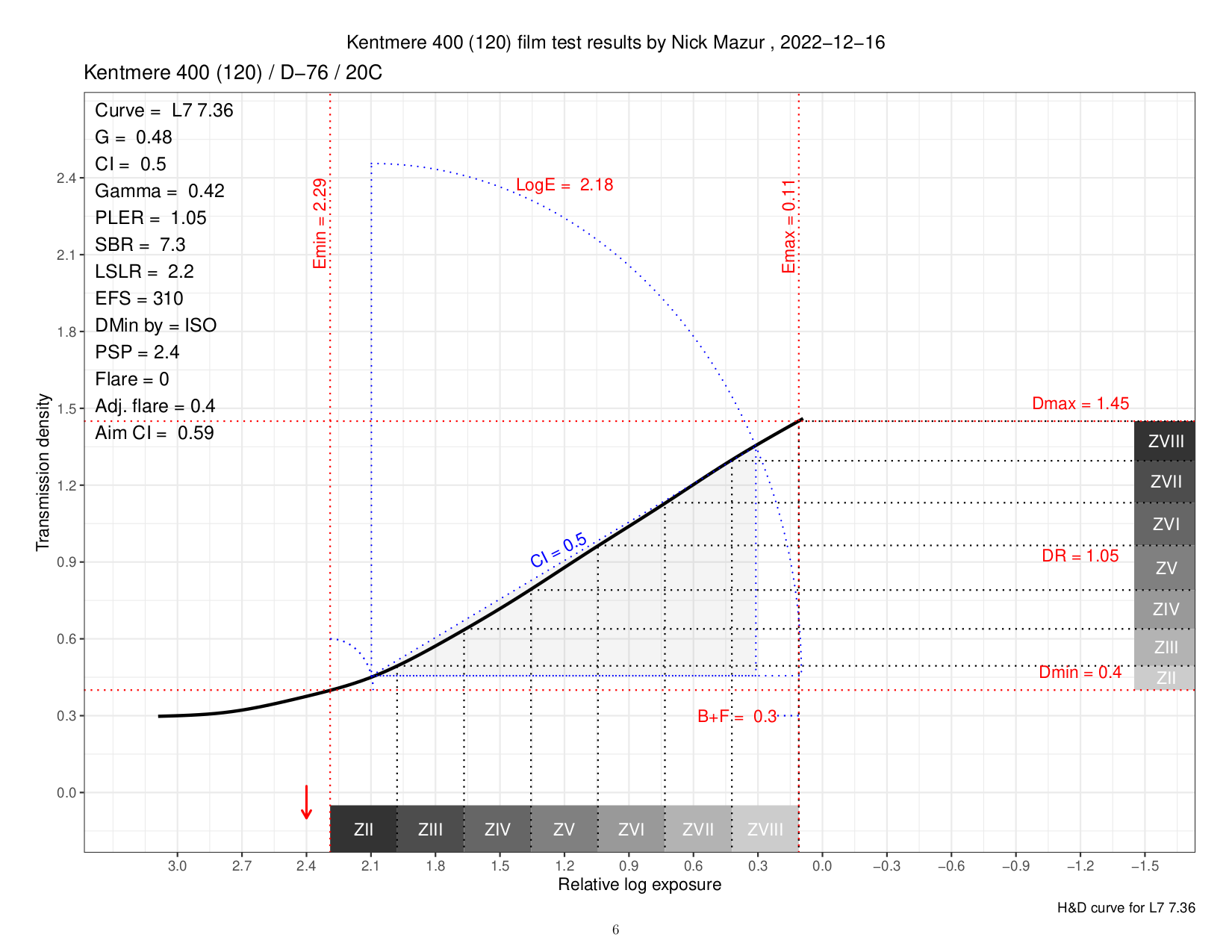

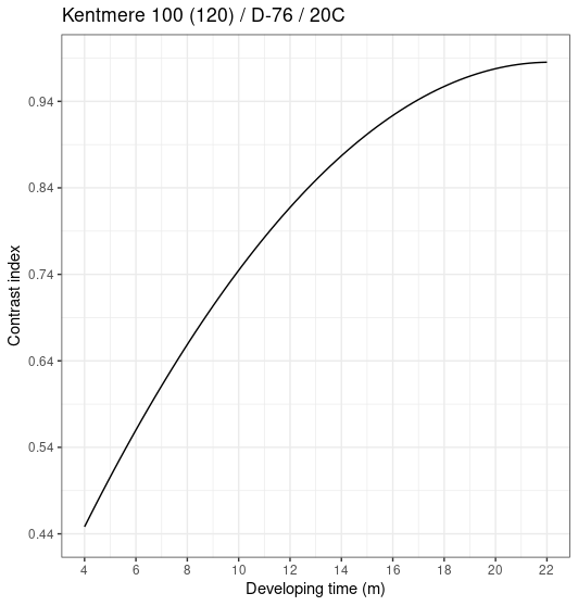

I have a couple of curves that simulate capturing the "normal" subject luminance range of about 7.3 stops (or LSLR = 2.2) for people who are interested in photographing such scenes. These are hypothetical curves based on the curve families for Kentmere 100 and Kentmere 400, respectively. The parameters of interest are listed in the left upper corner of each plot. Flare-corrected CI is listed as "Aim CI."
Kentmere100Plots.pdfrelativeDescending_finalNormal.pngKentmere400Plots.pdfrelativeDescending_finalNormal.png
View attachment 324277View attachment 324278
Aparat....for those of us who can read negatives & print...you know...practical application...but don't do graphs.... can you offer an interpretive meaning in a few sentences.
My usual disclaimer is that those are the results that I found using my testing conditions. The results are meant to be only starting points for further personal testing of the materials.
These "normal" curves are meant to represent a "normal" scene where the difference between shadows and highlights that one wants to capture is about seven stops. In such a situation, I would look up the Effective Film Speed (EFS, similar to Exposure Index) value (for Kentmere 100 it is around ISO 80, for 400 it is ISO 320), use an incident meter or measure off a grey card (or whichever surface one wants to measure off), and take a picture. Then, I would develop for 4:75 minutes (K 100) and 7:30 min (K 400) in D-76 stock at 20C in a rotary processor. That would result in a negative that should be fairly easy to print using a diffusion enlarger. If I was using a flare-prone lens, I would probably increase development time a little to compensate for the loss of shadow contrast. Here are two plots that summarize the relationship between Contrast Index (CI) and developing time for each film. I find that these plots are very useful and do not require any further abstraction (like the Zone System) to to interpret.
As a simple summary, the curves he presents where there are multiple developing times show the exposure ( amount of light) the film received on the bottom and the corresponding density built on the negative on the vertical axis. A straight line means that there is a direct correlation between exposure given and resulting density of the film. Suppose you increase the exposure from one point to another by a stop, in the straight line portion the resultant change in the negative will also be one stop (if it is a 1:1 relationship - the important thing is it's a constant relationship). If the curve is more of an S curve, then there isn't that direct relationship anymore, so a stop more exposure might only increase the negative density by 1/2 a stop - you'd have to know exactly where on the curve you are to know the relationship. Depending on where you are on the curve, it can result in highlight tones being compressed together for example, or poor separation in the shadow tones. So if you see a long straight line portion of the graphs, it should be an easy film to work with for most circumstances. It will be a predictable film.
The slope of the line in the straight portion represents the contrast index. For a normal scene, you are looking for a contrast index of about 0.58 to be able to capture both highlights and shadow detail and be able to print them on a normal grade 2 paper. From the family of the curves, you can then determine a "normal" developing time to give a 0.58 contrast level. In this way you can determine a custom developing time for any film and developer combination, developed the way you develop film - either in a jobo, small tank, trays when doing sheet film etc.
If you shooting a low contrast scene - overcast, fog etc, then you can determine what contrast level you need to bring your image highlights and shadows onto a printable range and choose a developing time and film speed to suit your scene. Effectively, you will likely be pushing the film - underexposing and overdeveloping, in order to steepen the line, which means to raise the contrast level. That will separate the small range of tones in a foggy scene and expand them to suit the paper.
In a "normal" scene, you take a light reading and expose the film, that exposure point should fall in the middle of the curve. The shadows will be near the bottom, but hopefully still on the straight line portion, and the highlights will be near the top, but also on the straight line portion. Then you have captured the full range of tones availble to be captured in your original scene, and it will be a printable negative. If you overexpose, you shift to the top and some highlight tones may fall beyond the range the film capture, so those are lost. If you underexpose, the shadows will be down in the toe ( or below it) and the film will not receive enough exposure to capture any information and you lose shadow detail.
If you are consistently getting negatives that are flat for example, then you can do these tests to find the optimum developing time. From these tests you can also determine the effective speed of the film. The way the slope of the curve in the bottom of the curve ( the toe) changes can be used to determine film speed. There is a lot of literature on determining film speed, it's a complicated subject. So by exposing and developing 5 test sheets of film you can determine both your developing time and film speed for your processing style and conditions.
More than a few sentences, but I hope that helps your understanding a bit of the charts that are being presented. There is a lot of information you can extract about how the film will behave if you can read the charts.

For me I was always getting flat negatives with HP5 when following the recommended developing times. So I decided to apply a bit of science and did the tests to generate those curves that Aparat did. I found that for HP5 in Xtol -R I needed to use the 1 stop push times to obtain a normal contrast. I went from a developing time of 7:30 to 9:30
All of a sudden I have much nicer negatives that print much easier, but more importantly for me I was able to do it with not much film ( 5 sheets of 4x5), but I also know why my negatives were flat, rather than guessing and hoping I stumble on something better. I was under developing, rather than underexposing. I'm not a fan of trial and error and hoping I can come across something that works, rather than doing focused testing that will lead to predictable results.
If a film or developer is discontinued, or I want to try a new film/developer combination I also know I can find the new developing times and film speed with relatively little effort. I'll also have a good idea of how the film will behave when I use it and what it will be good for, and perhaps more importantly what scenes it won't be suitable for.
