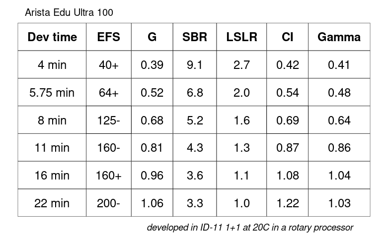

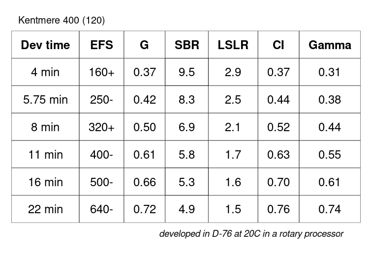

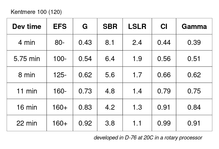

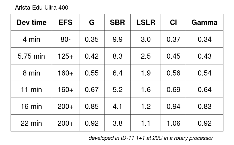

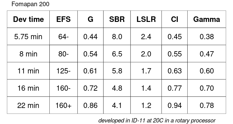

Yes, I found the same thing. Here are Fomapan 100, 200, and 400 summaries, compared to Kentmere 100 and 400. At least in terms of film speed, the Kentmere films are much close to the advertised "box speed" than their Fomapan counterparts. Having said that, the Foma films have a unique "character," which a lot of people, myself included, really like. One thing that kind of bugs me about the Kentmere films in 120 is that the base is just like the 35mm base, which has a higher B+F density than most 120 films and has a propensity for water drying marks. It's a minor gripe, though.
Kentmere:
Fomapan:

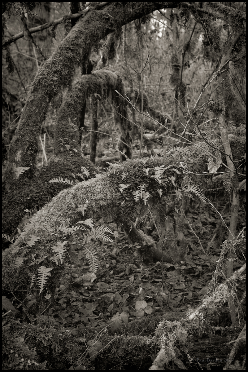

I'm continuing to explore the properties of the new Kentmere 120 films, and I'm finding them excellent in every way. Today I explored the swampy woods near the house with Kentmere 400 loaded in the Medalist II, exposing it at 250 ASA and developing it in PMK (Pyro).
It exposes well, appearing to be very close to its box speed. It handles overexposure reasonably well (You can get usable negs with up to 2 stops overexposure), and retains excellent shadow detail when exposed correctly. It behaves beautifully when processed in PMK Pyro - I can barely see any grain in the images. (And the K-100 is even better!)
Sample image: (or see it big on Flickr)
This is a gorgeous photograph. Do you think Kenmere 100 in 120 is a reasonable modern replacement for Verichrome Pan? Or possibly Panatomic-X?
Thanks very much. And yes, I was just thinking today how it reminds me of Verichrome Pan!
