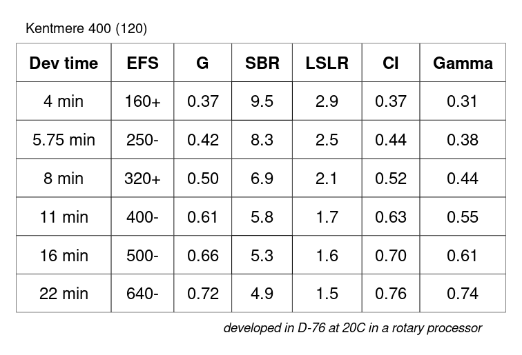

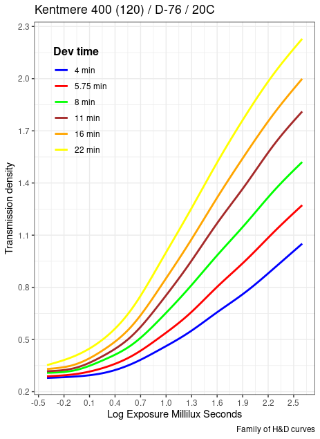

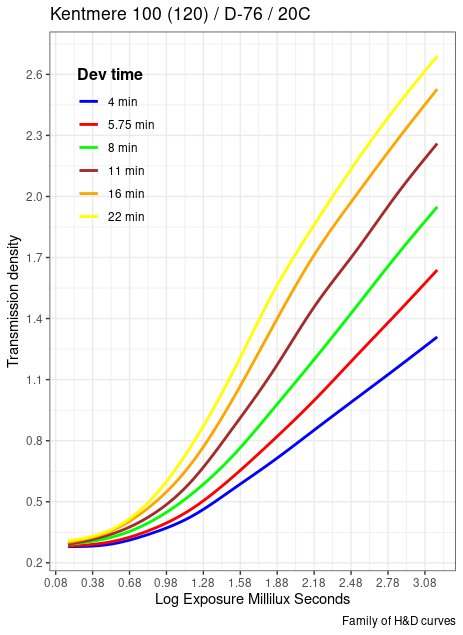

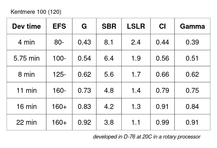

I had a chance to work with the new Kentmere films in 120 format and I am impressed. Those are budged-priced films (I paid $4.99) but they perform better, in my opinion, than their low price would otherwise indicate, with well-formed curves and film speed that actually matches very closely the ISO values printed on the box.
One thing that surprised me a bit was the somewhat high, for an 120 film, B+F density, which was very similar to that of the 35 mm versions of the films (approx. 0.28-0.32 for Kentmere 100, and 0.28-0.34 for Kentmere 400, developed in D-76). It would probably be lower in other developers.
kentmere_100_120_family.pngkentmere_400_120_family.pngkentmere_100_120_table.pngkentmere_400_120_table.png

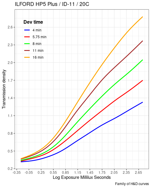

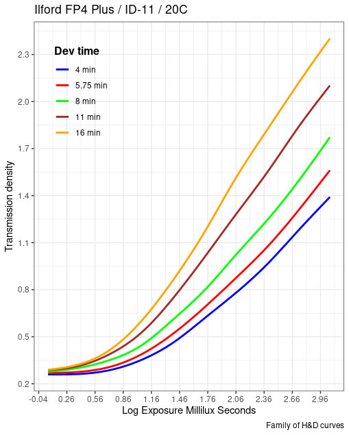

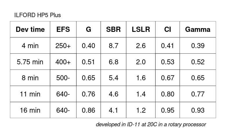

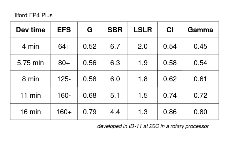

I guess it might be interesting to see how Kentmere 100 and 400 compare to Ilford FP4 Plus and HP5 Plus, respectively. Bear in mind, this comparison is not ideal, as the Ilford films I tested are the 35mm variants. I would say, Kentmere compares very favorably, at least in a film test, and these emulsions are not simple low-quality variants of the Ilford pair - they are sufficiently different in a quantitative test. What they do share, though, is the fact that both are excellent choices for everyday photography. They can be even thought of as interchangeable, at least in terms of film speed and their overall response to exposure and development. No, they are not the same, but I can see people using Kentmere more often in place of their more expensive cousins.

I have gone back to my files and dug up an Ultrafine Extreme 100 negative in 120 size. I checked the B+F density, and it is 0.28 (developed in D--76), so it looks like it is a very similar base to that of the Kentmere 100. I suppose there was some consensus at the time that Ultrafine Extreme was Kentmere, or at least similar to it.
It is so refreshing to test a film that performs as well as the Kentmere 100 and 400, despite their affordable price. I've tested a bunch of budget films lately, and most of them do not reach their box speed, with some being way off the mark. Some of these budget films have various other quirks, such as an odd spectral response, emulsion defects, packaging issues, etc., Kentmere 100 and 400 are not among them. Yes, they are economically priced, but they closely resemble their "professional" cousins.
