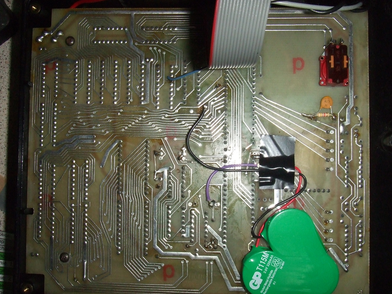

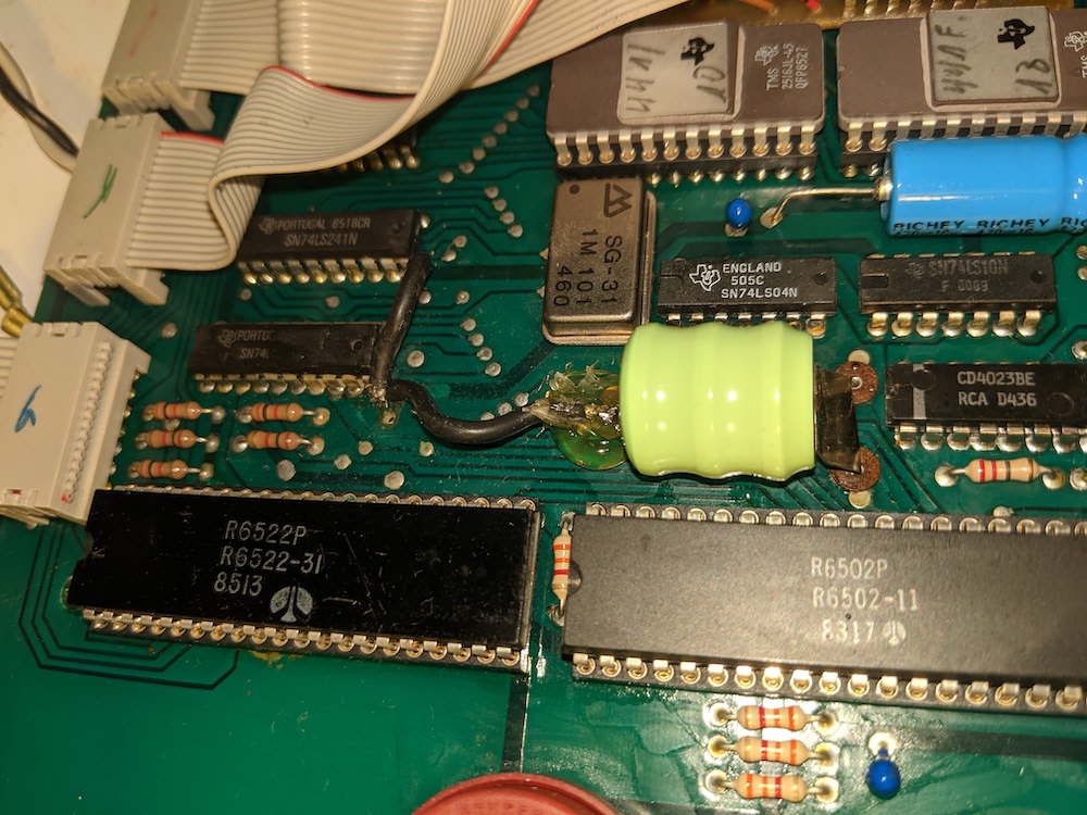

I ended up using this battery (https://batteryguy.com/varta+3|60dk-replacement-battery.html), which doesn't quite fit the space so you need to extend it with a bit of wire. I also hot glued to the board so it would stay put.
My CPP2 is actually part of my ATL-1, and from the serial number it should have the first motor upgrade in it. The motor is still going strong, but eventually I'd like to stick that 3rd upgrade motor in there if I can.
Attached a photo of my repair job below.
Hi Mr @pwadoc
Thank you for your reply, and description of your solution.
I changed also completely from the original form factor of the NVRAM battery. I retrieved a photo of my own repair in 2008 :
I was lucky enough to find this 3.6V NiMh battery spare in an electronic consumer store (I think it was intended primarly for a wireless phone), and it was flat enough to fit between the back of CPU PCB (sticked with double sided adhesive) and the power supply PCB. And since all these years, the programs stay well stored without a glitch !

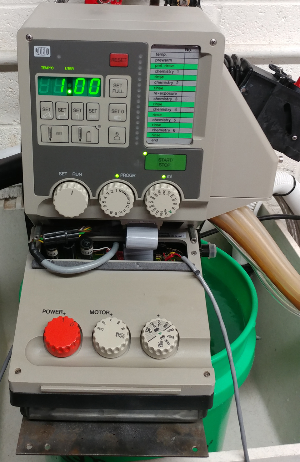

I very recently needed to replace the SET/RUN switch on an ATL-2 Plus recently with errant programming issues and those issues cleared with the replaced switch. Just a thought.
Regarding your replacing of the CMOS battery. That battery's function is to retain the programs that you place into the program channels. I presume you installed a new 3.6v 1/2AA Lithium battery and installed it correctly. Not trying to be sassy but gotta ask the question.
Does your ATL-3 have the automatic filling feature? You can disengage it by placing the #5 dip switch in the down position thus turning that feature off while trouble shooting.
Do you have a service manual for this style processor? The ATL-2 manual is basically the same for information.
How about keeping the head as a parts unit? Most parts will fit your working processors and keeping them going is key also. just a thought. :smile:

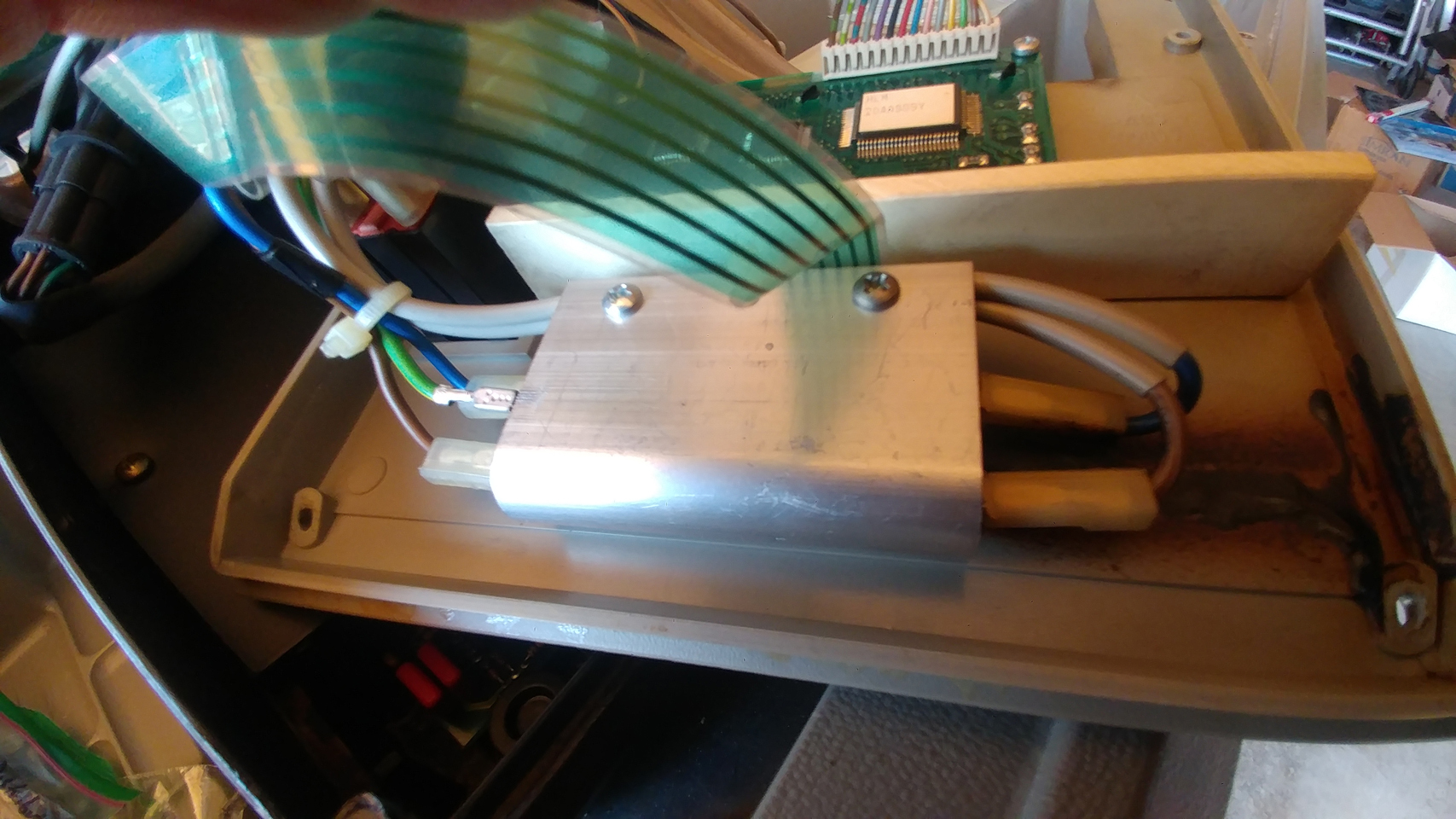

Good morning from Milwaukee WI USA.. I realize this can be a long response but this is how I would do the first line of troubleshooting of your issue.
With my rebuilding projects I have not experienced any defective or broken e-proms but I have had to replace the SET/RUN switch on 1 board. The processor was very erratic when the defective switch was still installed and I was able to resurrect the processors by harvesting the switch from an older ATL board. The parts that Jobo uses are basic across most of the ATL 2/3 platforms.
With taking the processor apart and replacing the memory battery by any chance wasn't reinstalled backwards by accident? Gotta ask :whistling:
Now the other item I would look at more closely is ALL the connectors that needed to be unplugged then reconnected to be able to turn the processor back on. Look very closely at ALL of the the ribbon cable board connectors for any bent or smashed pins preventing contact paying attention to the locking socket connector on the bottom edge of the control board. On more than one occasion I have found damaged connector pins because it is to do than one thinks. If you find a damaged connector use EXTREME caution on straightening them or they will break then you will be hunting for a replacement connector.
With everything taken apart inspect both of the ribbon cable connectors for any damage from the Display board (94018) to the control board (94019). If their is no damage reassemble the control board to the display board then move to the side back of the board where the connections are made to the Control Head Interface board (94017) ribbon cable connection. If you find no damaged pins reassembly making sure you have the 2 power wires (red and black) on the top corner spade connectors in the proper spots. Once you are sure everything is normal with the connections on the backside of the control board remount the board. With the main control board reassembled reconnect the ribbon cable from the Interface board (94015) to the control board.
That would be my very first step to troubleshooting erratic board behavior if I believed it was working prior to the issue and having taken the boards out to make a repair to one.
I hope this helps. Stay safe and healthy.

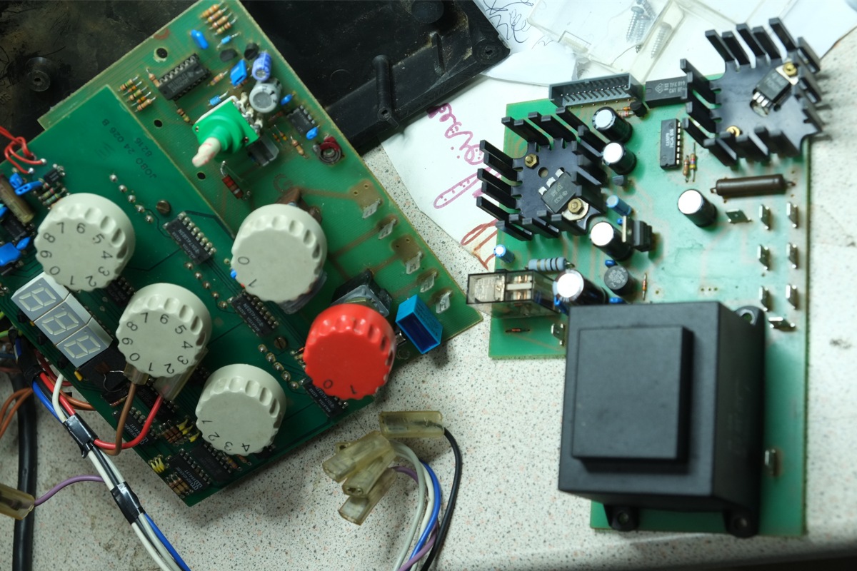

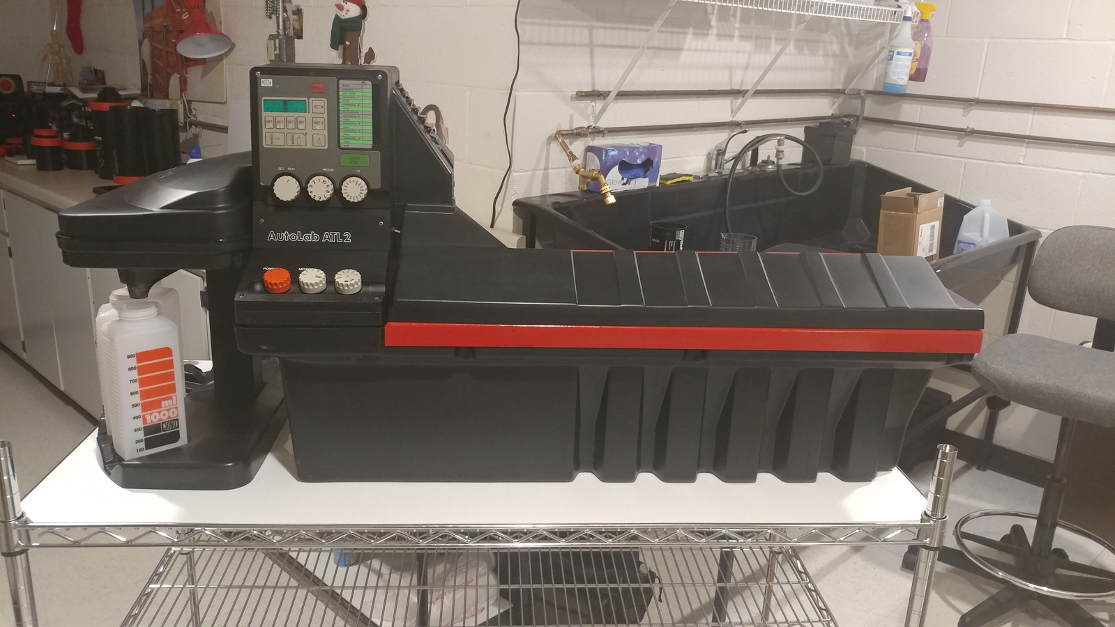

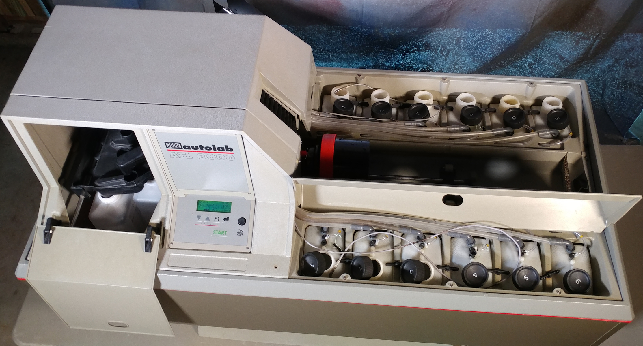

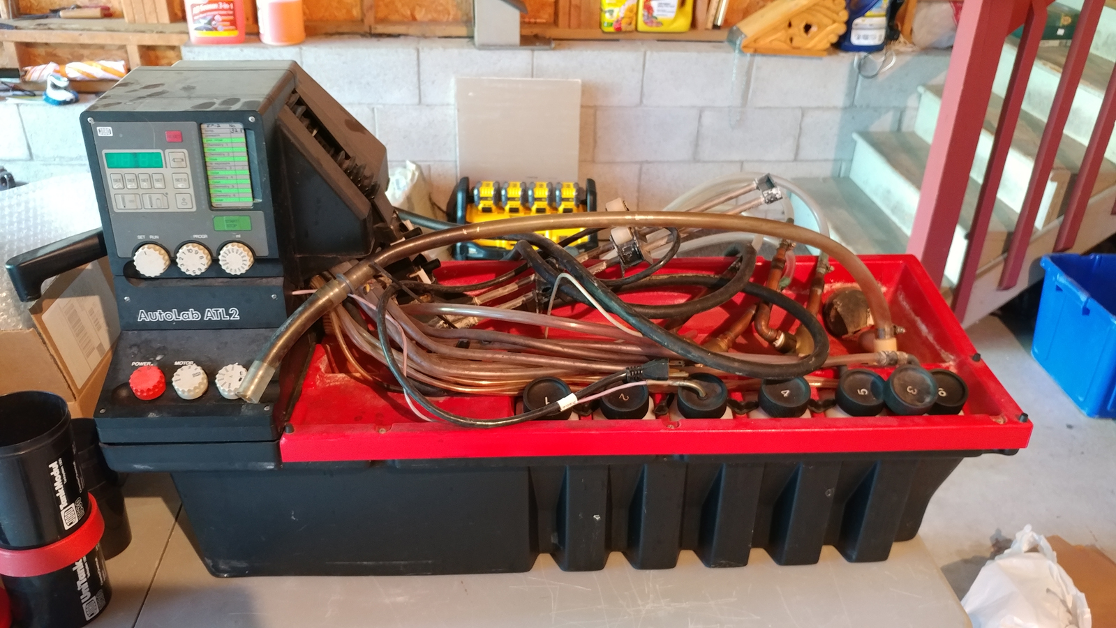

Hello all.. I figured it is time to check in once again. Since my first Jobo ATL-2 rebuild I have been keeping busy with more rebuilds. To this date I have now restored / rebuilt a total of 4 ATL's and I am finishing up on an ATL-3 complete head.
My first journey was the ATL-2 that I had posted here and with help and suggestions from those on this site I was able to bring a processor back to life and looking almost as good as the day it was purchased new.

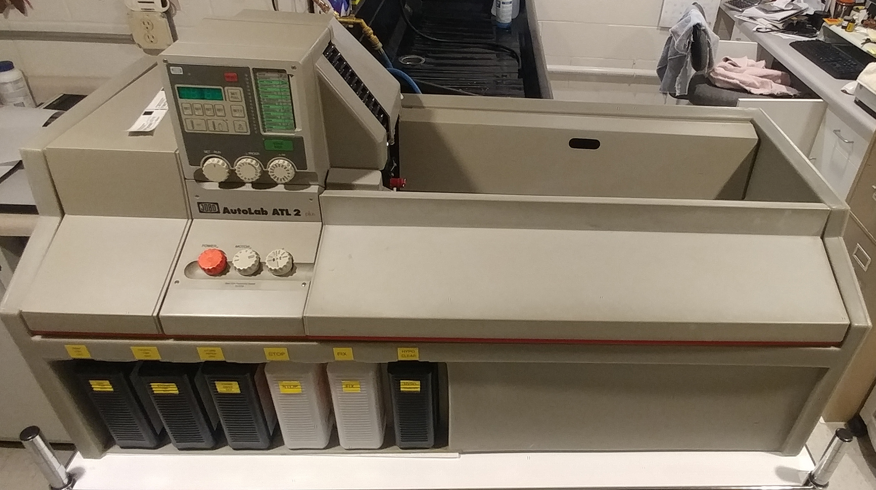

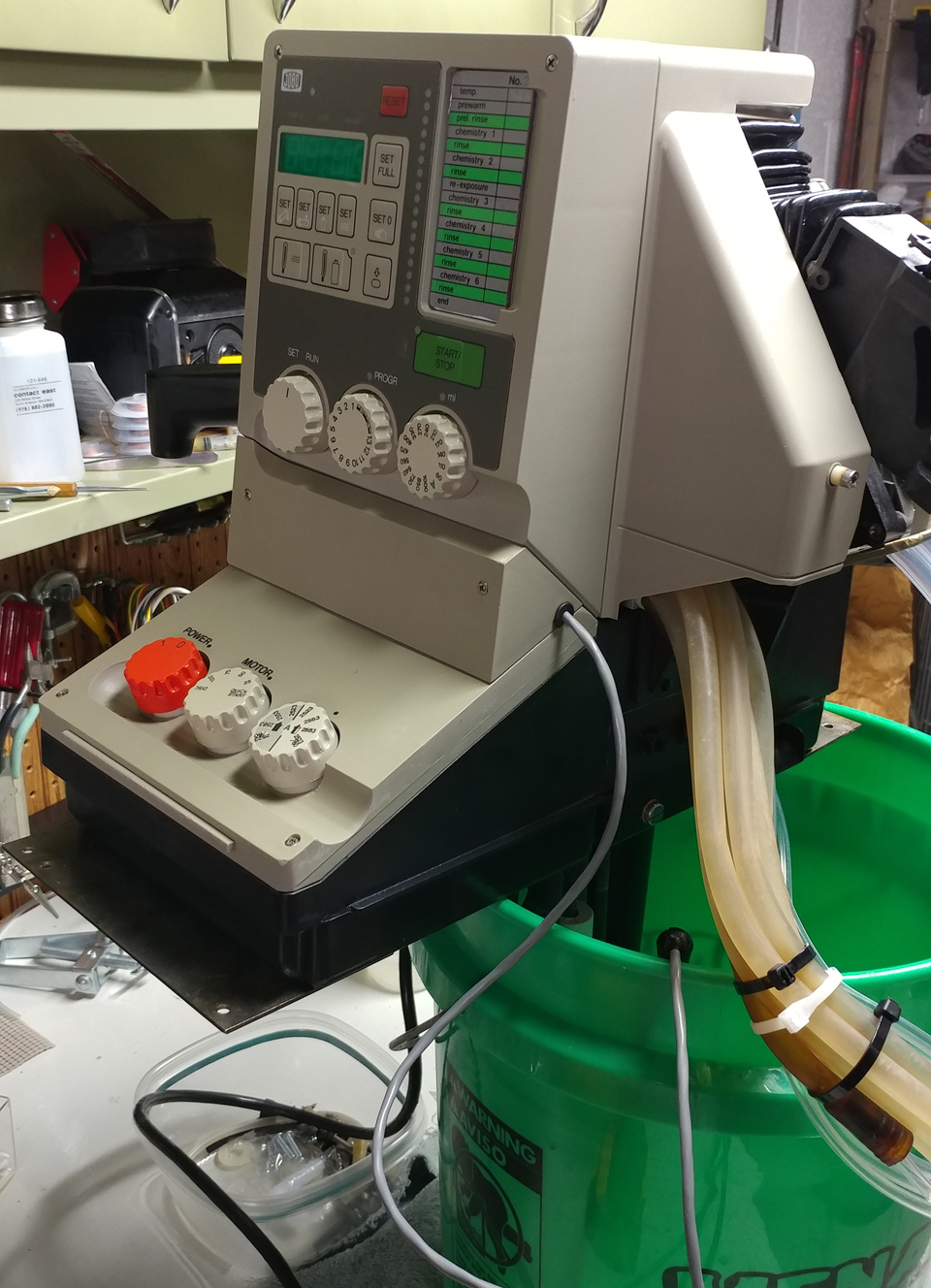

After that I was gifted an ATL-2 PLUS and that one was a bit more challenging. ATL-2PLUS first home.jpg The processor was worn out and should have been a parts processor but I do NOT give up easily and I wasn’t going to give up on the ATL-2 PLUS either. Through due diligence ATL-2PLUS repair process 1 - cleaning.jpg and being just plain stubborn the ATL-2 PLUS is processing my film here. ATL-2 Plus completed.jpg It is a beautiful processor and works like it should. I needed to rebuild it from the ground up from the control head, lift arm, chemical distribution, power supply, program board and such. This processor gave me a real education.

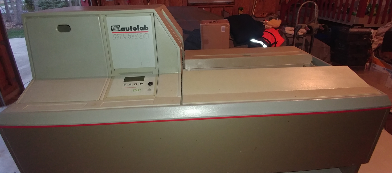

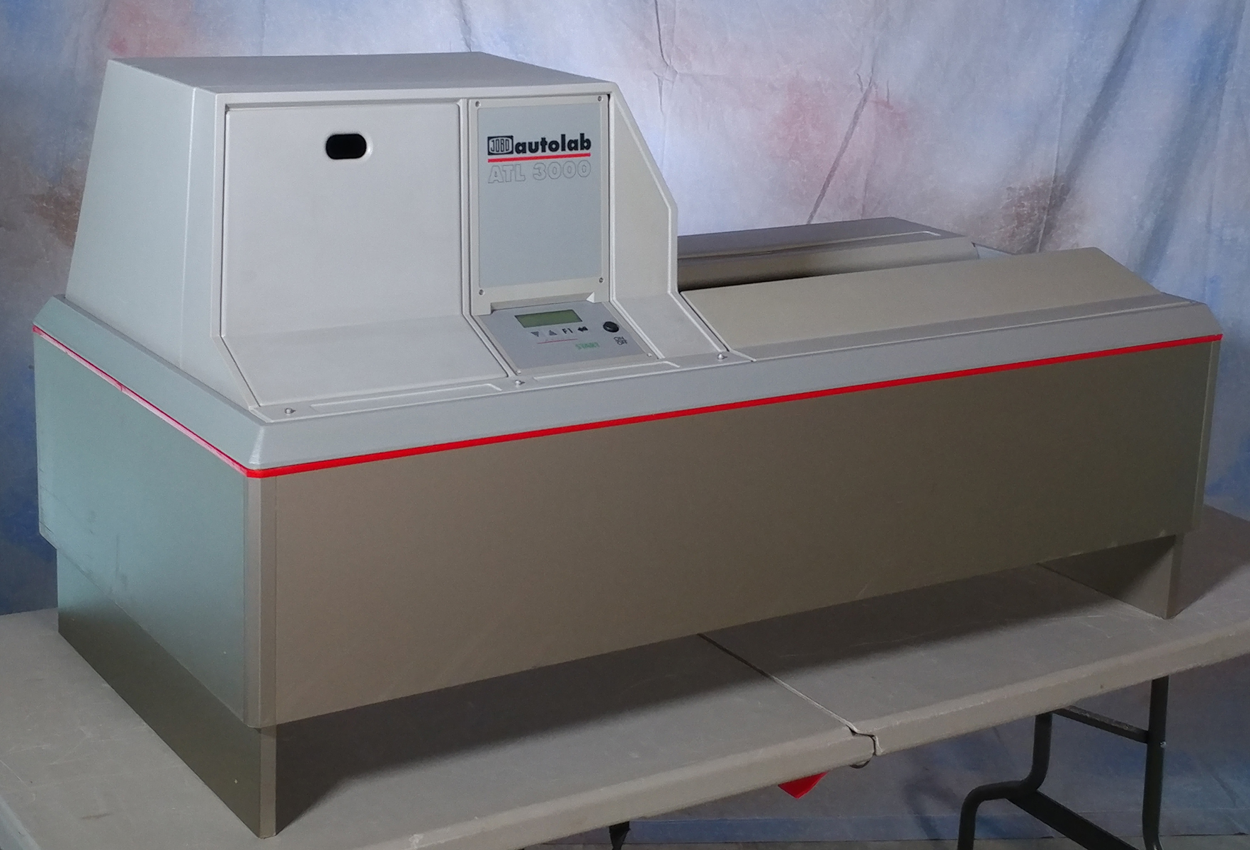

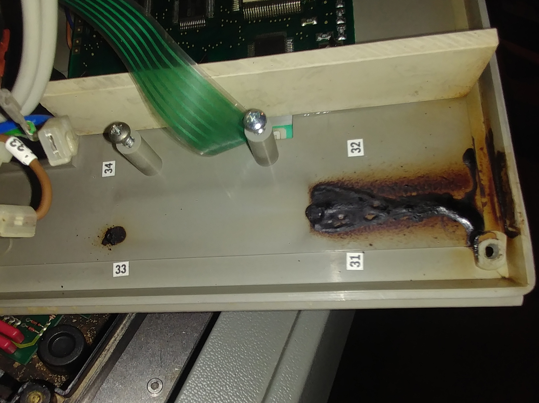

After the ATL-2 Plus my 3rd was an ATL-3000 European version (220V 50hZ) ATL3000 First Home.jpg that I found in Illinois and that processor was physically huge in size! The 3000 took me about 2 months to rebuild and then it took about another 100 hours of calibrations and running mock processes to make sure it was going to hold up and not blow out the power line filters anymore. Something I discovered was how to modify many of the components and boards to be able to use standard USA 220V 60hZ power. Something I did discovered was that most of the cause of the failures with the 3000 processor was traced back to a power supply that steps up the voltage from 110 US to 220 EURO. Life got much easier once I started to convert the processor to 220V 60hZ U.S. power and it began to show real progress with regards to running processes. I am very happy that the 3000 processor ATL3000 Front view 3.jpg ATL3000 Top front view w-covers open running process.jpg was passed onto a younger photographer setting up a film processing service in the southwestern part of our country and I wish him all the best on his venture ahead. My personal preference is still the more mechanical ATL 2 and 3 series of processors. They are MUCH easier to troubleshoot.
My 4th rebuild was an earlier version ATL-2 Before clean front view 1.jpg with the horizontal tank rocking action e-prom. Before clean side view 1.jpg I would like to find a later e-prom to upgrade that processor and change the rocking action to a “FULL SET” option. This find was a unique processor because the person who had it was also trying to repair this processor but due to his health conditions had to abandon it. This ATL-2 processor was all present but was a greater basket case than the earlier ATL-2 PLUS. The earlier modifications someone made to the processor and multiple dead circuit boards this ATL-2 needed to have multiple control boards trouble shot. After devising a way to test the components on the nonfunctional boards coupled with many early mornings studying the schematics and formulating a repair process then finding replacement equivalents I was able to bring this processor back to life. Finished from front.jpg Finished from liftarm side.jpg I think I have devised a way to “rebuild” a power supply (aka transformer or relay board) based on the symptoms of the processor behavior. It works for my repair methods.

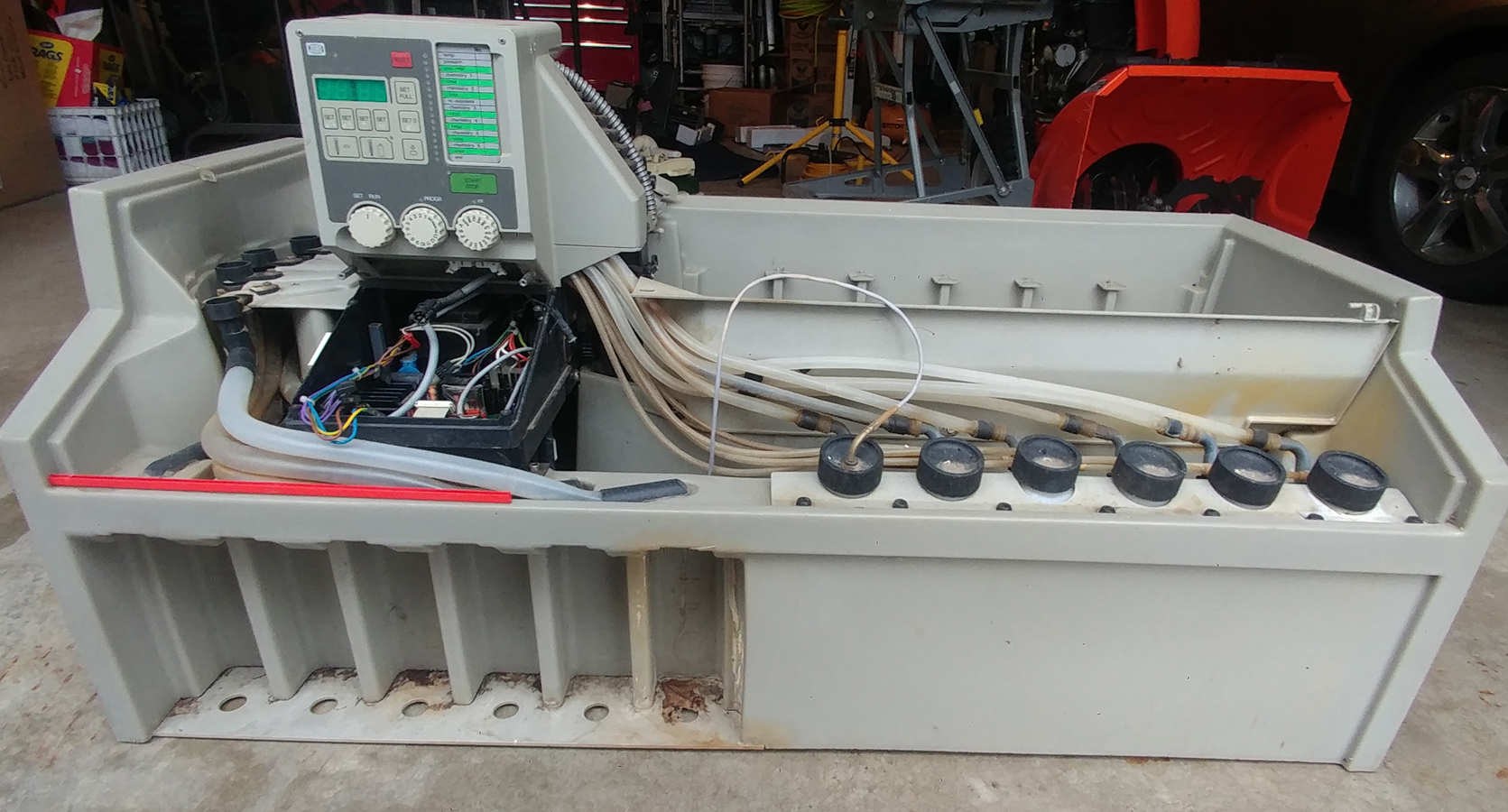

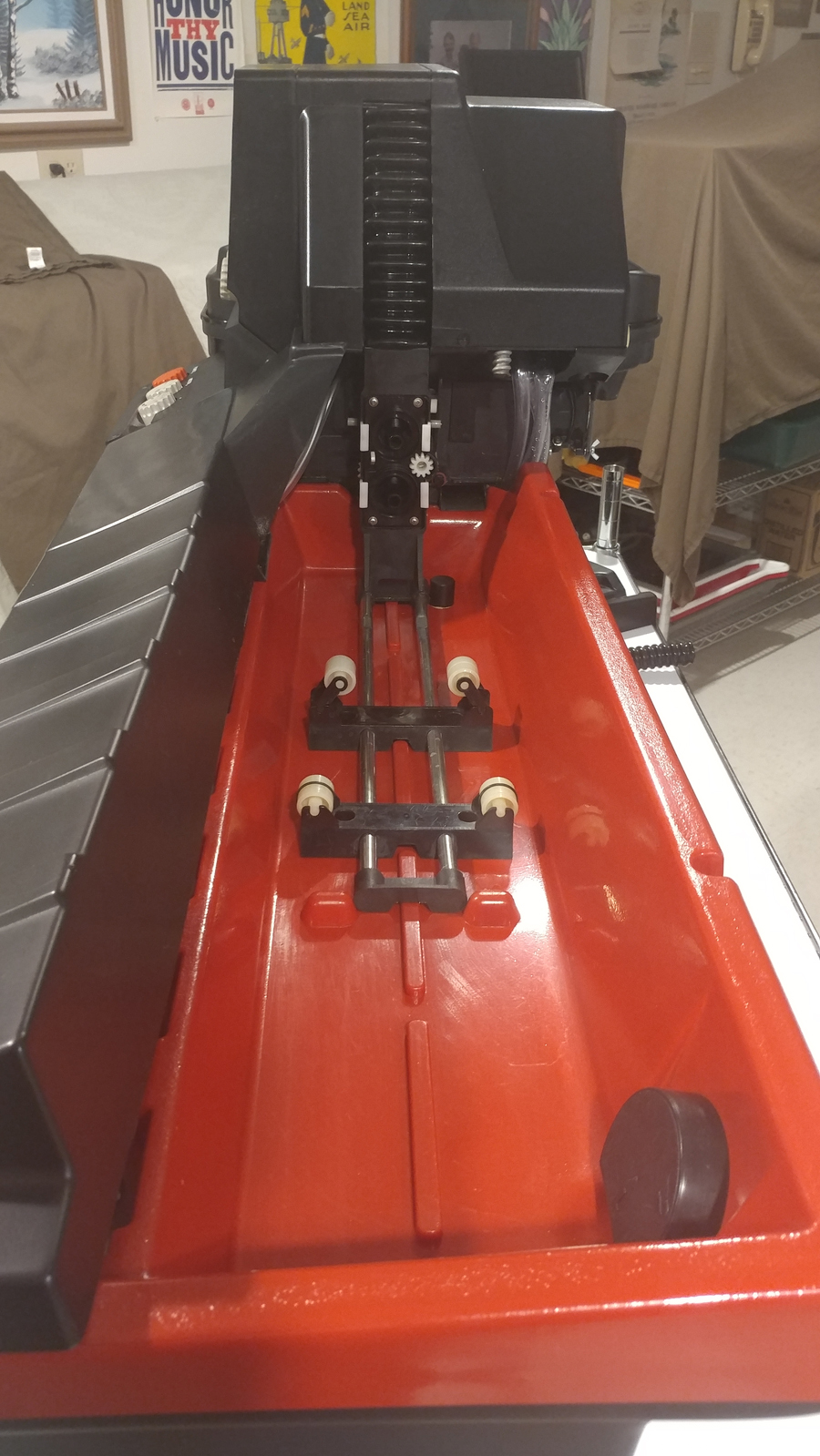

Now to my 5th rebuild.. It started life as an ATL-3 but was brutally hacked apart by someone sometime ago and I think they were trying to reinvent what the processor was designed to do. It came to me from New Mexico in a cardboard box in many pieces but luckily the control head came with all the major parts. ATL3 tore down after receiving.jpg I have been repairing circuit boards and rebuilding the head as a “spare” that can be a drop-in for any of the ATL 2/3 processors. It can be an ATL-2, or an ATL-2 PLUS (which is how I am presently configuring it) or it can be put back into use as an ATL-3 with adding the additional chemical supply lines. Either way once this head is done plans are to break the head down its components and placed in a box for who knows when. ATL3 Wet test.jpg ATL3 Repaired.jpg Most likely my children will have to dispose of it when my time comes.:cool:
I have attached a few images of the various processors from when I received them to finished machines.
After the ATL-2 Plus my 3rd was an ATL-3000 European version (220V 50hZ) View attachment 256926 that I found in Illinois and that processor was physically huge in size! The 3000 took me about 2 months to rebuild and then it took about another 100 hours of calibrations and running mock processes to make sure it was going to hold up and not blow out the power line filters anymore. Something I discovered was how to modify many of the components and boards to be able to use standard USA 220V 60hZ power. Something I did discovered was that most of the cause of the failures with the 3000 processor was traced back to a power supply that steps up the voltage from 110 US to 220 EURO. Life got much easier once I started to convert the processor to 220V 60hZ U.S. power and it began to show real progress with regards to running processes.
What in this processor made it prone to fail due to a different mains frequency?
I assume all time based functions were controlled by an own, independant clock which is based on a quartz. Thus no interference from mains frequency on this part.
All the ATL processors work with either 50 or 60Hz power sources because the transformer board takes care of the actual clocking voltage. The different power frequency was not the original issue. The transformer on the ATL-3000 power supply is both a 50 or 60 Hz supply where it makes the difference involves the pump motor and the power filter. The failure issue was the use of the external power supply to step-up the voltage from 120v US to 220 EURO. The previous owner had purchased a low cost unit off of eBay and when I finally took a serious look at the stand alone external power unit I discovered that the supply was not supplying the required voltages to the two main leads of which one was 120v the other was 50v. With the odd voltages, the stock power cord on the step-up voltage device and the adapters supplied with the unit it wasn't passing the neutral (ground) line thru to the processor. The unbalanced power being supplied into the processor plus the lack of the the neutral circuit greatly over stressed the power filter capacitor and continued to make it blow out.ATL3000 Burned control part.jpg Damaged front panel.jpg PowerCap PowerLineFilter FN 420-.jpg
I hope this helps clear your question up.
