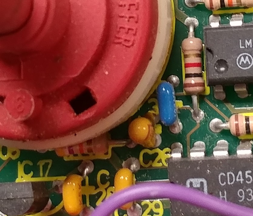

Fred of Wisconsin, I just bought an ATL2 that has been in storage for 25 years. When I powered it on, the display came on very briefly and then went out. Nothing works other than the cooling fan. The number 3 fuse is blown. I found two service manuals on the web, both missing the schematics. Do you by chance have copies of the schematics and any pointers what direction to look for the fuse blowing?
My first thought is a stuck motor, resulting in a fuse blowing. But that should not lead to the display going off.
Good morning Brian, as a matter of fact I have seen that issue on a unit I rebuilt and put back into use. I traced the issue to 2 caps that failed on the interface board (PN 94015). I am attaching a pic of the area. I have found that this fuse can also be blown from a circuit pair on the power supply board. Jobo ATL2 component failed.jpg I will reach out in a more secure way to share some information with you.

Hi AG.. these processors are anywhere from 20 to 30+ years old now and yes any component can fail on power up. Regarding BR's question of have I ever seen that issue where the #3 fuse blows on powering up a processor was a direct issue that I experienced then had to trouble shoot and had to repair at a component level. The schematic I work off of was very helpful showing all the posible failure points. Caps can and often do fail as they age. Hope this helps.
To follow-up my issue, with help from Fred I found that capacitor c27 on the interface board was shorted to ground and causing the fuse f3 to blow. I replaced it with an electrolytic cap I had on hand and the unit came back to life.
Your board looks pristine, especially not filthy. How could a capacitator got ground contact?
Yes, I know. But your wording mislead me. A capacitator shortcuiting in itself not necessarily has contact to ground. That is why I thought of external shortcircuiting and wondered why then you exchanged the capacitator. Though the latter should have have led me onto the right track...
Did you not consider then to exchange all electrolytic capacitators on the board?
