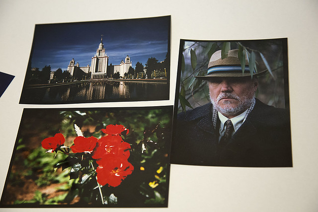

Last batch of Ilfochrome paper and chemistry was produced specially for owners Moscow Gallery of Classic Photography at 2015 year. Expiration date is may/july 2016. They still sell paper on ebay, and, perhaps will sell you some chemistry kit. If not - ask PE, he knows how to develop it or simply search the forum.
Some of my photos in DIY chemistry at fresh paper. (flowers was spoiled during incorrect film developing)
Hi! Well, I'm from Spain and here we're trying to buy Cibachrome chemicals... but we don't find anything! Could you tell me the ebay page you talked about? Thanks in advance!
PD: Beautiful work! :smile:
It seems its unavailable for now, but it's possible, that the seller is just on a summer vacation. You also may try to google Moscow Classic gallery and write a letter for them. As far as I know they still do cibachrome printing.
