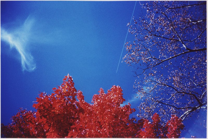

Last batch of Ilfochrome paper and chemistry was produced specially for owners Moscow Gallery of Classic Photography at 2015 year. Expiration date is may/july 2016. They still sell paper on ebay, and, perhaps will sell you some chemistry kit. If not - ask PE, he knows how to develop it or simply search the forum.
Some of my photos in DIY chemistry at fresh paper. (flowers was spoiled during incorrect film developing)
Those prints look fantastic! They really demonstrate how to use Cibachrome's characteristics to good effect. No matter what anybody says, it's a look that can't be duplicated by any other medium. I am particularly impressed that you produced these with DIY chemistry. Would you mind sharing the formulas?
