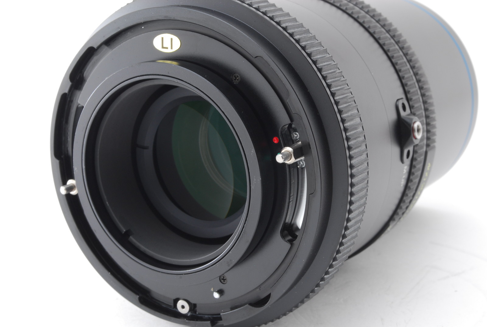

With the exception of a couple of very specialized lenses (the 75mm shift lens comes to mind), all of the K/L lenses are usable on all versions of the RB. The lenses came with an adapter that one uses with the SD model and removes with the older models.
For clarification, KL lenses were factory supplied with the ring to fit KLs on SD body, but it must be said they are not absolutely necessary, although I dislike trying to mount one without it (it aids in centering the lens in its mount and improves load distribution once mounted). When shopping for RB lenses keep in mind the ring, it is easy to see in any pic of the rear end. At least some point for bargaining, if a KL lens is being sold without it. If it is a dealer selling it, it is likely ring was removed and sold separately as they easily fetch $30. Of course you can just have one of them and keep moving it from lens to lens as it is just a somewhat tight slip-on black metal ring. And some sellers will take a fifth when asked about it.
Rear of KL lens with adapter ring in place. Without it all you can see is the thin inner ring.
