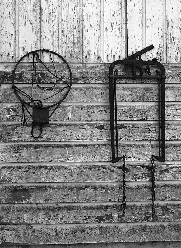

I have one form of reference that many people here might not share - I have printed for others. This probably makes me more sensitive to some of the challenges inherent in the question of which format works best for you. It can be a real challenge to be faced with an order for an 8"x10" print and a 135 negative to be printed on it. You sometimes just don't have anything to tell you what should stay and what should be cropped out.
For fun, here are two examples. One (the black and white one, shot on 6"x4.5" film) fits naturally on to an 11"x14" sheet of paper. The other (the colour one, shot on 135 Ektachrome) really needs an 11"x16.5" sheet of paper.
I don't know whether you can necessarily "feel" the strength of the appropriateness of the print size, but if you had the prints before you, I would say you would.
