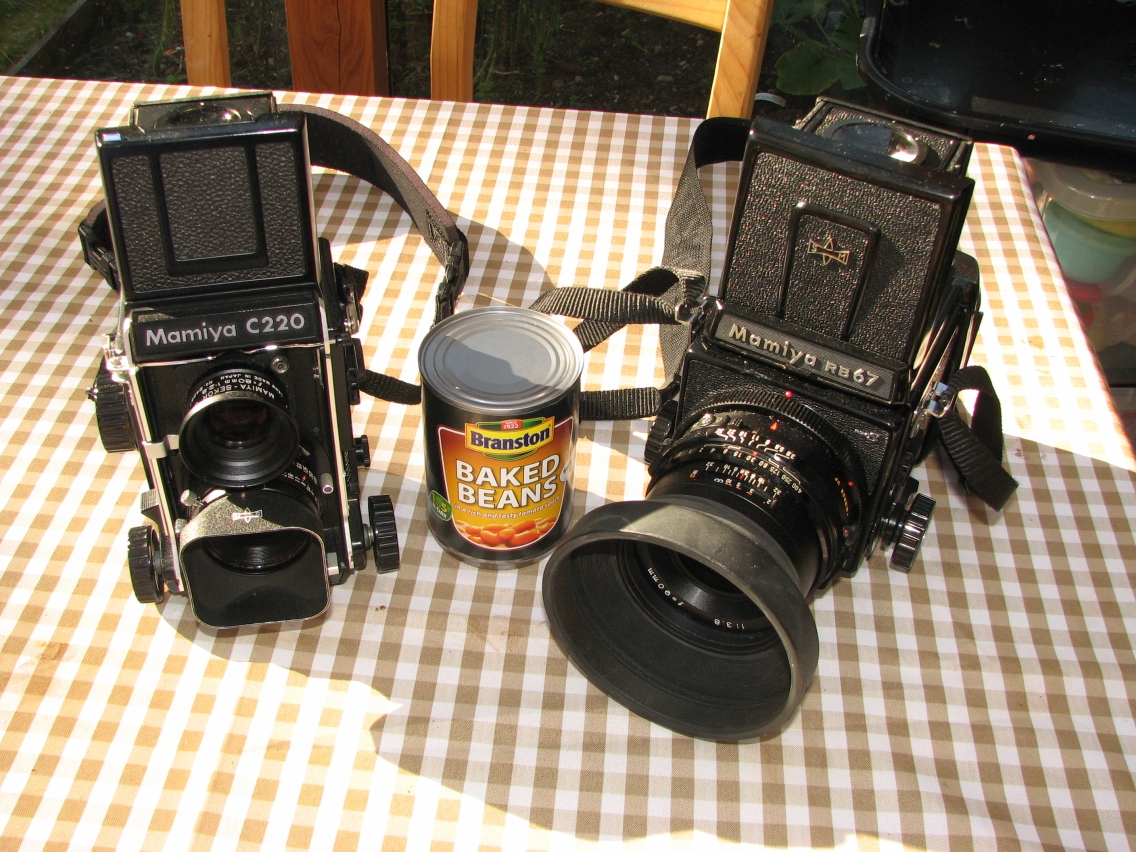

Ergonomics as well as negative size are a consideration. On the left Mamiya C220 with 80mm lens weighing in at 1.6 kg. On the right, Mamiya RB67 with 90mm lens at 2.6 kg, that's an extra kilo for 1 cm more negative... of course you get interchangeable backs, slr vs tlr, bigger system etc etc (Beans are for scale!) Mamiya2.jpg
