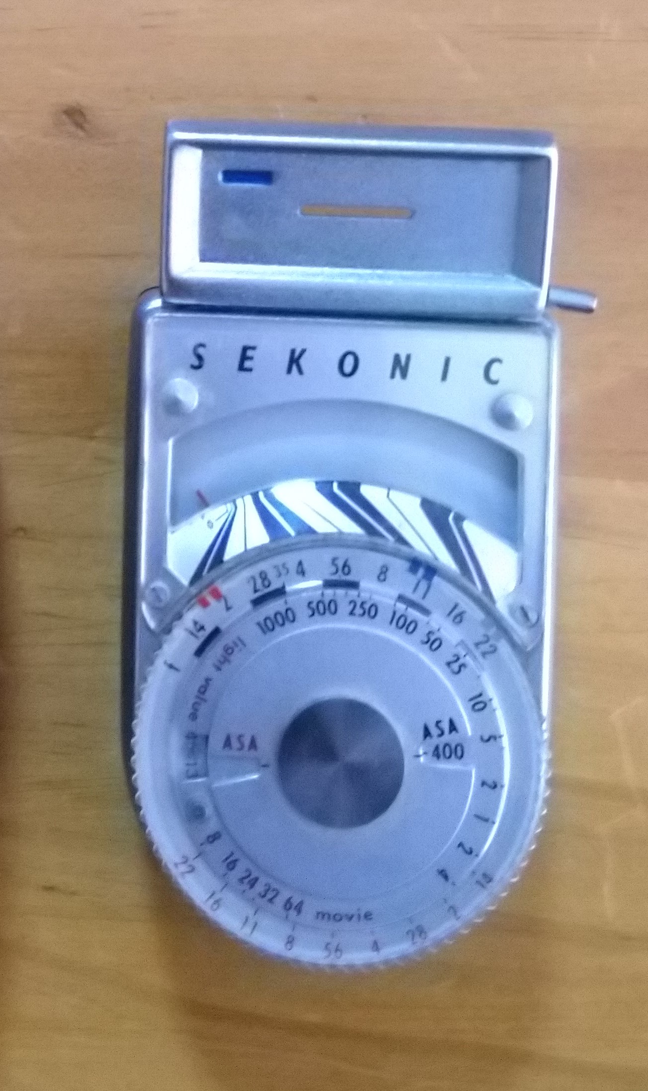

Shoot like it's 1960 again. This Sekonic L8 Director came from the estate of my late father-in-law. Just checked it outside in a scene of moderate brightness and it gave about a half stop more exposure than my Gossen Profisix. I don't use it but it's a nice keepsake. About the size of a matchbox.
