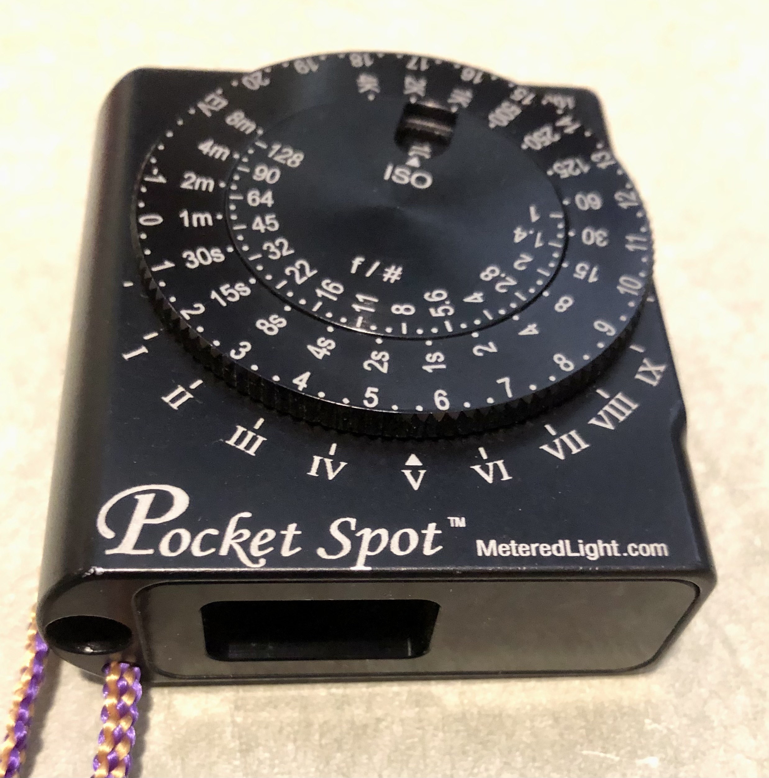

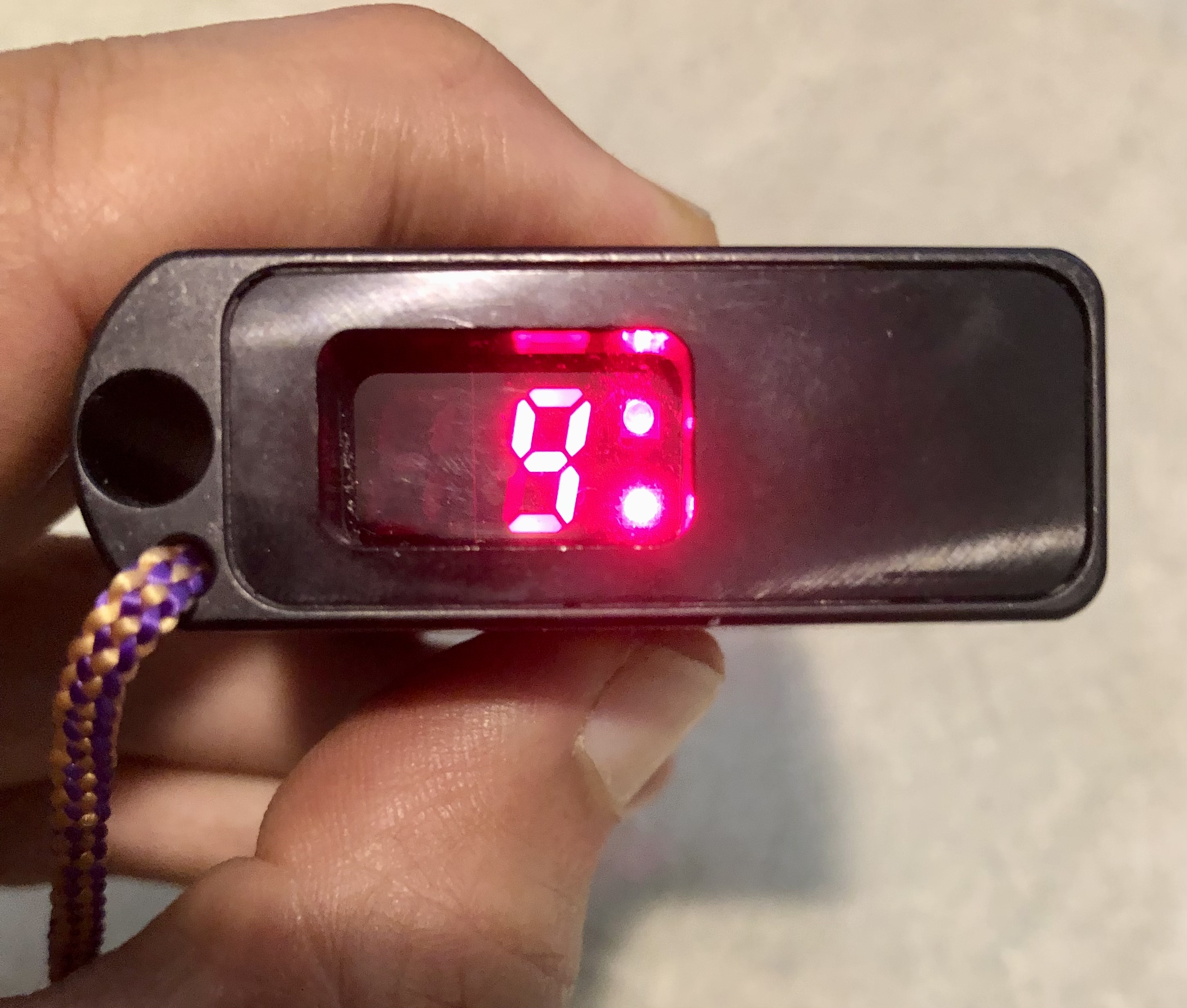

I've recently been using my Pocket Spot (after remembering where it was) and enjoying it's small-ness and simplicity heaps. Truly an engineering marvel and as accurate as my excellent big and bloated Sekonic fancy thing.
Marc!
Pocket Spot sure is cool, I remember hearing it took a long time to get one.
Does the dialface have a set of EV numbers? --- between the botttom of the range and the top of the range would seem to be its operating range!
Yes, as @AgX pointed out, just because the dial goes down to EV X, it doesn't mean that it can actually measure that low. Meanwhile, I had a look at it and the lowest EV is -6 on the dial, but it certainly can't get that low.
