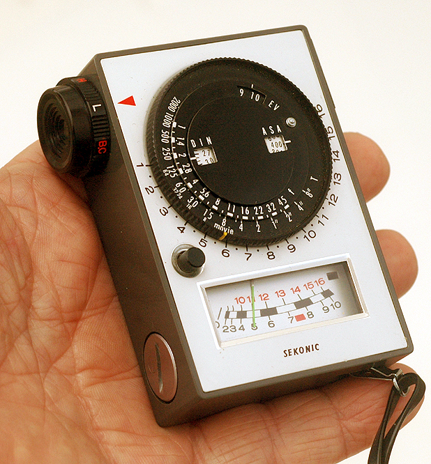

I just got this meter for a few dollars from a seller who didn't know if it worked. It looked mint so I took a chance and it does work fine and seems accurate enough. Original zippered leather case and lanyard were included.
It's a Sekonic L-206 View Meter. You look through the eyepiece and the viewfinder covers about 10% of the scene which is what is measured by the meter.
Press and release the button when you want to take a reading and the needle display holds it. You then take it away from your eye and turn the dial as on many analog meters to get your paired exposure settings.
The meter was made for an extinct 1.3 volt mercury battery that is the same size as the "N Cell" batteries used by some calculators, etc. It looks about like an AAA cut in half. They are not hard to find online and have 1.5 volts. Or, a 1.5 volt button cell easily drops in and you just need to take up the empty space with a conductor. I used a wad of foil to test the meter but I plan to make an adapter with a built-in dropper diode. There is plenty of room for it.

I agree about the advantages of the newer digital meters. The best thing for me is that I can read them without needing my reading glasses. I like meters like the Sekonic 206 shown above, but I would have to put on my reading glasses to see the tiny numbers. Bah, old age.....
