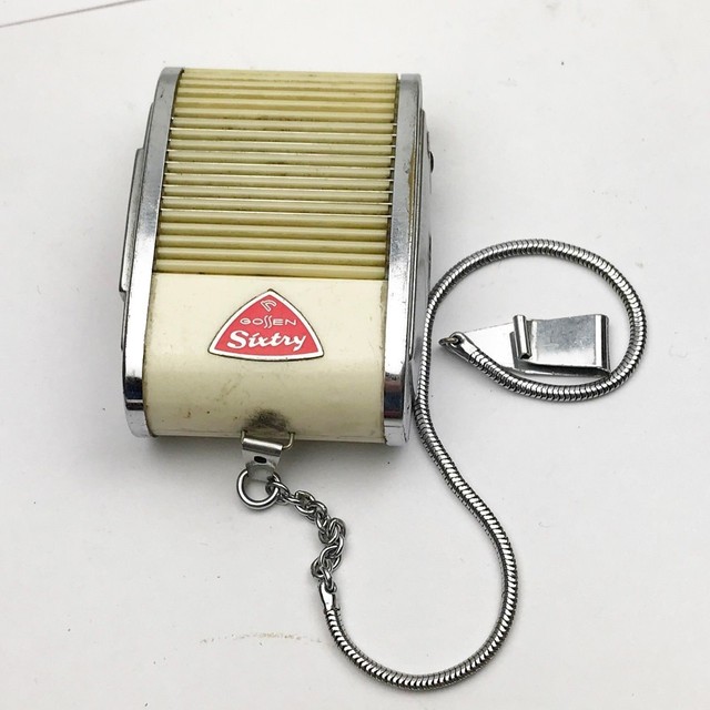

Back in the day I carried a Gossen Luna Pro/Lunasix. It would still work if I could get a mercury cell for it, the air-batteries are too expensive and don't have a very good service life. After more than forty years, though, I mostly would use it to reassure myself that my estimation was correct.

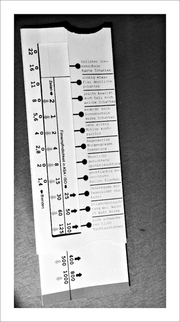

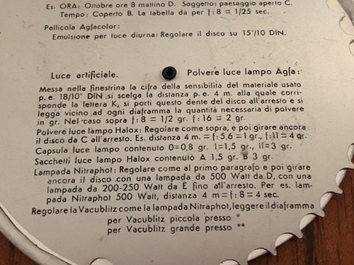

If you want a really attractive light meter, how about:-
This appears very smart but never figured out how to use it
You have a better chance of figuring it out than I. Your Italian is much better.
To me it is obvious even without reading the manual on the back, just by reading the front side:
There it is said "Start" and then there are steps "1" to "3".
Thus
-) set at the wheel the film speed
-) turn the wheel for the day and daytime
-) for the setting
-) for the weather
Only the setting of "distance" then remains enigmatic, but this is explained too at the rear side.

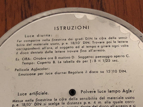

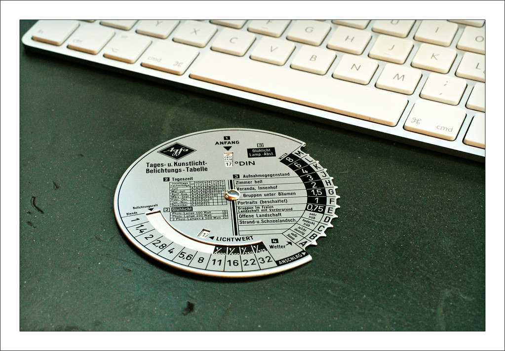

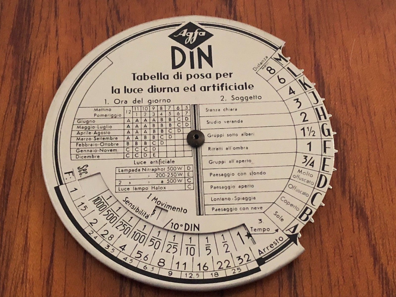

The Agfa calculator is quite small (size of palm of hand), came in different languages, in different materials, for many years, by both Agfas. It is very well regarded by several Apuggers.
There are Aluminium and Formica versions. But no cardboard ones, thus being very resilient.
Strange enough I only got one sample, others say it is quite common.
Whereas the Agfa dial was more directed at the average advanced amateur, this slide-ruler thing seems to have been aimed at the scientifically inclined photographers...
