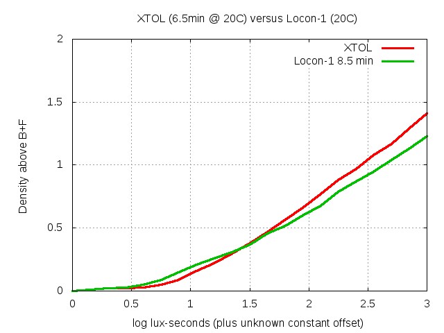

After spending a month dealing with the yellow+thin problem with my ascorbate developers (and XTOL) with TMY2, I'm finally back to working on developers again. From concentrate, I mixed some low contrast developer (there was a url link here which no longer exists).
Rudeofus:
This is the low contrast developer you tried a couple of months ago, and that got you hooked on home-brews.
Now that I have a densitometer, I was able to compare this developer with XTOL, in the following graph:
Most people would find this chart boring, but I'm fascinated by it: This developer will boost shadow-detail without blocking the highlights. In my loupe, highlight-grain is slightly coarser than XTOL, and shadow-grain is much coarser. The shadows look pushed.
Here's what you get when you reduce dev-time some:
Yes, the highlights have lost density as you'd expect, but the shadow-detail is still above XTOL. In fact, shadow-density was almost unaffected by reducing dev-time. I'm thinking this soup would be good for pushing, and outstanding for any high contrast lighting situation.
But why is the contrast lower? Earlier, I posted that I suspected that poor buffering was holding back the highlights. But wouldn't that cause the curve to flatten toward the right? These curves are straight lines, with no sign of shouldering, so I'm thinking my theory of poor buffering is wrong.
Mark Overton
You should really try to get matching Contrast Indices for the two developer/films that you want to compare. You haven't seen the whole story of these developers until you match the slopes.
Give your Locon-1 developer a bit more time until the CI/Gradient/Slope matches the XTOL curve you have.
That's what should be done for normal general-purpose developers. In this case, I want lower contrast (lower CI), and the unequal CI's makes comparison difficult. The best I could do for grain-comparison was to compare where densities were equal.
The reason I like this developer is that shadow-detail is superior to XTOL even though the CI is lower. One experiment I'm thinking of doing is to give it even less development, reducing the CI even more, to the point where shadow-detail matches XTOL. That should yield a very large dynamic range (ie, very low contrast), which would be useful for situations with extreme contrasts, such as a sun-lit scene combined with a deeply shaded area, or harsh indoor lighting, or a moon-lit night-shot where you want to see detail in the moon.
Mark Overton
Well then develop so that you get a lower, matching CI with XTOL and then compare them...

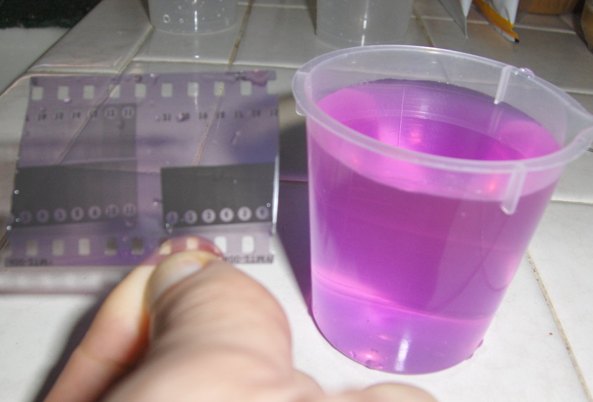

After fighting TMY2 trouble for over a month, I'm finally back trying to formulate developers again.
Today's test was to use no sulfite. But to get finer grain than Gainer's formulas, I kept the pH at 8.0. I tried 100 ml of this 1-litre formula:
Ascorbic acid ...................... 12 g
Sodium metaborate ............ 10.5 g
Dimezone S ........................ 0.20 g
pH = 8.0. Dev'd a strip of TMY2 for 20 minutes at 20C.
The result was a clean-looking negative and purple developer, as you see below:
I suspected that the lack of sulfite let the dyes in the film dissolve, but that purple seems too strong for just 1-1/2 frames. The wash-water only had a very slight magenta tint, so I think most dye was dissolved into the developer.
My densitometer confirms that the neg was thinnish. Also, about one-stop of speed was lost in the shadows.
Questions for the experts:
1. Does sulfite prevent dyes from dissolving into the developer? If so, does that amount of purple look reasonable? The picture matches what I saw.
2. Why does this take so much longer than DS-10 to develop? The pH and Dimezone are the same. Does sulfite remove oxidation-products of the Dimezone? With that not happening, I could see those oxidation-products throttling development.
3. Would using a halide-solvent restore some speed-loss? I've read that sulfite uncovers latent image sites, boosting speed, which obviously isn't happening in this developer.

Sulfite plays an important role in the superadditivity of various developing agent combinations including Phenidone / Dimezone and ascorbic acid. Superadditivity is very dependent on sulfite ion concentration. This is especially true for the induction period. Also the solvent action of sulfite exposes additional development sites on the halide crystals. The net effect is to increase development.

I was moving toward a concentrate using only organic solvents, which forced me to remove sulfite, and surprise! Much of the superadditivity was lost. Frustrating.
Is there something other than sulfite which can recover the lost superadditivity? If not, I guess I'll boost the pH and quantity of developer and see how it looks.
Mark Overton
Mark,
My comment was about the notion of fine-tuning the amount of superadditivity. Either you want it or you don't. Trying to get something in between would be very difficult as PE mentions.
The problem with glycol or TEA baseed concentrates is the inability of the home experimenter to get sulfite into the mix. Kodak had to use a DEA-sulfur dioixide adduct to do this. This is why I gave up on the idea.

I don't know its effect on superadditivity but ammonium thiocyanate is a silver solvent and it dissolves in propylene glycol on gentle heating (I just tried it).All else I know about thiocyanates in film developers is that there is some potassium thiocyanate in Spur HRX-3 developer and IIRC it was noted that Kodak were doing some experimental work at one time.
Ammonium thiocyanate is not going to enhance superadditivity. A sulfite is what is really needed. Thiocyanates are not needed for BW processing except for reversal processing. In fact they can cause fog with modern emulsions.
