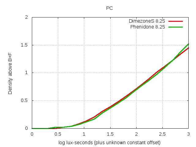

Remember that experiment last week that seemed to show that Phenidone is more active at low pH than DimezoneS?
Well, I re-ran it, but changed the pH to 8.25 for both tests. Here's the one-litre formula:
Potassium sulfite 45% solution ..... 126 g
Sodium metaborate 4 mol ............. 3.4 g (was 1.93 g for pH=8.00)
Ascorbic Acid ................................. 5.5 g
Phenidone / Dimezone S .............. 0.05 g / 0.10 g
pH=8.25, TMY2: 10.5 minutes at 20C.
Here are the same curves for pH=8.00 on the left, and the new curves for pH=8.25 on the right:
The new curves (at pH 8.25) are almost identical.
However, the Dimezone/Phenidone ratio is 2.0 for all these. In other PC developers I've seen, Phenidone is typically 0.15 g/L whereas Dimezone S is typically 0.20 g/L. That's a ratio of 1.33, which is well below my 2.0.

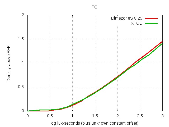

Finally, XTOL uses Dimezone S at pH=8.25, so here's a comparison:
These are almost identical, giving me some confidence that the high ratio above isn't due to my own screw-up involving Dimezone S.
Now what do I do? I think I'll go back to creating a concentrate that gives XTOL-like quality...
