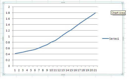

I made an H&D curve.
I bought a densitometer, thanks to Greg Davis who advertized it on apug's classifieds. And I got a 21-step Stouffer wedge. Put those two together, and you can make H&D curves. Here's my first:
This is taken from the roll developed in the prior posting.
Notice that it's upswept. The film was underdeveloped some, which might be responsible for the long toe.
But I'm still proud of my H&D curve. The X-axis is simply the step-number, but that can be converted to the proper lux-seconds.
BTW, H&D stands for Hurter-Driffield, its inventors. But I like to think it stands for Helios-Density, where Helios is the Greek sun-god, representing illumination on the X-axis, and where Density is the Y-axis.

That is not a classic upswept curve. It s a normal curve, but underexposed or underdeveloped by about one or two stops. My guess would be underexposure at this time. So, we are just looking at toe, no mid range or shoulder.
Ron, the left end of the toe in that chart has positive slope (not flat), which tells me that I overexposed a little. Kodak's curves start flat. That leaves the option of underdevelopment, and given that the leader's density was only 2.7, I believe it. BTW, what density should a typical leader be?

The maximum density of any film is based on design. Most films try to achieve a Dmax of 3.0 or thereabouts and a Dmin of 0.1 or thereabouts. Overexposure of a piece of leader can actually reduce the maximum achievable density in some films due to "solarization" from the extreme overexposure they sometimes get.
I revise what I said. The film is probably both underexposed and underdeveloped. Try to get a contrast in the mid tones of about 0.6 - 0.8.
Use of less AA will make the problem worse, not better. The solution is to increase PD.
