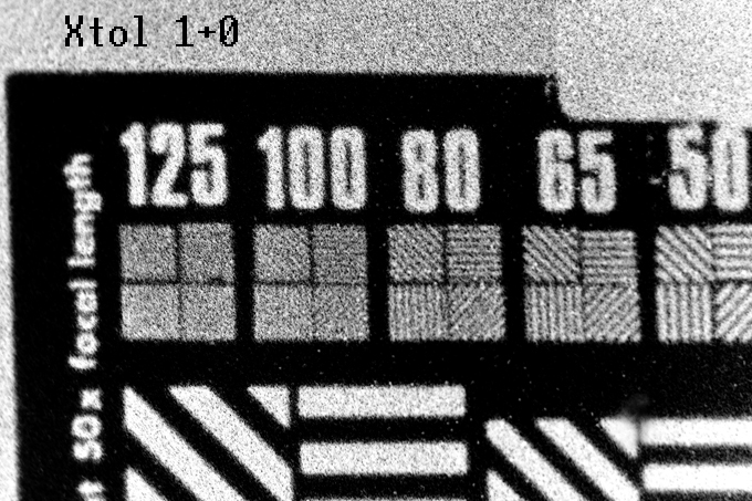

You're making me wish I had a good 250X-1000X microscope. With that, I could simply take a digital picture of the grain and run it thru some software to score the graininess. That would be a good way of changing a subjective judgement into objective, and would probably give granularity measurements comparable to Kodak's setup.
Mark Overton
How to measure small differences in granularity comes up here from time to time, sometimes it is suggested to make silver gelatin prints and report conclusions.Another method would be to make photomicrographs,I made the attached from T-max 100 using an old inexpensive microscope but have never tried this for comparing granularity.
At a guess small differences might be more visible using a more grainy film like Foma 400 but I don't recall any comment on this either.
A good method used in industry is to copy what the best Americans did which in this case would be Kodak pH 8.2.

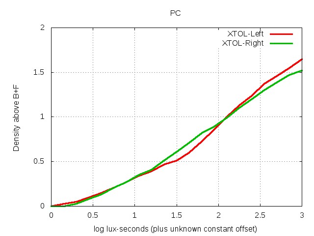

Although I've been posting little, I'm still doing experiments and dialing-in the numbers on a concentrate that gives XTOL-like quality. Speaking of XTOL, the graph below is two identically exposed successive frames on the same strip, developed at the same time in XTOL. These were TMY2 for 6.5 minutes at 20C, with temperature held constant by keeping the tank in a water-bath:
I expected these curves to be nearly identical. Any idea why they diverge so much? Perhaps due to differences in fluid-flow in different parts of the tank?
The shutterspeed should be consistent, as I measured it on both sides of the film-plane with my shutterspeed tester. The OM-1 consistently got 16.6 ms for 1/60th on both sides. So I doubt the differences are due to exposure. Fluid-flow is all I can think of, unless somebody has a better idea.

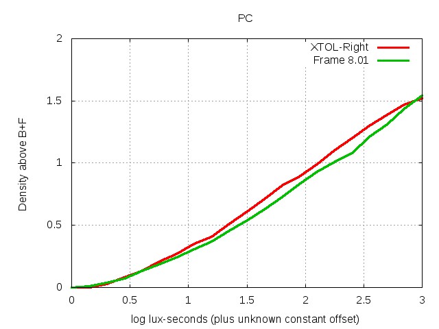

Anyway, the graph below shows the straighter XTOL curve from above, with my developer (in green). I'd say I need a bit more density, except the curves converge at the right. Odd.
The one-litre formula for the green curve is:
Sodium sulfite ......................... 90 g
Ascorbic acid .......................... 9 g
Sodium metaborate 4 mol ...... 6.2 g
Dimezone S ............................ 0.2 g
Target pH is 8.3 (same as XTOL).
Use same times as XTOL.
Grain looks identical to XTOL in my 22x loupes. Except for the sulfite, this formula can be dissolved into 24 ml of propylene glycol, yielding a concentrate that can be used at 1+29 dilution. I'm still tweaking this formula. By the way, I found that Phenidone can be substituted at half the weight of Dimezone S, so the above formula would use 0.1 g of Phenidone.

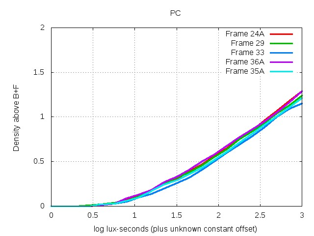

Michael, this makes me ask, "Then why am I trying to imitate the stuff?" Your posting also made me wonder about the choppiness of my developer, so I plotted the last few frames of the prior test-roll. I was tweaking the formula, so density varies some frame-to-frame. Here are five frames:
My developer has little choppiness; certainly less than what I saw with XTOL. The linear areas are reasonably straight. I don't know why choppiness would differ, unless it's because I'm using ascorbic acid instead of ascorbate, and over 50% more borates than XTOL, and thus I probably have better buffering.
Mark Overton
