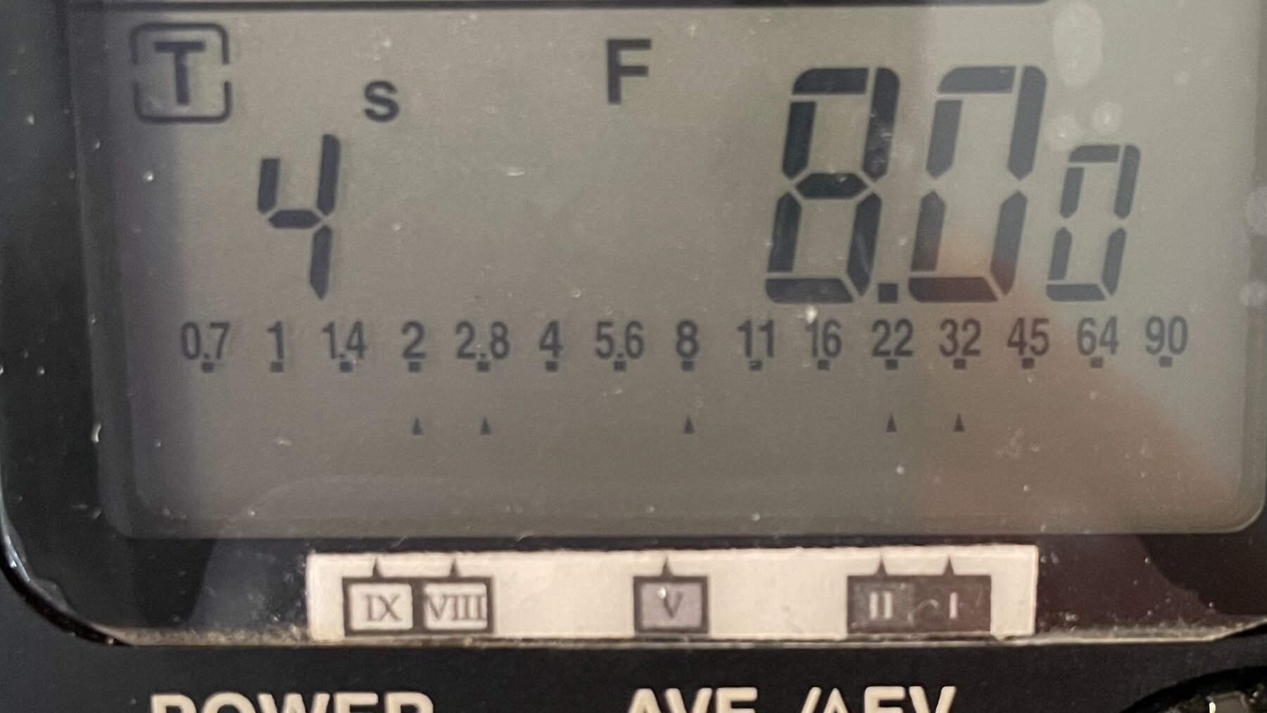

I adjusted the L-758DR to fall on Zone I, Zone II, Zone V, Zone VIII and Zone IX
Because Zone System always was a set of clipping points.
That label must be so tiny given we are looking at a greatly enlarged view of the L758D screen! I would not be able to decipher that (or the clipping points etc.) without my spectacackles — even then when they're not wet, fogged up or a "pedestrian" is wandering across the lenses (a fly, bug, a spider, a leech...).
It is tiny but is just mnemonic reminder Zone I is on the right, and Zone IX is on the left because that’s counterintuitive. In practice Zone V is the reading and you count up or down on the f/stops scale
