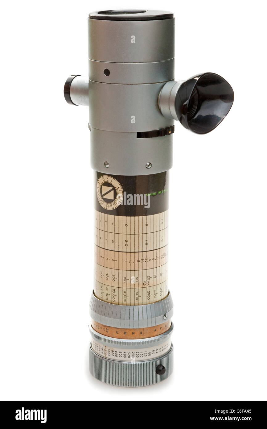

I'm going old school. S.E.I. 1/2 degree spot photometer
  • vintage-sei-salford-electrical-instruments-exposure-photometer-a-very-C6FA45.jpg
