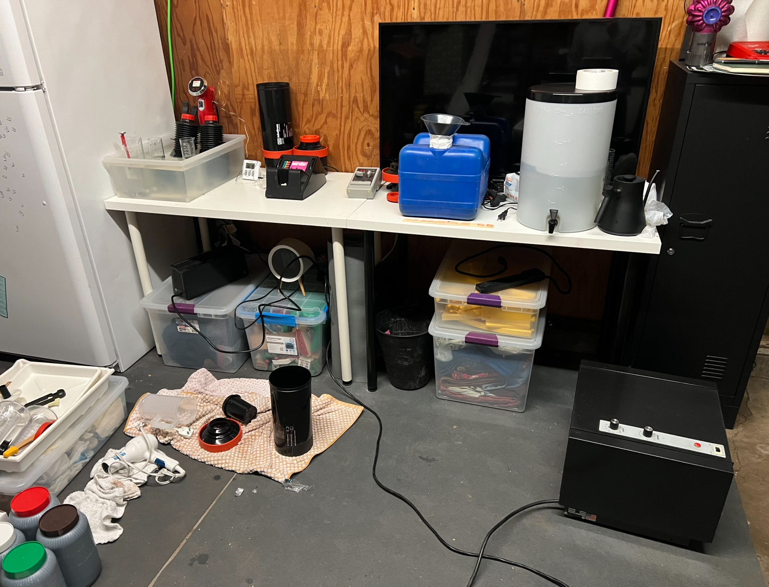

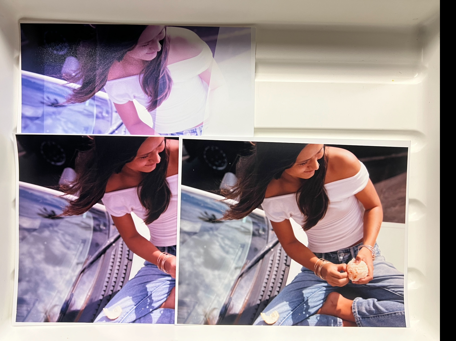

Thanks everyone for all your help. I just completed my first trial run print. On the 3rd and last print I timed it to be 8 minutes from dry to dry. I did a 30 sec pre wash, 45 dev, 45 blix and 3 in drum washes. Temps at 95 degrees Fahrenheit.
I noticed that drying to drum is pretty quick, it’s the lid system that takes some time. So I think I have enough drums for now and it I can stock up on lids that’d keep me pumping through prints without needing to stop. I can pretty much wash and towel dry a drum in the time it takes to run through the print dryer. If I can automate the washes I’d really have a lot of time.

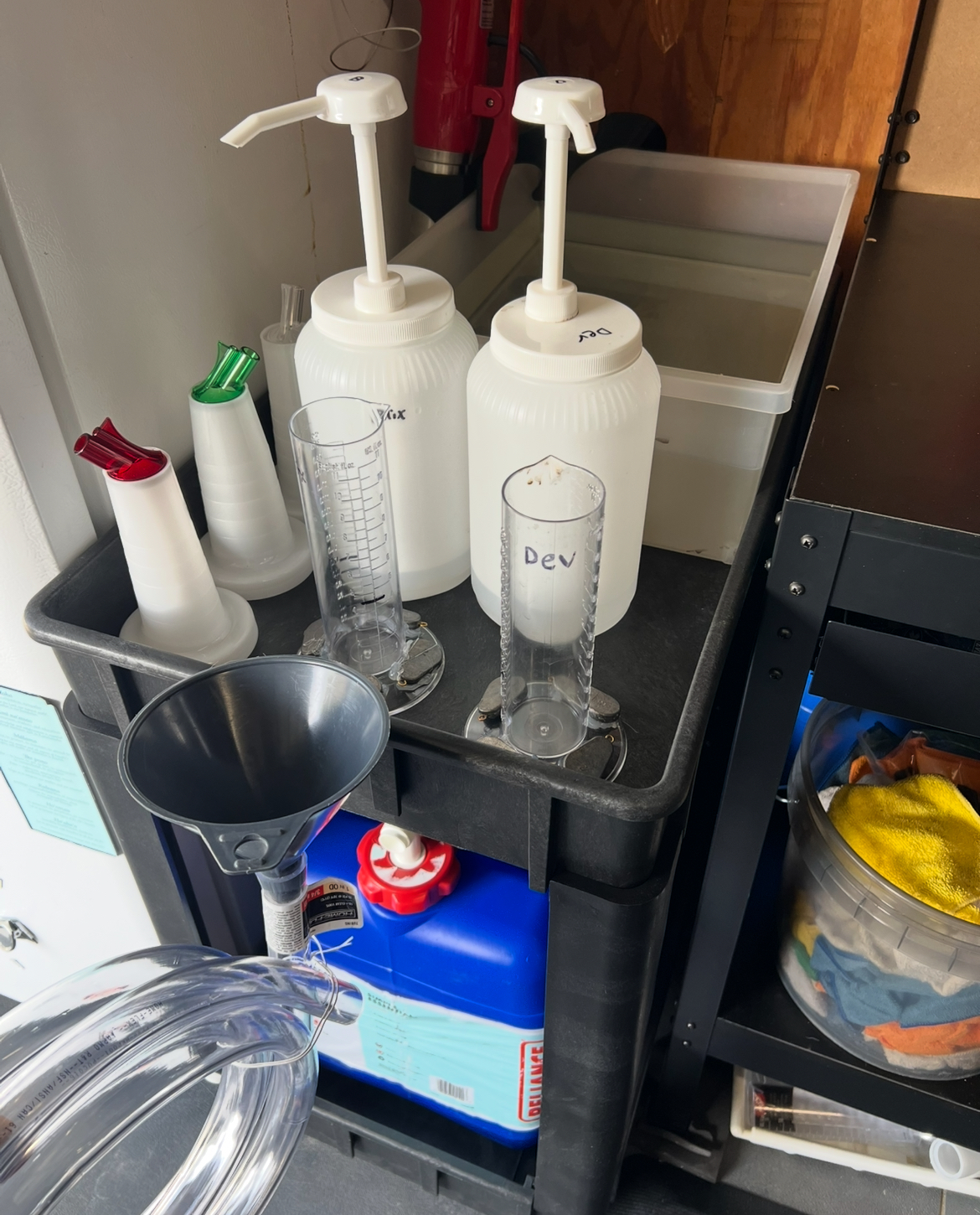

Couple things I need to improve is building a system for my main dev and blix bottles to be on a hand pump dispenser. That way I can pump out the needed amounts into my beakers instead of unlatching the accordion drum and pouring from that bottle. I easy hand pump to dispense warm chemicals would be awesome and shave off a good amount of time.

Also if anyone is wondering I did these 10x12 DPII prints inside of a 2830 drum which they say is good for up to 9.5x12

I also just ordered 2 of these bottles with pump. My idea is for this to sit in my water bath with chemicals and I can pump dispense the ml amount into my beaker for the next print. Any reason why these wouldn’t work out for that or anything to look out for?
I am (25 cm or 9.85"). The paper goes a tiny little bit above the drum body, but it is possible to close it with the lid without causing any damage.
Yeah it was never an issue and had now issues developing edge to edge. Some prints did get a tiny bit smashed but it was very minimal and could be smoothed out

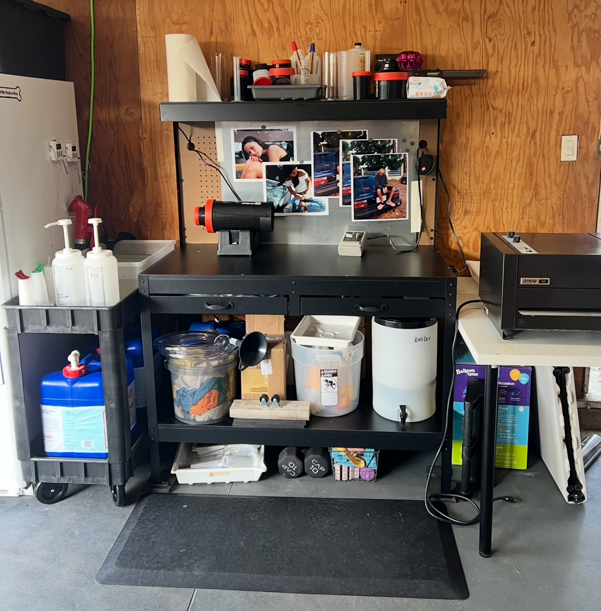

I’m nearing the finish line on this darkroom. Got a harbor freight work bench and a rolling cart which is holding my water bath and waste tank and fresh water tank below. I’m currently operating with no running water so I basically fill up the jug with the hottest tap water and then dispense from there during printing for pre wet and washes inside the drum. I also got these smaller jugs with pump dispensers that will hold my chemicals and then I can just pump to re fill the beakers for the next print, instead of opening and pouring out the chemicals. Saves a good amount of time!
Next phase is to source/build a disposal sink which I’ll either attach to the desk or to the water bath cart and run a hose to the waste tank. I’m gonna have a separate waste tank for chemicals and the 1st wash, and a 2nd for water only from pre wet and for the 2nd and 3rd wash. This way the wash disposal tank I can pour down the drain and the chemical waste tank I can save until I drop off at a disposal site.
