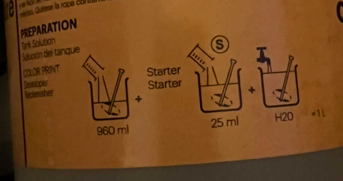

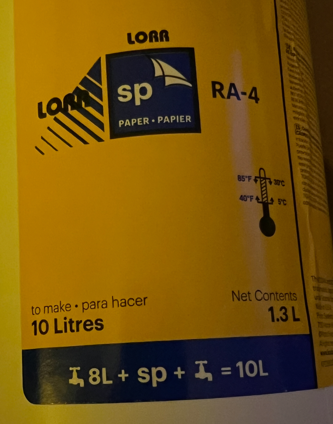

I'm having a bit of trouble understanding for certain some parts of RA4 chemistry and I'm hoping some of you could give me some clarity on some questions. Doesn't seem like there are much super clear "instructions" out there.
I ended up ordering Kodak Color Print SP (single part) Developer Replenisher, SP Developer Starter, and SP Bleach Fix Replenisher.
There doesn't seem to be a clear explanation on the difference between single part and the "regular" chemicals where you mix parts A, B and C. From what I could find they are essentially the same but the SP just comes pre mixed. How are these different (aside from the mixing/pre mixed), are there any quality, lifetime or usage differences between them? I went with Single Part since it seemed better for someone working as a home printer (working with drums) and simplicity seemed like the best route for me right now.
I originally had some confusion on developer replenisher and developer starter but have figured out that they are both needed to make a batch of chemicals to develop prints with (along with water). Speaking of water when I mix my chemicals can I use tap water or do I need to use distilled water? I feel like I've seen comments from people online that have said that starter isn't needed when processing in drums. Can anyone clear up these chemicals?
Mixing a batch of chemicals
On the bottle of the developer replenisher the little instructions they give you at the bottom goes like this, Icon of a spigot with 8L next to it + sp + spigot icon = 10L. I'm assuming the spigot means water and sp is referencing the bottle of developer replenisher which is 1.3 L in volume. So would this mean I'm taking 8 liters of water, adding the entire 1.3 L bottle of replenisher and then adding an additional 0.7 liters of water to get to the final 10 liters? Why wouldn't they just say mix 8.7 liters of water and this entire 1.3 liter bottle of chemicals? Do you need to mix everything in these steps and adding the final 0.7 L of water at the very end? Or does the second spigot represent something else?
On the Developer Starter bottle it looks like it gives you instructions for mixing 1 L of chemicals. The first part says developer replenisher 960 ml. I'm assuming this is 960ml of the replenisher that has already been mixed with water (and whatever else). Then says + starter starter 25ml and then H20 without a measurement. So am I just adding 15 ml of water during this process?
Since I only need 25 ml of starter to mix 1 L of developing chemicals how long is this bottle of starter good for after I open it? I do a decent amount of printing but still think it would take me a while to go through a 1 L bottle of starter at this rate. Also topping off with 15ml of water seems silly but who am I to argue science.
I have the same longevity question for the mixed replenisher. 1 bottle will mix 10 L. If I'm busy with projects this could take me about a month to go through (in drums). During slower times it could be a few months. How long is this good for once it's mixed?
I'm just about ready to go for my first trial run. Just waiting on a few last items to arrive so I'm excited to get my darkroom rolling after building and buying all the stuff I need. I'm in the process of building out the ultimate drum processing darkroom in my garage. Multiple jobo tanks, Arkay print dryer, starting with a beseler drum roller (will upgrade to a jobo if needed but seems unnecessary). Excited to get everything rolling so thanks for your help in this process.
That really depends; there are no hard & fast rules. A single-part concentrate may have a shorter shelf life than a multi-part concentrate. But some single-part concentrates these are so good that they may even outperform the multi-part concentrates in this regard. Single part may be more voluminous (more water needed to make the concentrate), so it may end up taking a little more shelf space, but that's not really relevant for the end user most of the time.
Overall a single part is indeed easier/more straightforward to use.
Tap water is fine. Commercial developer & blix concentrates are specifically formulated to perform well with regular tap water.
This is incorrect and anyone who says this really is just plain wrong. To make a working strength developer using a developer replenisher concentrate, you also need a starter. However, there are also developers aimed at home users, like the ADOX RA4 chemistry, that make a working strength developer as-is; these are not intended (and cannot really be used) as a replenisher, so it's really a different product. If you have a developer replenisher, you also need to use the starter.
There is one way of getting out of using the starter, and that's by making a working strength replenisher, diluting it a bit and then seasoning it by running a lot of paper through it. However, it's very uneconomical and imprecise and I don't recommend this approach especially if you're going to use your developer one-shot, as I expect you're aiming for.
Icon of a spigot
That icon represents a regular tap as you'll find above your kitchen sink etc.; i.e. it signifies that regular tap water is fine to use here.
That's correct.
That will work too, but it's common/best practice in chemistry to mix a liquid initially to a lower volume than targeted and then topping up to the desired final volume. This is because it's easier /more reliable this way to get to *exactly* the required end volume. However, since the degree of exactness required here isn't so strict (deviating let's say up to 5% won't make much of a difference), your approach of 8.7 water + 1.3 replenisher concentrate will work fine, too.
Correct.
There is a final volume stated: 1l (=1000ml). So again, you take 960ml mixed replenisher, add 25ml of starter, then top up with water to make 1000ml.
Yes, and of course, the 15ml is such a small percentage of the 1000ml final volume that it's not very consequential.

Well you're asking a lot of questions here.
So yes the picture of a spigot (or sill cock?) Indicates good quality tap water. 1.3 liter bottle of SP is first diluted to a total volume of 10 liters. This is developer replenisher. To make working developer (referred to as "tank solution") you take specified amount of replenisher add specified amount of starter and dilute to 1 liter.
Once open the starter will last for years, just keep it at room temperature (70 F)
What needs to be kept in always full bottles is the replenisher and the tank solutions.
Back in the ancient times people used 1 gallon tanks with floating lids and print baskets.
Kodak print washing syphon is quite good for 1950's practice of washing several smaller prints (black and white) fiber base paper for extended periods think 30 to 90 minutes.
Just use a tray place your blixed print in the tray and wash with warm water for 1 to 2 minutes. Not longer.
