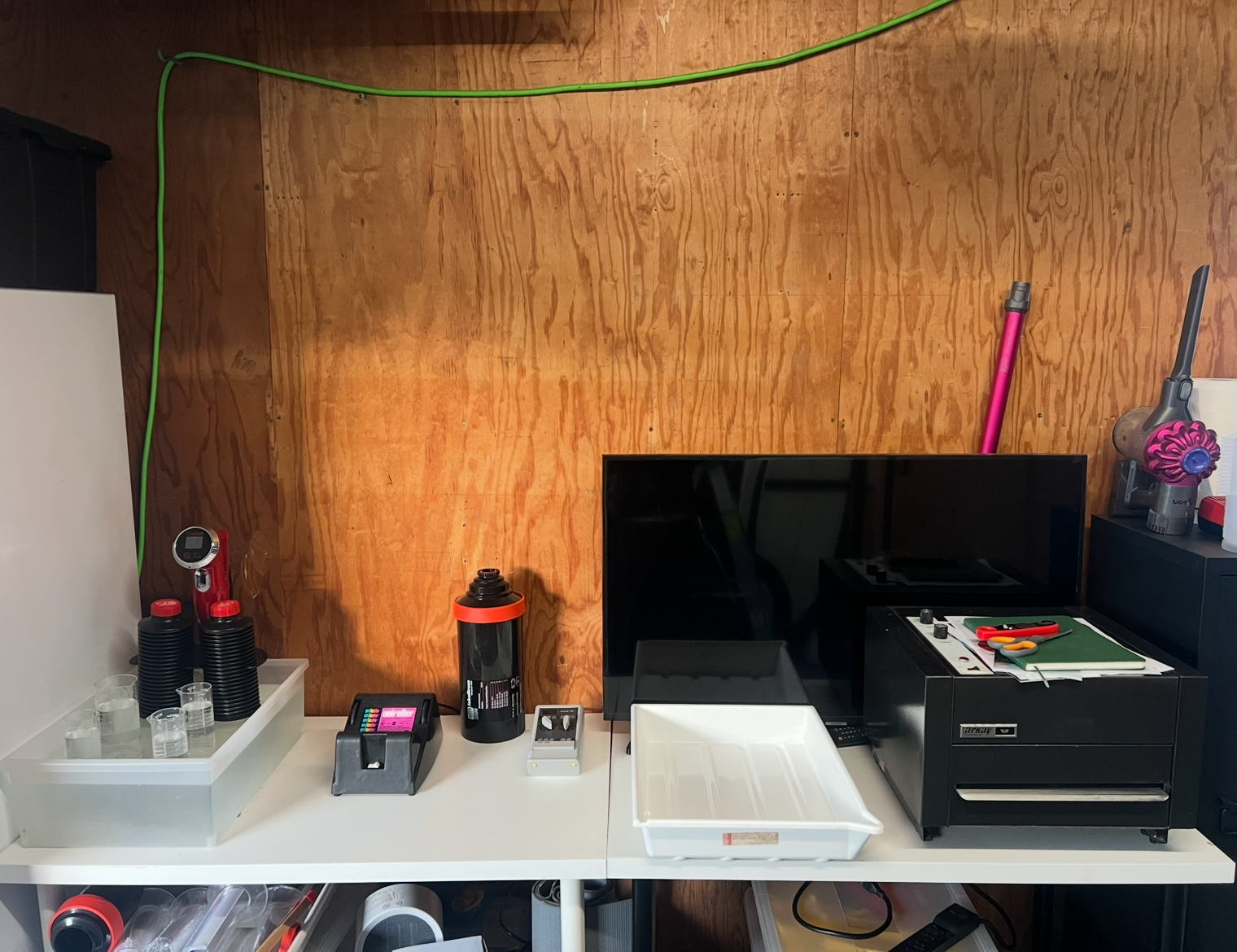

This is the work in progress darkroom. The wet/processing station is temporary right now. I would like to see if I could potentially fit that in that little nook area where the husky cabinet and c stands are currently stored. It might be possible but it’ll be tight. I need to fit a laundry sink and then table space for the water bath, the drum roller and a print washing tray. The Arkay print dryer I plan on building or buying a little rolling cart that can hold the dryer which I can then store somewhere and wheel it out for printing sessions. This may not be the right section of the forums but I did want to pick people brains on this layout and any ideas they had for making the space work when it comes time to finish phase 2 of my darkroom.

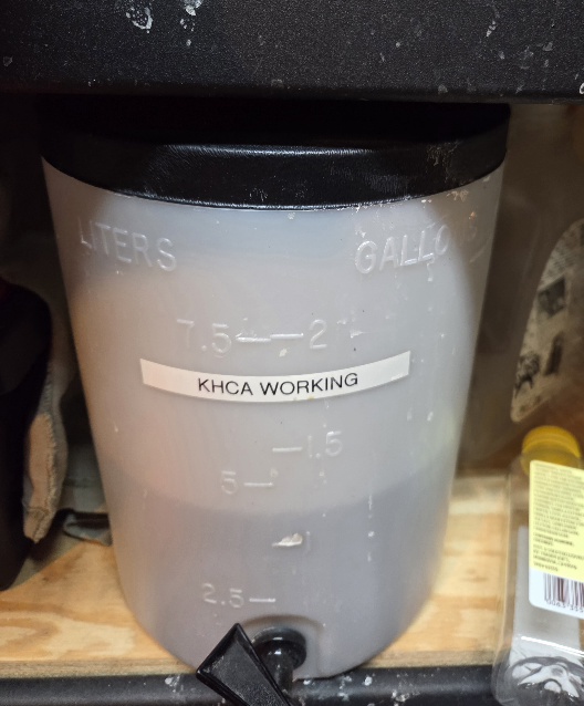

Here's my "2 gallon" Doran carboy. I think it would come very close to holding 10 liters. One other point is as you get down to the bottom you'll need to tilt the tank. I would estimate both the 5 gallon and the 2 gallon have about about 15mm below the bottom of the valve.

One other thing. Alkaline solutions can leak past the valves on carboys. Ask me how I know.
You'll notice that the picture I attached is a tank with WORKING strength hypo clearing agent, the Stock solution (1 part stock plus 4 parts water = working strength) leaks past the valve. Ask me how I know.
It doesn't take much, even 1/10th normal sodium hydroxide solution will weap past a Teflon stopcock (but it won't past Dow Corning silicone vacuum grease!)
I would suggest trial runs, or do what I did when I was 10 years old, summer vacation I decided to try and make some prints. I discovered that as I poured pure glacial acetic acid into an Ace hard rubber tray that it wasn't diluted (10cc/L) working stop bath. I got it back in the bottle, and the tray in the laundry tub.
