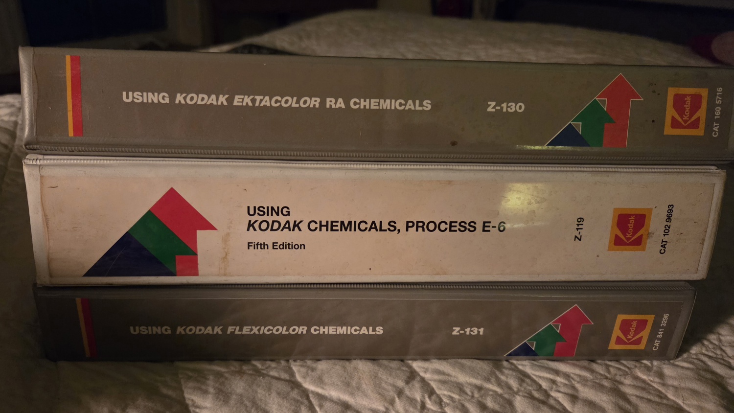

You need to print out the entire Z-130 manual for Ektacolor chemistry. Go to Kinkos or someone who can print out on both sides on heavy paper and put it in a binder.

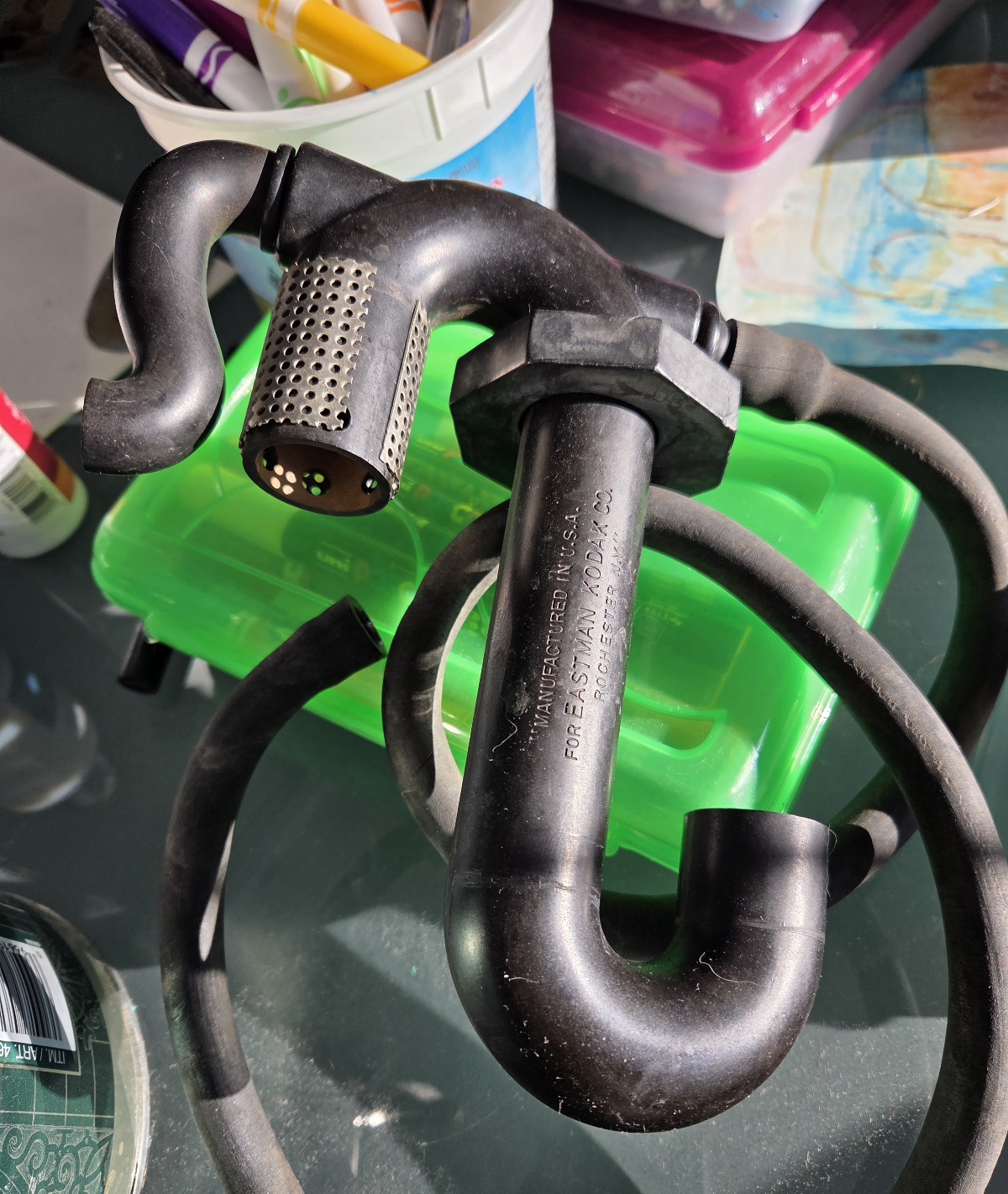

OG TRAY SIPHON MADE FOR KODAK.

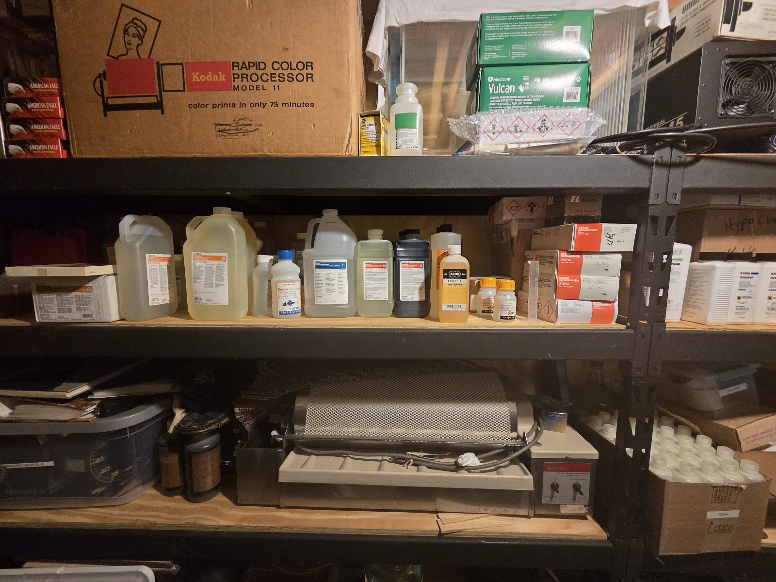

I haven't bought any color chemistry in the last 18 months. The stuff last received from Unique Photo was Fujifilm stuff made in Illinois by FujiHuht. Not sure if the global product move has changed this. So I will say sure it's coming from Belgium.

GO TO 125PX.COM AND DOWNLOAD THESE MANUALS. GET THEM PRINTED. I INHERITED THESE FROM MY FRIENDS WHO CLOSED SHOPS. BEAUTIFUL LITERATURE. 125PX.COM HAS FUJIFILM AND OTHER'S TECHNICAL INFORMATION AS WELL.
